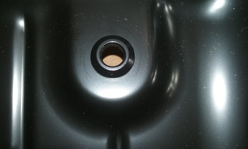

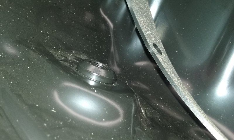

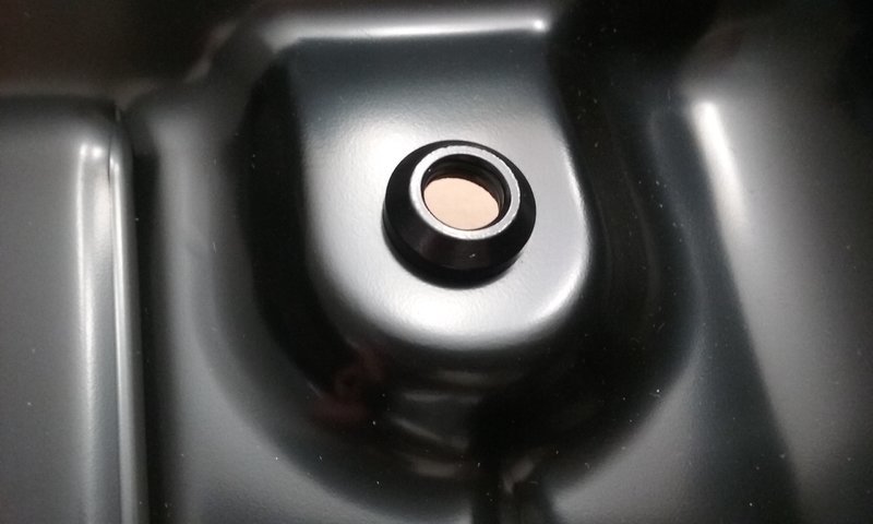

    Looks like a glued (?) round nut on the new pan. No wonder it spins but doesn't leak.
    Looks repairable, guess I'll have a spare pan.

    Is that not molded in? At least it looks like there is enough material to drill and tap to the next size.

    Here is a closeup
    tomwil likes this.
  11. Jun 8, 2016 at 6:40 PM
    2015WhiteOR
    2015WhiteOR Well-Known Member
    Feb 2, 2015
    #147773
    1,844
    Gainesville TX
    Thanks for posting up the good pics. I see what you mean now -- the extra torque just breaks it loose from the pan...
    Is the pan made of steel? It looks like you could weld a proper nut on there.

    Sure looks like steel. Maybe able to weld the round one back on if threads not damaged.
    Have to wonder why it has such a weak bond.
