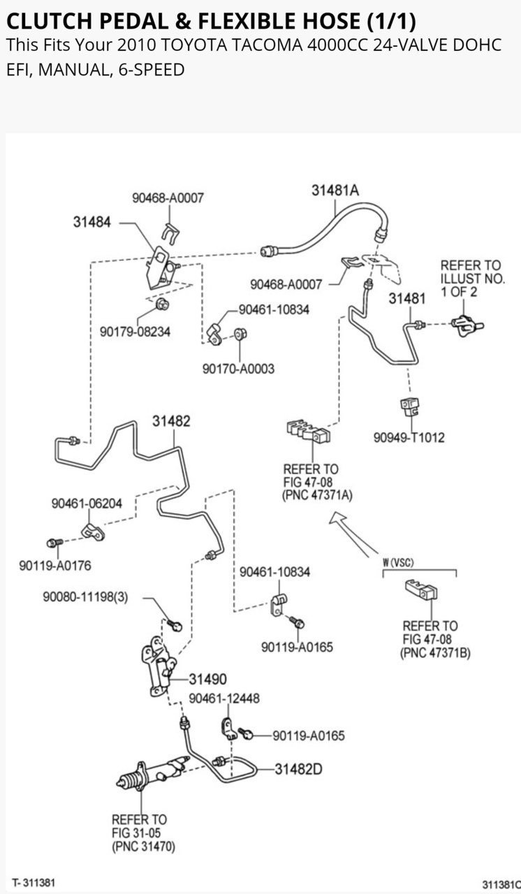

    ACCUMULATOR VALVE
    That's it's name.
    Right in the middle of this diagram, part 31490.

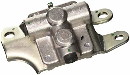

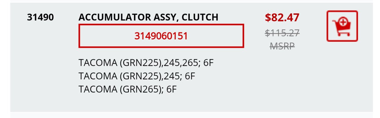

    The actual part number and price:
    The janky grabage you want to remove:

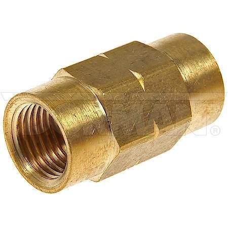

    What you want to replace it with:
    And a link to that coupler:
    https://shop.advanceautoparts.com/p...clsrc=aw.ds&dclid=CJSIqMybt90CFcsRhgodj5oMaw#

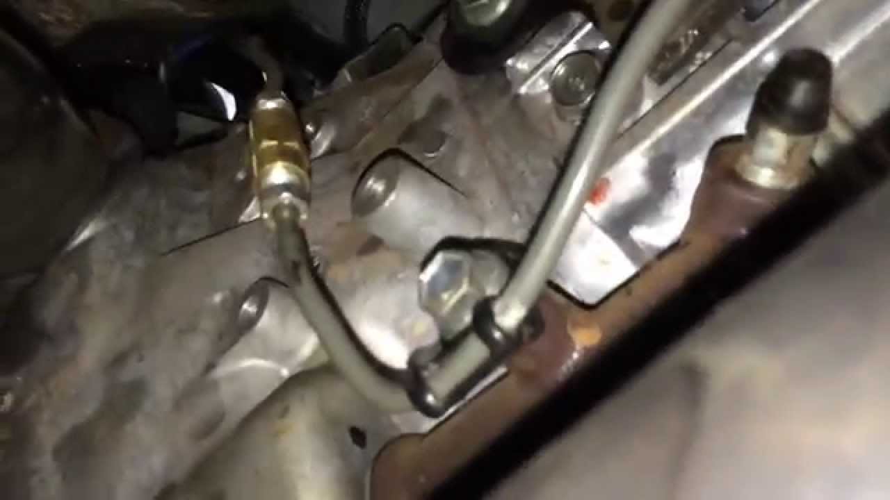

    What it looks like when you are done:

    It's also a million times easier to bleed the clutch without that stupid engineer's wet dream of a paperweight slapped to the side of your gear box.
    Inside it's pretty much just a stiff linear spring and a ball bearing which limits flow in one direction. (Engagement.)
