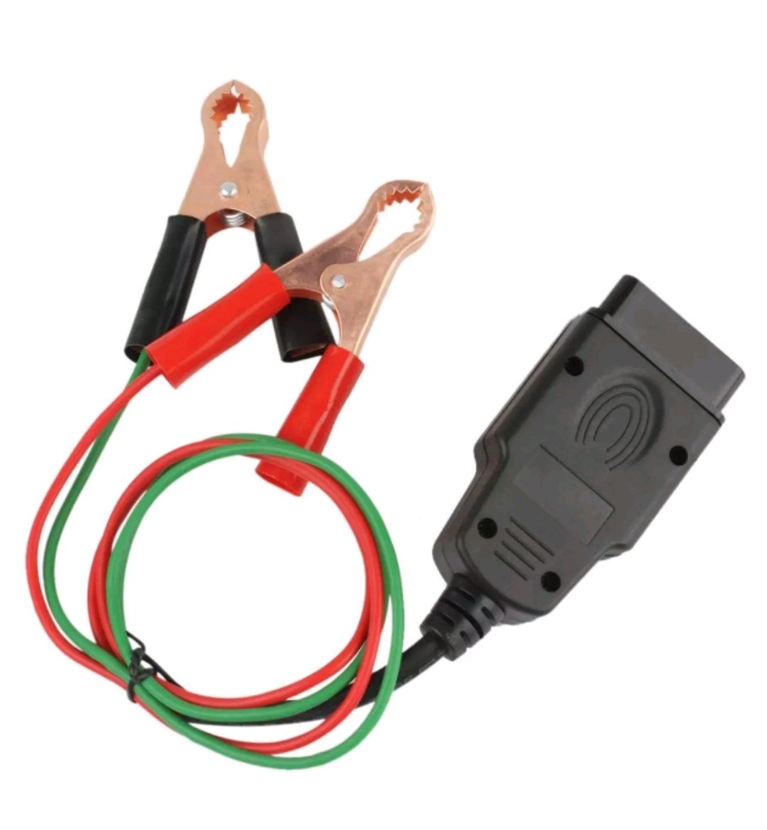

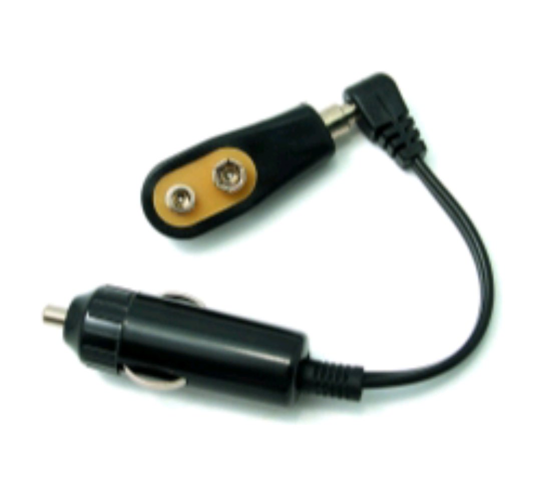

    Y'all should invest in one of these. These keeps the memory in the ECU intact while you disconnect the battery. The cig. lighter will need for you to switch to acc. to turn on the cig.lighter. The other if you have a spare battery handy. These are JUST to keep your memory. The OBD just gets signal from spare battery.
    The 9v is probably the SAFEST bet.
    You REALLY do not want to cross the pos/neg on the OBD.
