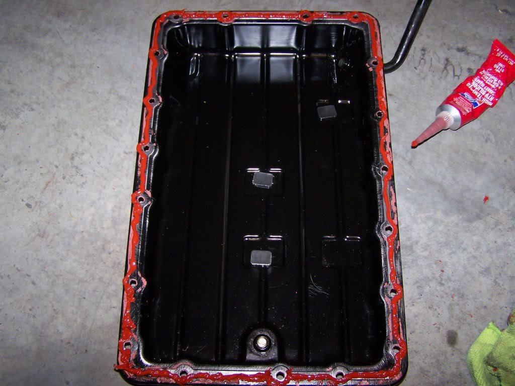

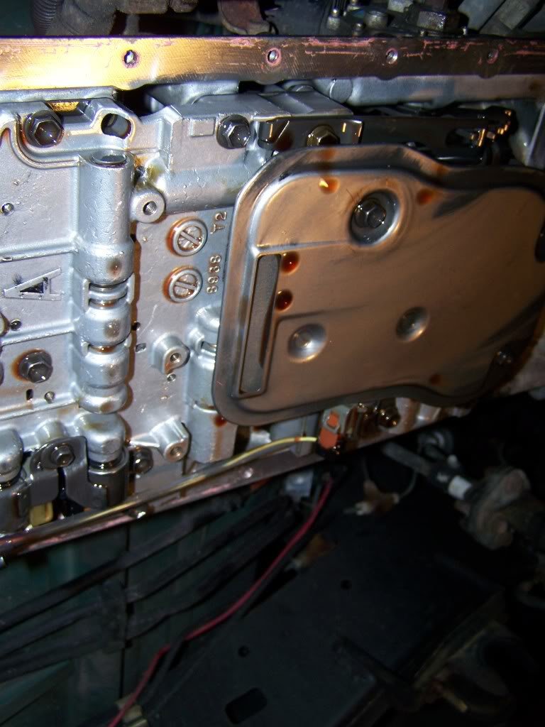

    alright, re drained the truck (dirty fluid as expected) i drove about 200 miles since the last one, dropped the pan, cleaned off the magnets, sprayed out the screen and put it back together and filled it up.

    Worked Great, shifts smooth and engages nicely! took some pics if anyone is interested.
    Drain fluid (14mm)
    unbolt dipstick (12mm)
    remove trans pan bolts (10mm)--need extension for bellhousing side
    remove pan
    remove gasket/sealant
    scrub pan out and clean magnets
    use brake cleaner and pressure clean the screen really well
    apply RTV to pan rim, barely snug bolts by hand, let rtv sit one hour then tighten down
    fill with fluid the next morning
    reinstall
  16. Sep 25, 2010 at 9:15 PM

    Shifts great at all temps now, engages D or R nice and smooth, extremely happy with the results
    The fluid levels were exactly where they should be, and it wasn't bright red by any means it was definitely time for a change, i should have done it already but it got left behind amidst deployment. The screen was just dirty and im sure could have been prevented with more frequent changes.
    The screen is the skinny rectangular section that looks like mesh
    This was after of course, i guess i forgot to take one of before, i used a wire wheel to get the old sealant off as best i could, despite being faded red in some spots its super smooth and in no danger of cracking and falling in the pan. There was no shavings or chunks of anything and i wanted to limit it to as little contamination as possible thats why i cleaned the pan so well, plus it was off so why not?
