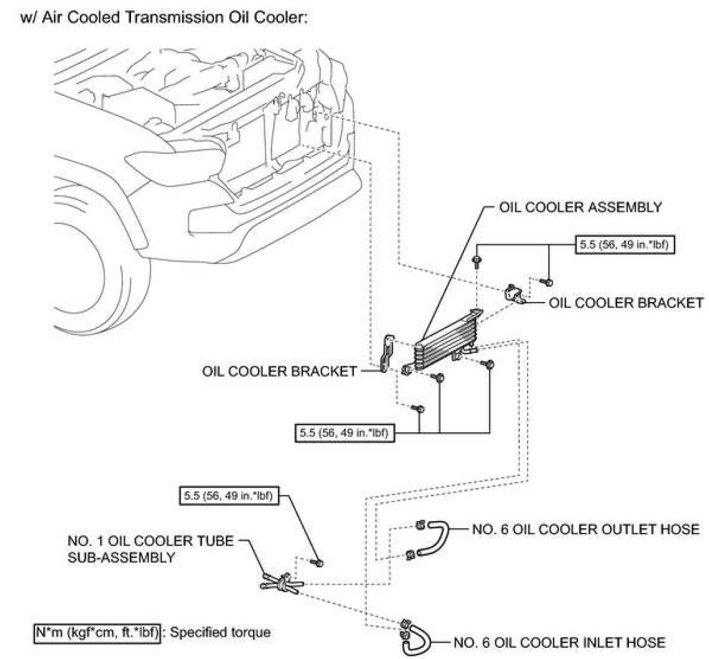

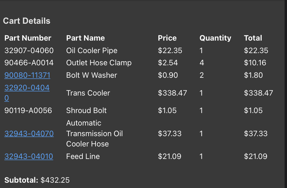

    Mid-2020 production year Toyota eliminated the aux trans cooler. Ask me how I know.
    Here's what you need to do the job:

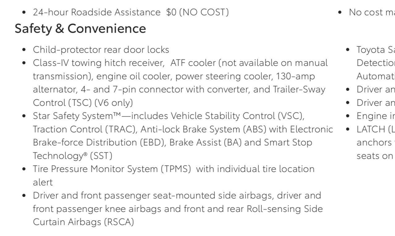

    I received this for my truck by email from my salesman. C587DB6A-2B26-482C-A42D-D18F97F282D0.jpg

    If your truck is the '22 in your profile, please ask salesman to locate coolers so you can photo and post photos.
    You may be able to have a grand time harassing him about misleading literature.

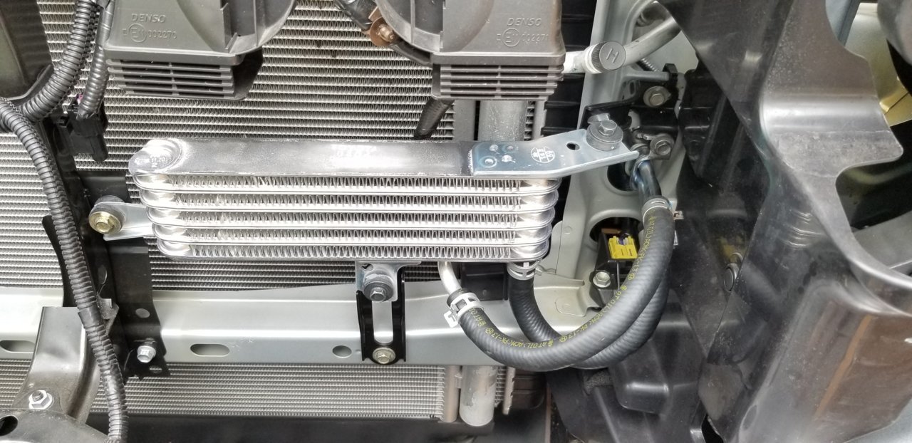

    Open the hood and look at the driver's side of the radiator. If you don't see this you don't have one

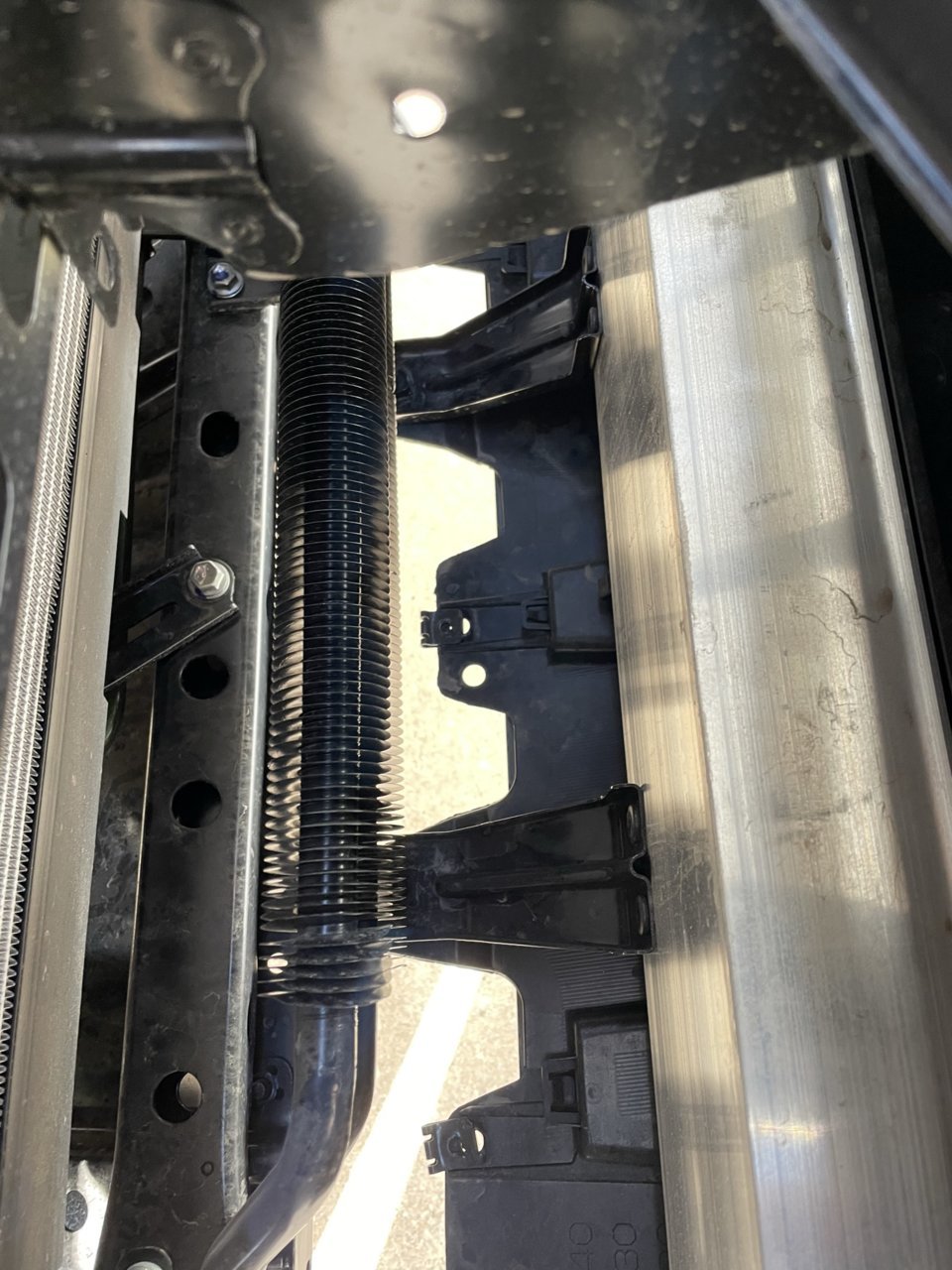

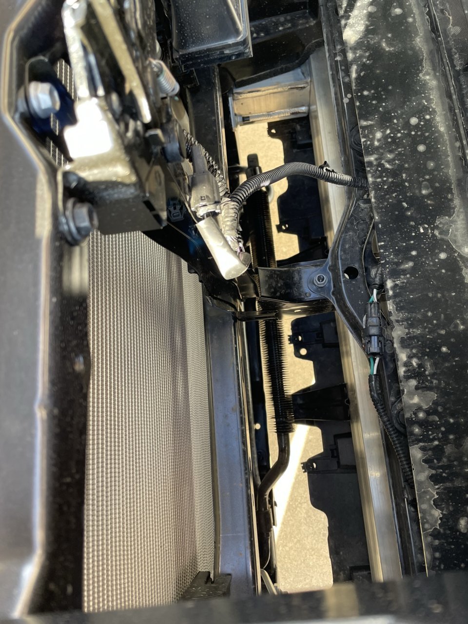

    The sheet I posted had my VIN on it, doesn’t that not mean anything? Lol, may not these days.
    Here’s a pic of my coolers. The black one towards the bottom does appear to be going towards the trans area. Could be wrong and didn’t trace it all the way down. May do it later to be sure though. A0E02308-B19D-4751-9978-14C4C4AC0B49.jpg5D76B4B3-403F-42C9-A571-FAC413AEB8E0.jpg
    Otherwise I do not have the nice looking one on my drivers side so appears I don’t have a trans cooler then. Is the black one for the power steering maybe?

    that black one is a power steering cooler

    If your vin is on that sheet maybe it is part of the package verify for sure. I’m making the salesman look bad and maybe he is not

    Great info. I was wondering if maybe they did something along those lines to allow the claim even though it may not be an external cooler.

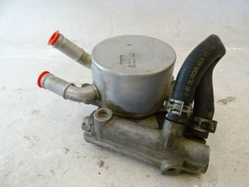

    They actually do still have a cooler, but it is a fluid heat exchanger, like the engine oil cooler. It is were the transmission thermostat mounts looks like this.
