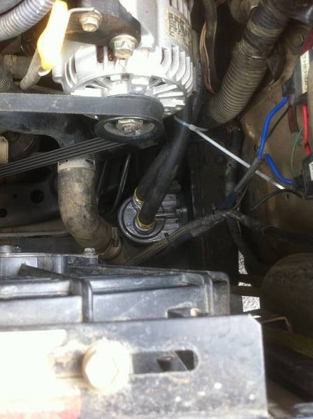

    @wesb1023 I know for AN hose fitting you need a special tool. And I know some rubber hoses have a crimp sleeve. But mine just had a slip on fitting and you should too.

    Thanks guys for the reply! I was thinking about mounting it to the inner frame rail and making a small metal shield for it but if thats to far for the stock pump ill have to consider another location.

    Here is where I mounted mine. I used the stock hole in the frame rail no need to use 3 holes.

    I like the cleaner look of the shorter hoses, I think I will have to make time to do this. What kind of electric fan is that? Thats another thing on my list.

    I got this dual fan and this thermal switch. Then I made my own relay setup If you want my relay setup let me know and ill try to draw it up some time..
