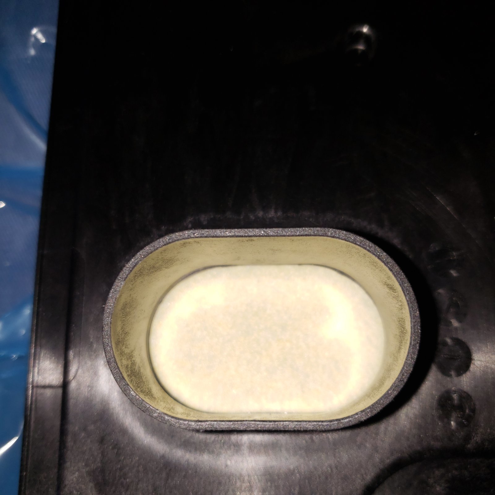

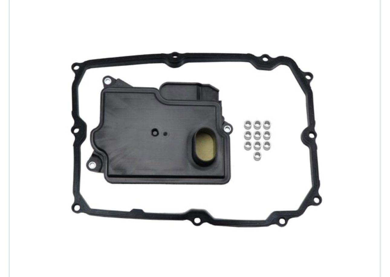

    There seems to be confusion on the 3.5 having a trans filter that is replaceable.

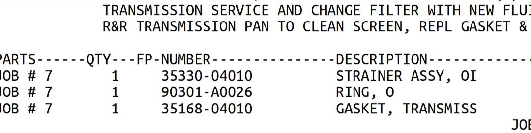

    I had mine serviced and captured the part numbers used to do the service.
    It shows a strainer as the replaceable component.
    Toolndie7, PTSDTherapy and CLVol1255 like this.

    Ignore what they call it. There is a fiber element in there

    Yes. It has a replaceable filter or strainer as they call it.
