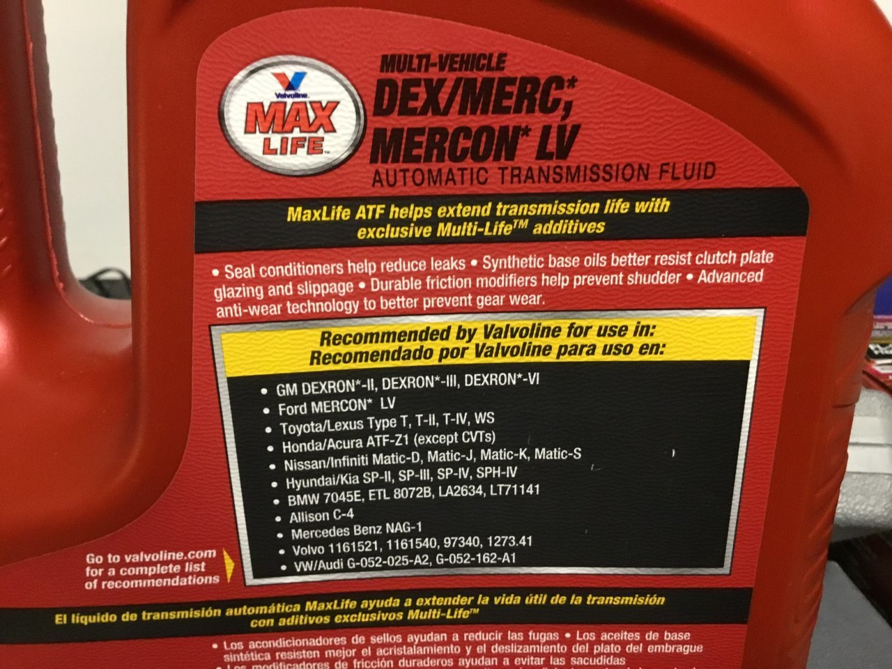

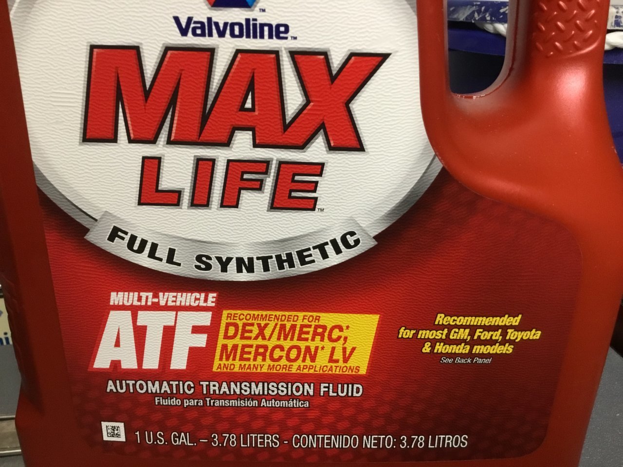

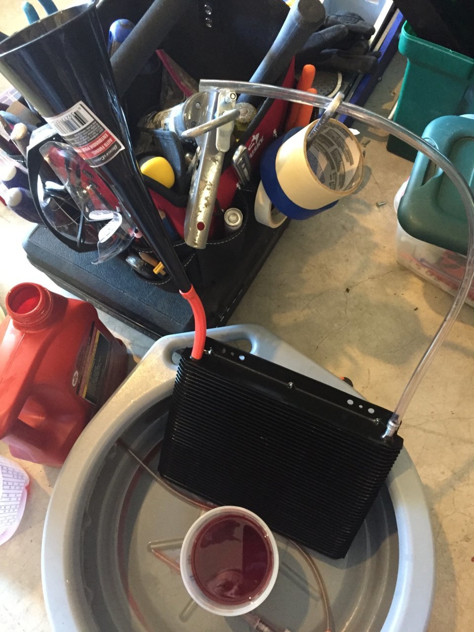

    Don’t open the drain plug and refill.
    First see if any comes out of the overflow when warmed up. If nothing comes out, you won’t know whether it’s filled correctly or under filled, so put a quart or more in it prior to checking the overflow and making sure it’s filled to capacity.
    This transmission needs to be overfilled first to check for correct fill level.
    After doing the overflow check, you can then do a proper drain and fill with the same amount of fluid that was removed from the drain plug.79A354A3-F802-4FC6-B121-568C4482DB79.jpg 88D28076-8824-42F4-AA04-7C35DDF37DD0.jpg 9094B230-1D72-491E-A1CD-FB5BA1861D86.jpg
