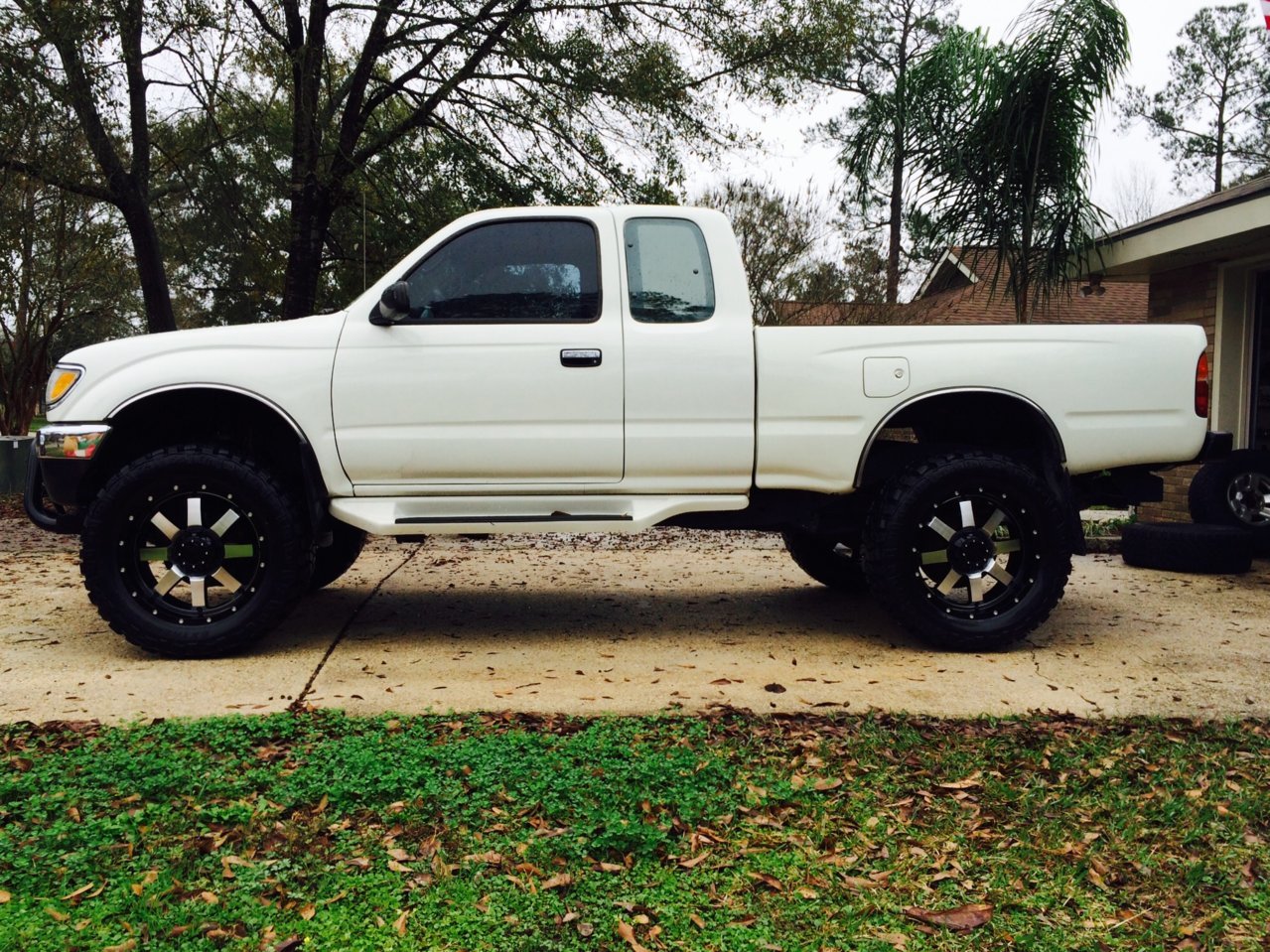

    I have a 97 Tacoma 4x4 w/ 180k.Recently started having issues w/ tranny.It will not shift past 3rd gear.I push in the O/D button and nothing happens.The indicator comes on the dash but it will not shift into higher gear.It isn't slipping between gears or at take off.It seems to be something electronic or maybe a solenoid in the trans.Any suggestions?????IMG_0065 (1).jpg
