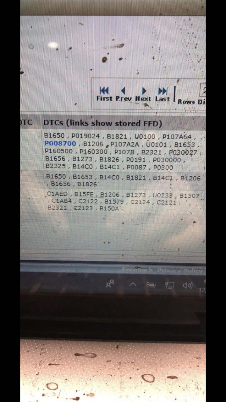

    UpdateDC4A8F44-BB8C-4F5C-8E8F-15F516DA4E60.jpg96E23044-0DBB-4911-B9D9-CB9604C70077.jpg
    So nothing was found and I have the truck back. We’ll see if it acts up again.

    Don't have access to the SM at work... could someone look those codes up?
