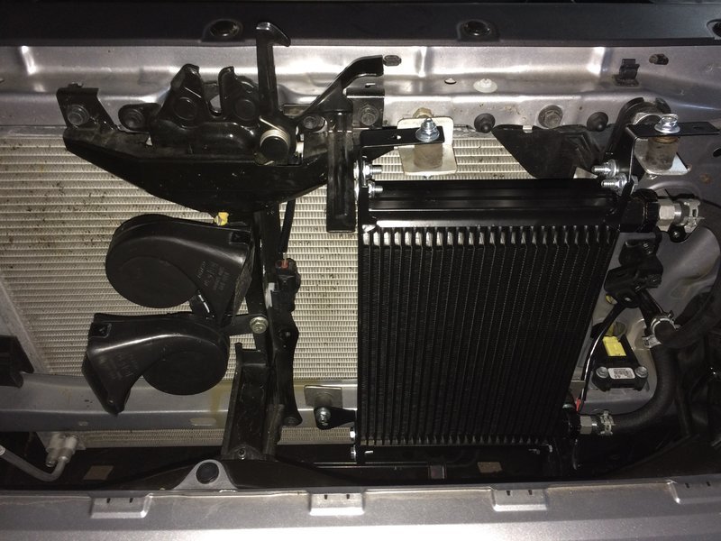

    I have a scan gauge that shows me the trans temp. I added a quart and then watched my temp get above 115 and unscrewed the 5mm plug. I removed the worthless trans cooler that came on it. I plugged the the hoses up and did not lose 1 drop. This is the most efficient cooler you can buy that will fit in the space you have.

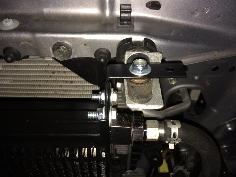

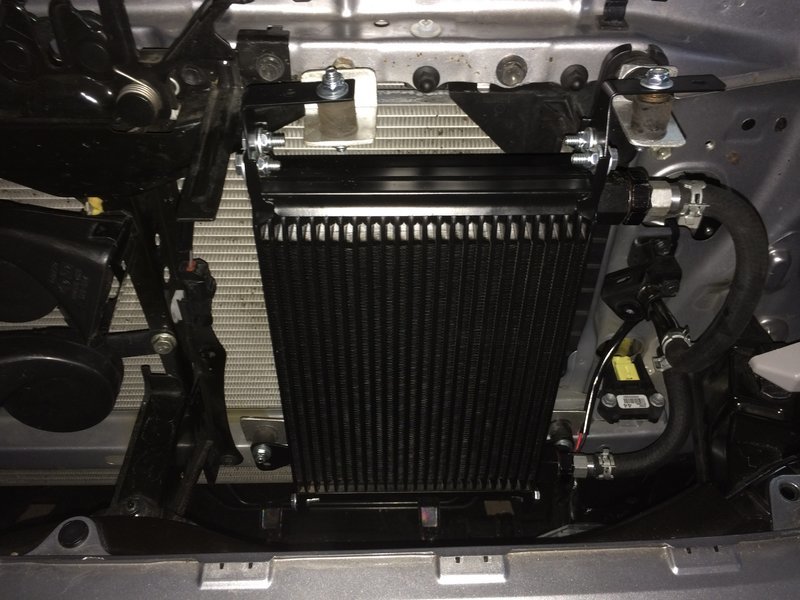

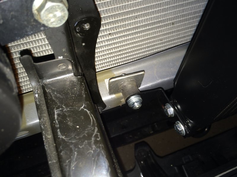

    No, you don't have to worry about air in the lines. You do have make sure the hose coming from the radiator goes in the bottom, so it fills the cooler, then runs out the top back to the transmission. You have to have this part
    http://www.amazon.com/Derale-98200-...&redirect=true&ref_=oh_aui_detailpage_o00_s00
    I took a piece of angle aluminum and cut 4 mounts and used Lord rubber mounts to eliminate vibration. If you tow a heavy load this is the best money you can spend on your truck along with a scan guage so you can monitor your trans temp. The scan guage can give you your pan temp and you torque converter temp. You have enough hose to hook in to the cooler but I bought some and cut it to the correct length. It has reduced my trans temp at least 30 to 40 degrees. I hooked a fan up to it but it made absolutely no difference so I removed it.
