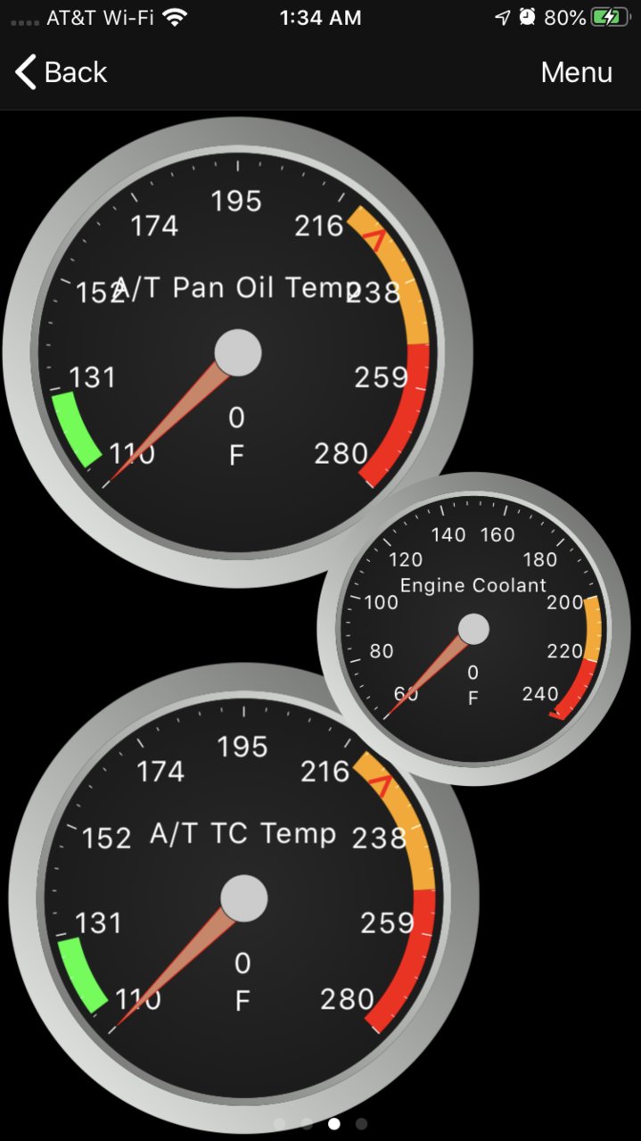

    Today I installed a B&M Supercooler and Derale external Trans filter. Install went kinda smoothly. Completed a trans drain and the fluid was pretty brown. I struggled to get the truck into TEMP CHECK MODE. I think I'm going to do the same as you guys and monitor trans temps with my app to make sure I'm in the 115-130 degree range.
    [​IMG][​IMG]
    One question though, I don't have a ScanGuage or UltraGuage, I'm using the OBD Fusion app through my iPhone and it shows two different trans temps. When driving they are off from each other about 10 degrees. Which one do you guys suppose measures pan temp? When driving uphill I see that A/T OIL TEMP 2 is always higher than A/T OIL TEMP 1.
    I modified both gauges to highlight when both are in the Green (115-130 Degrees)

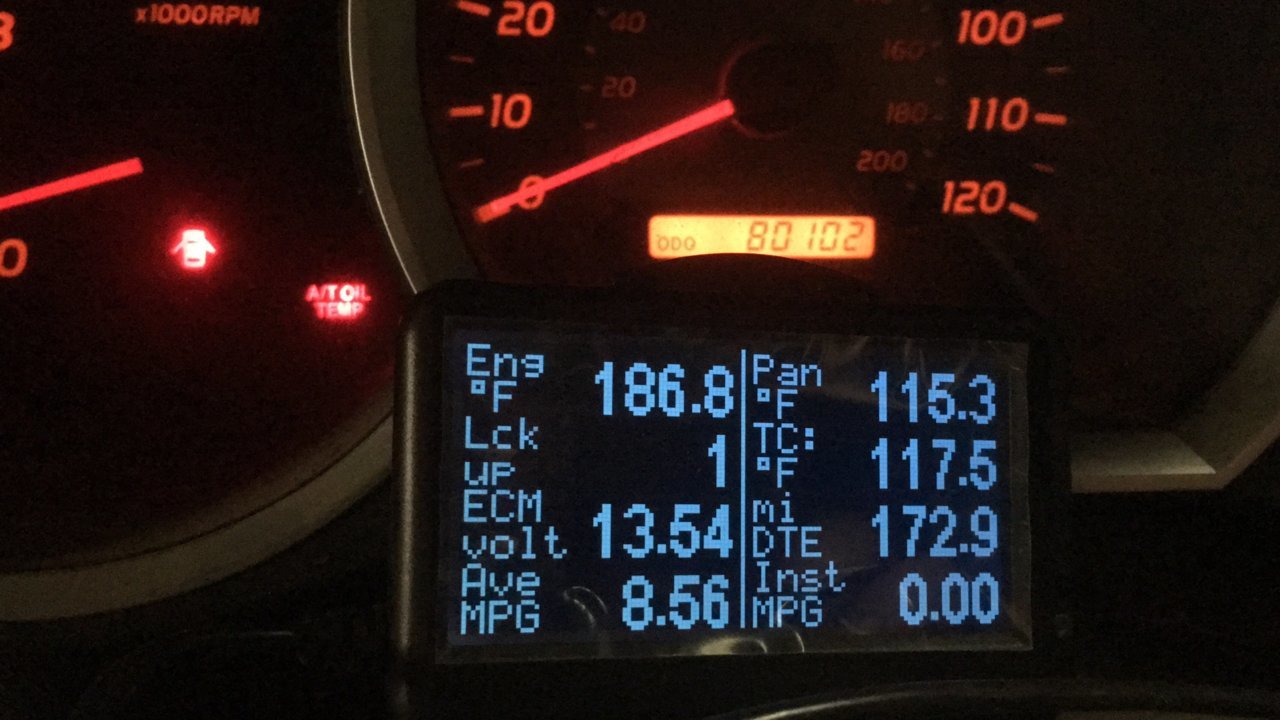

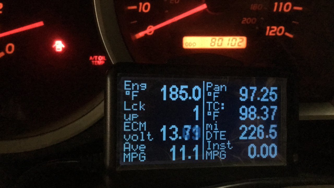

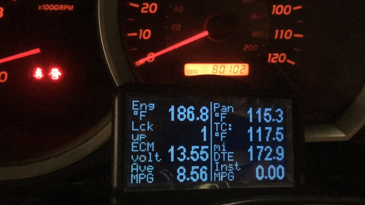

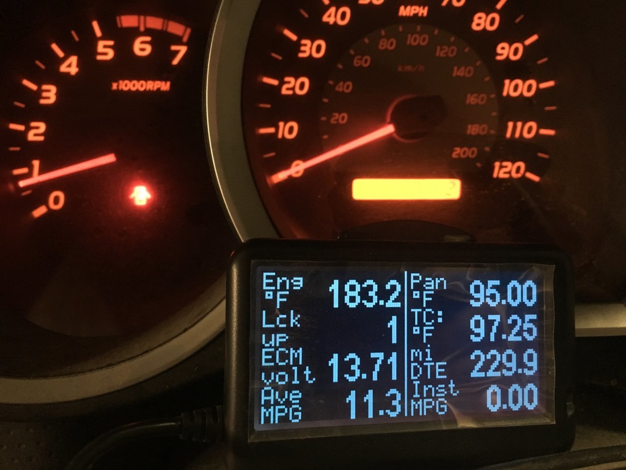

    The lower of the two (and most stable) will be the pan temp. My 2007 Tacoma used to check at 97-115°F in temp check mode. I once put the truck into temp check mode with the jumper wire and then unplugged the jumper wire and then reinstalled and verified the check temp range with my Ultragauge.
    As you can see, the temp light is not on at 95°, then comes on solid at 97° and remains solid until the temp reaches 115° at which point the temp light starts flashing to indicate that the temperature is out of range (too high).
    8372F48D-D2FC-4021-AD6A-B7F52151B723.jpgBA0CBA74-D0C8-4C19-A228-39E7CF4804C4.jpgF7CF6789-1D66-478D-A800-9908F77821FE.jpg9C8A3FD5-4D62-4560-9CC1-8D96DAE965AD.jpg

    m00seNUckLEz
    m00seNUckLEz tAc0 aFiCi0nAd0
    Dec 20, 2015
    #172698
    858
    Fresno, CA
    Under Construction
    OK, awesome. I'll change that bottom one to say A/T PAN TEMP. Thanks for that, that's exactly what I was wanting to know.

    When I said “lower” I meant temperature, I was not referring to your picture. AT temp 1 in your case would be the pan temperature and AT temp 2 would be the Torque Converter fluid temperature. Sorry for the confusion.

    #75
    m00seNUckLEz
    Dec 20, 2015
    #172698
    858
    Fresno, CA
    Under Construction
    Ah, ok. Thank you for clearing that up for me. Will Change those now. Thanks, man :cheers:

    m00seNUckLEz
    Dec 20, 2015
    #172698
    858
    Fresno, CA
    Under Construction
    There, fixed it so I now I know exactly what I'm looking at.
