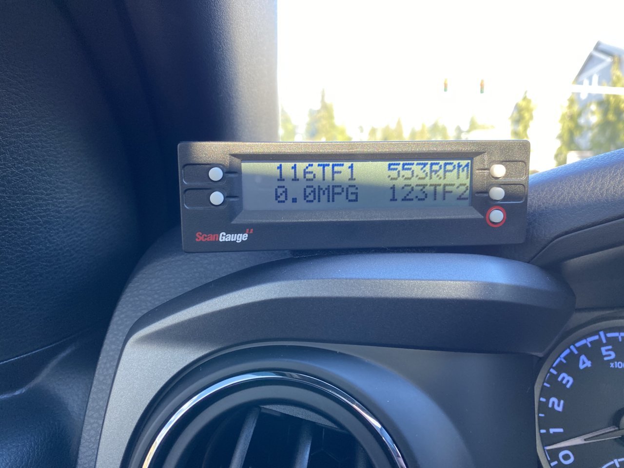

    I towed in S4 ect and towed great but I have a scan gauge 2 and my trans temp went up at times to as high as 222 and hovered around 190. when I’m not towing it’s at 184-199
    This seems high for a new truck and low miles! Is it? I’m wondering if anyone has had a cooling system put in to help? I got an appt with Toyota on Tuesday to check it all out but wanted some feedback first to see if I really need the apt.
    Thanks for the help and any info

    220 is hot but not scary, you’ll be fine.
    Is that TF1 or TF2? One is in the pan and is more steady, the other is at the torque converter and has spikes.

    Aww ok! It is TF2. It’s the only one I could get to read with codes.
    for it to be running 198 around town in non stop and go traffic seems odd!

    There are 2 temps- pan and torque converter.
    Torque Converter is usually goes up while idling In traffic and being in unlocked state.
    Also if you drive in s4(s3), there is a wide range of unlocking speeds and accelerator angles compare to 5th and 6th. That means that you most likely driving with the torque converter unlocked and producing the heat.

    May need to add pan temperature. The pan is attached to the cooler via the thermostat (if a tow package).
    Also , some folks would pin the thermostat to keep it open all the time or for the time of towing.

    Thank you for the tips! Now have both readings
