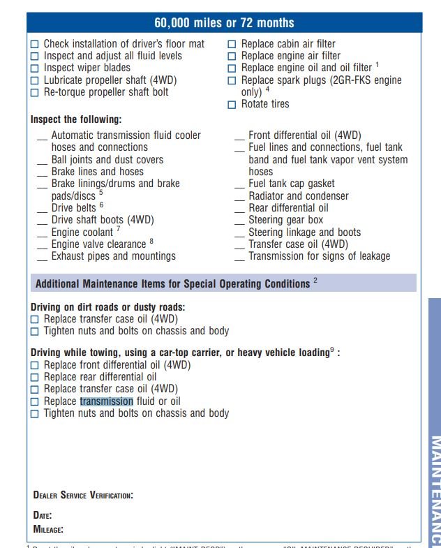

    Yes, definitely have the dealer check it. If it is low, they will top it off. A full tranny fluid flush will be out of pocket.
    FYI - Suggested flush is at 60k miles.
    EDIT: The suggested 60k miles is if you meet those listed conditions.

    Actually, looking at the maintenance schedule, I don't see it as a line item on the main check boxes.
    :notsure:
