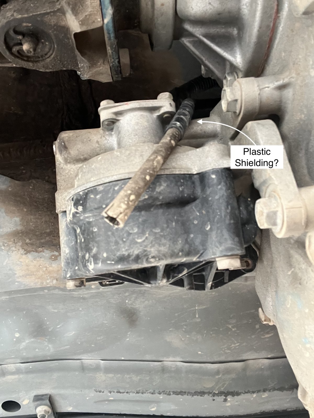

    I've got a 2005 TRD Off Road w/ 6 speed manual transmission. The transfer case actuator breather hose rotted out which led to water getting in and corroding the actuator contacts. I went ahead and replaced the actuator which was surprisingly easy, and now I need to replace this breather hose so it doesn't happen again, and I have a few questions.
    Thanks in advance!
    Hose:
    The current breather hose looks like rubber or silicon and has some kind of plastic wrap around it. I cut a piece off where it extends past the plastic wrap and got a few feet of similar sized generic vacuum hose from autozone. Just wondering if this standard vacuum line will work for this application. Looks like that plastic wrap might be a heat shielding, but I can't imaging the exterior of the transfer case get that hot.
    I can't seem to find any info about this hose.
    I believe this is the type I got, might be different diameter, just matched the piece I had.
    https://www.autozone.com/ignition-t...tal-5-32in-vacuum-hose-sold-per-foot/4942_0_0
    Any ideas if this will work? Should I add some kind of shielding?

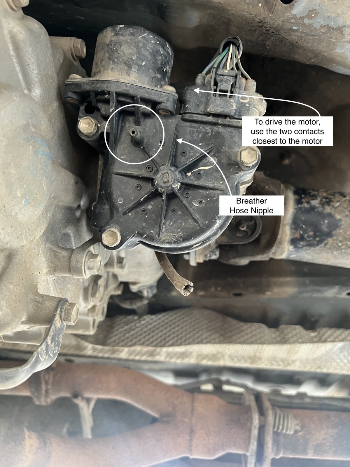

    Transfer Case Actuator Replacement and Timing Note
    Just a note about the timing:
    I reinstalled the actuator without opening the transfer case and was able to get the timing right on the first try!
    I got the vehicle into 2HI (had to turn the vehicle off and on to engage/disengage) before removing the actuator. The new actuator was set somewhere in the middle of the range around the 4HI area. To set the new actuator to 2HI I just connected the two contacts at the end of the plug to a drill battery to drive the motor (switched the +/- to reverse) until the shaft was fully extended and in 2HI position. It worked great and now I can get in and out of 4HI and 4LO.
    I saw a video where someone used a pry bar to push the shaft all the way into the transfer case to manually put it into 2HI. I think between that and running the motor to the fully extended position, it could be an easy way to get the actuator timing right.
    I have some pictures, so I might do a write up at some point on this process if it would be helpful for anyone.

    Standard vacuum line will work.
    Just keep an eye on it yearly. As the new hoses seem to dry out fast.

    I don't see why regular vacuum line wouldn't work, it just might not last as long as the OEM hose.

    i used vacuum line that i slid inside of some old fuel line sheathing to protect it.
    i zip tied some window screen material on the tip, to keep the effing wasps out of it.
    don't recall exactly where i ran it. i think up high under the hood because i have been known to ford 2+ ft of water.

    I used some vacuum line and some stainless steel tubing to splice a new piece on the end. I left about 5" extra so I could trim a little back every year and re-terminate it. A little super glue on the stainless tubing, inside the rubber tubing works well. I then did a little shrink wrap around the splice as well.
    I think 99% of the actuator failures are because of this hose splitting and falling off. They should be checked every few months and trimmed accordingly.

    I've replaced this before but already had some and didn't measure it; I'm going to guess it's 3mm, or 1/8". Hose like this is sold by the foot, so just get a foot at NAPA. The OE hose is barely long enough, so add a little extra. The coiled wrap is for abrasion resistance. You may be able to remove the old wrap and install it on the new hose. You don't need a clamp as there's no pressure on the hose- it's a vent. if it makes you feel better, you can install plastic zip ties.
