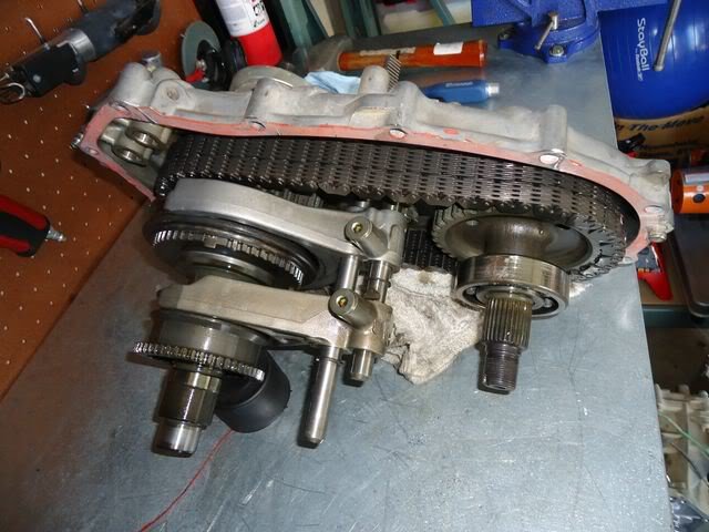

    That's a nice looking piece of engineering.
