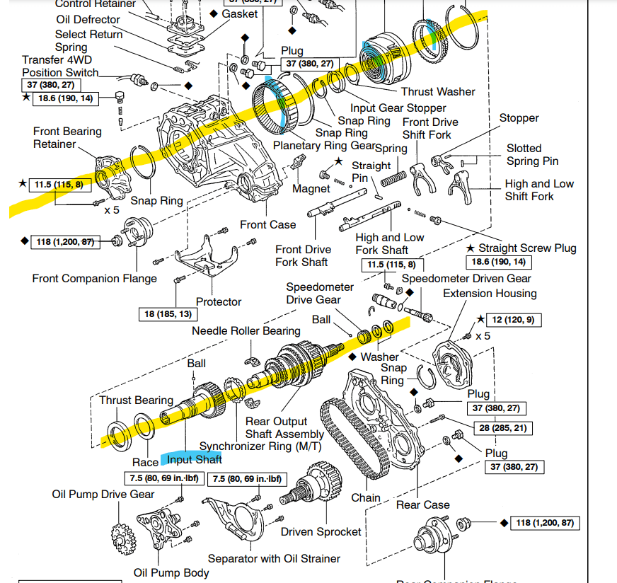

  14. May 16, 2023 at 8:08 AM

    I don't know. First thing I think of with a clunk on accel or decel is CB and/or drive shaft. I know you mentioned doing it recently but maybe check it again? Looking forward to replies from others to hear other feedback.
