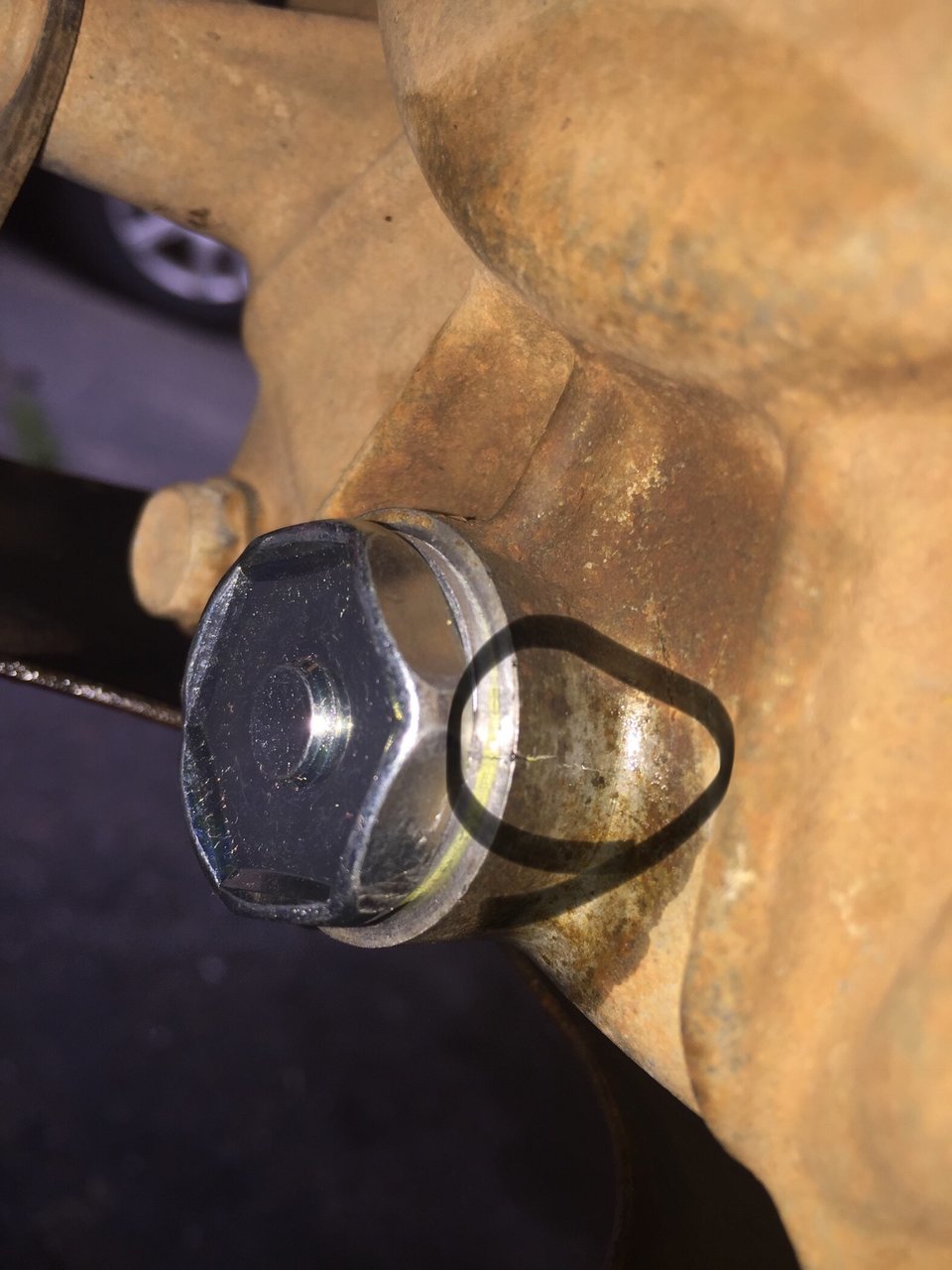

    First post. I messed up and need opinions.
    I have a hair line crack on the upper side of my transfer case drain.
    Should I buy a used case or clean and scuff it really good and JB Weld it??
  2. Jan 24, 2018 at 11:18 AM

    Is it a through crack? Is it dripping?

    1995 Tacoma 2.7 4x4
    Yes it’s dripping

    drill a tiny hole at the end of the crack to keep it from spreading then JB weld would be my vote. Possibly bevel the sides of the cracks too

    If it really is the upper, then no worries just yet, nothing under pressure in there, clean it nicely jb weld it and don't torque the fill bolt to hell. I had to tap mine over to a larger SAE allen plug after a lube tech stripped it.

    It's still pretty minor, so you could still get away with JB weld after notching it nicely.

    I'd try the drill tiny hole followed by JB Weld 1st and see if it holds.

    Definitely drill a small hole or that crack will wander. I think JB would be fine for this application.

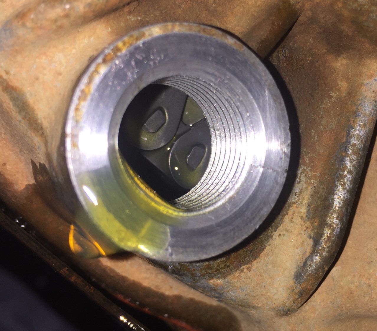

    I see you already mentioned scuffing it up. You know what your doing then, it'll be fine. I seriously doubt you'll ever have to replace this thing because of the crack. Low pressure, (extemelly low) and thick oil. It'll be fine.
    Whatever epoxy you use don't be afraid to get it into the bolt threads and tap it out. inside and out is always better. Or rather at least to the very edge of the crack.

    Thank you for all the replies! Here’s another photo. Looks like the oil is going around the threads

    Did you reuse the crush washer?
