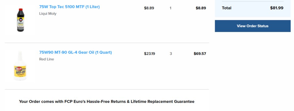

    There's definitely peace of mind not questioning these things and spending the premium for OEM. Sometimes it's for a benefit, sometimes it's for just the peace of mind and offers no real added value. I've just found Lexus guys who have used the liqui moly 5100 in their transfer cases without issue. Combined with liqui moly listing toyota's t-case fluid on their site as a suitable replacement that's what I'm going with, don't see any concern or reason not to at this point. Only $8.89 from FCP right now and even with 3qts of redline MT90 added I'm still spending less than one can of OEM t-case fluid.
    Even worst case - I'm taking less risk and closer to OEM spec with this $9 bottle for the t-case than the guys putting their 75w-90 GL5 fluids from the diffs in theirs. My truck deserves at least close to OEM spec or better too :cheers:

    I'll report back on the liqui moly after some days in the snow & below freezing temps

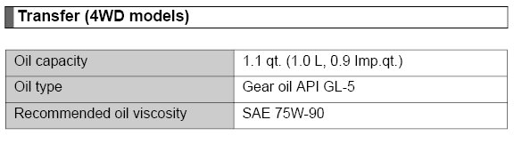

    ^LF 75W is the correct fluid. Its high cost (if bought from US dealer) has people looking for suitable alternatives.
    GL5 was specified for 1st gen and 2nd gen transfer cases, so there are 20 years of historical knowledge causing confusion. 2015 manual for example:
