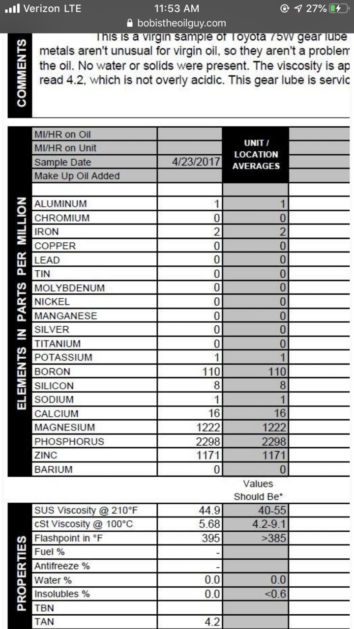

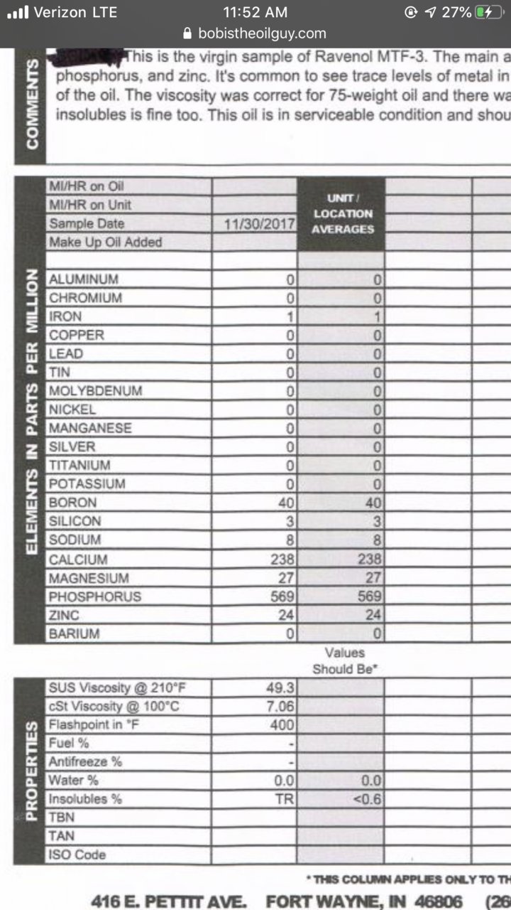

    Just a FYI: I found these comparing the Toyota fluid to Ravenol. 1st is Toyota, 2nd Ravenol. There’s a big difference in makeup of fluids. Personally I’ve called 5 dealerships and not a single one said they use the Toyota fluid. 3 use 75w85 and 2 use 75w90 synthetic gear oil.

    Not joking. My dealer had it in stock, but it took a while for them to find it. It was “on the Lexus shelf” in their stores room.
    I’m sticking with LF fluid after bad experiences in cold weather with synthetic 75/90 (as was initially recommended to me by my dealer as what they use).
    The cost of the litre of LF oil is insignificant for what it’s doing for you.

    17TRDORDCSBAT
    The fluids aren’t really comparable. The LF fluid has multiple times the anti wear additives (Magnesium / Zinc / Phosphorus) as the Ravenol. I can see why it costs more. Literally 40X the Magnesium and Zinc. I’m surprised Ravenol can even list their oil as an equivalent to Toyota LF.
