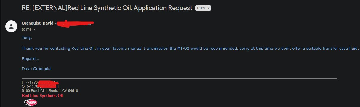

    There are messages from the RL guy in the other T case fluid thread.
    Like I posted above, they initially said that it was not compatible, but a few months later said it was and updated the website.
    Here's the message they sent me:
    Later, they changed thing. Might have done some analysis and testing in the interim? Either way and in general, RL fluids are good in my mind.

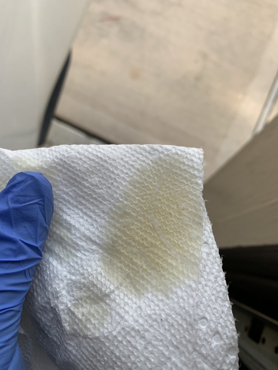

    Guys is this looks clean? No burnt smell. No unusual smell that I can tell that it’s contaminated already. At 30k daily driver city/highway.

    DAS Taco

    31,338
    tony
    Lynnwood, WA
    Heck ya.
    I should not have touched mine at 7k. The T case fluid should be good for a long time. I was surprised and learned.

    Thanks guys that’s 30k miles so don’t change it. Check 1st before changing it don't waste your money!

    I wasn't that smart. :D
    The diffs and MT did need it though. At 30k, they were looking really good just checking then.
