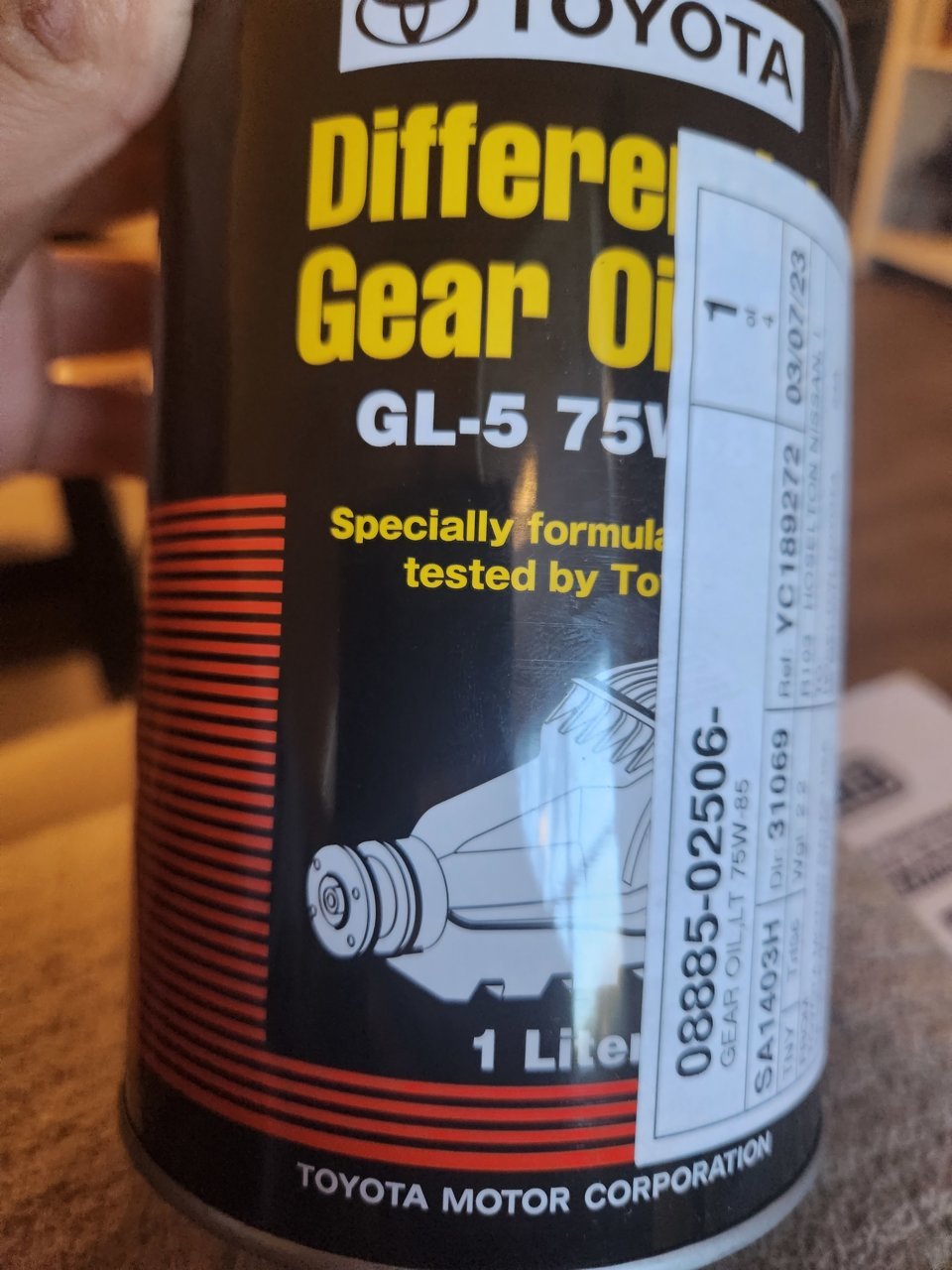

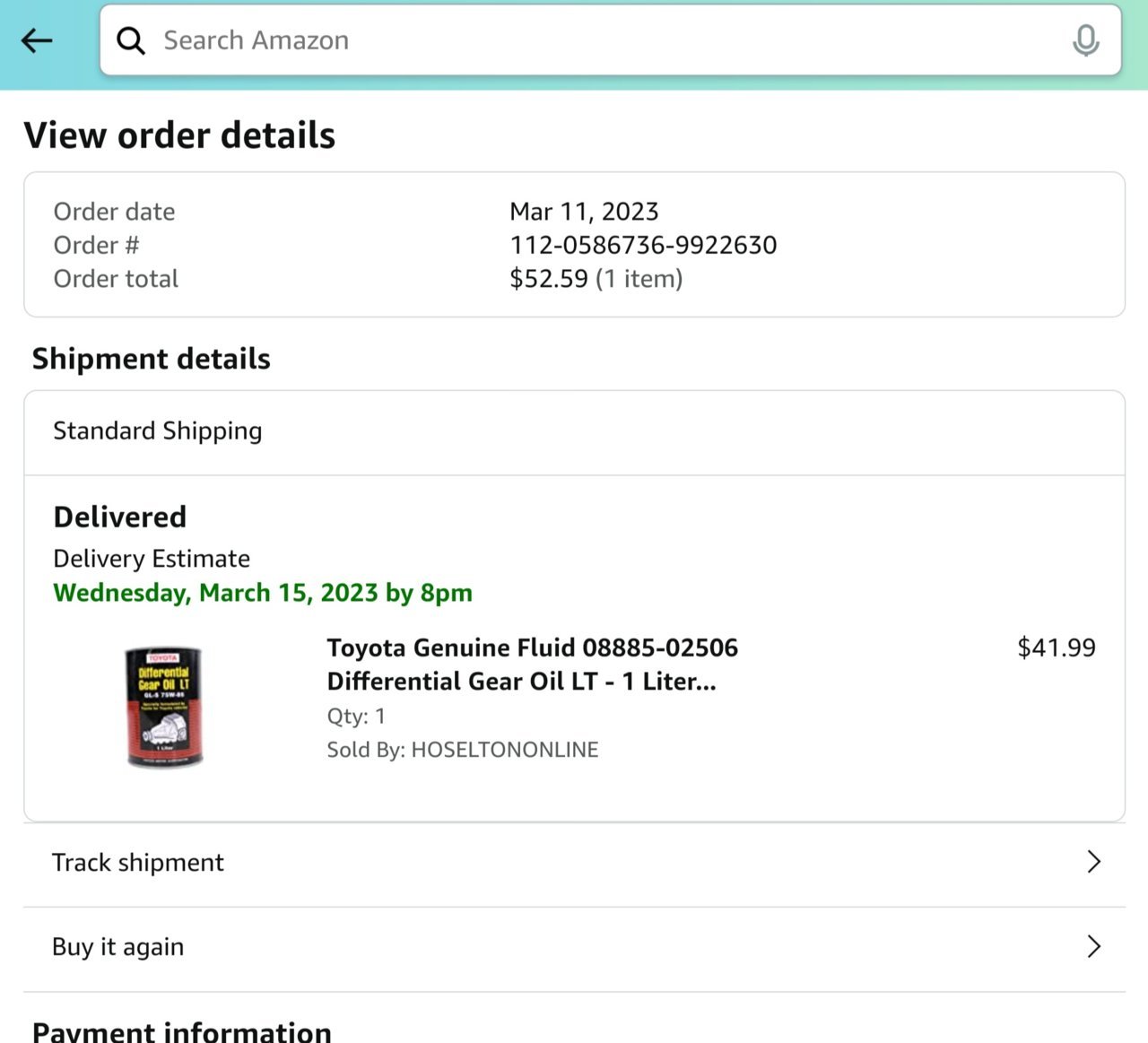

    Bought min
    I bought LT 75W-85 GL-5 from Amazon, for about $42 for a Liter, in case you ever want to go back to OEM.20230319_185017.jpg Screenshot_20230319_185036_Amazon Shopping.jpg
    mquibble likes this.

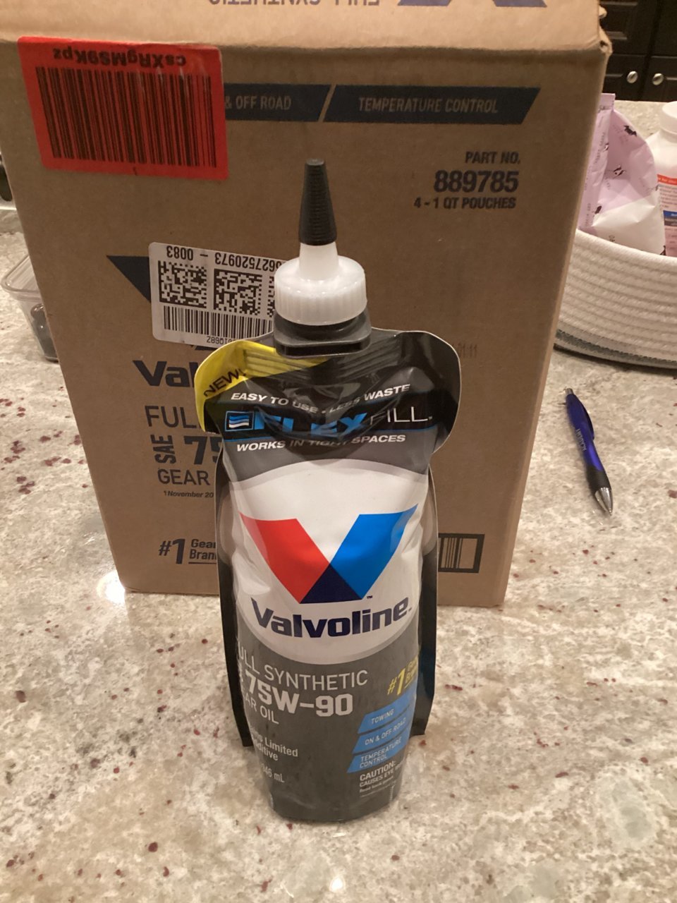

    Just did my rear diff using this… $50/4 quarts on Amazon and no need for a pump with the bag design.
    sorry no comment on transfer case fluid as I’m a loser 2wd.
    erok81 and Bcjammerx like this.

    erok81
    erok81 Well-Known Member
    Aug 15, 2016
    #194699
    5,708
    Imposter
    I almost got this but ended up going with this instead.
    T case I just got some redline mt lv.
