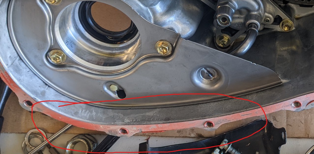

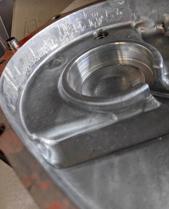

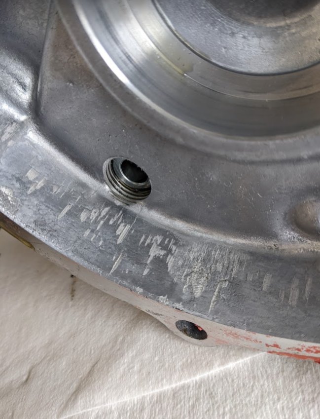

    So if its something that occurs with any regularity then consider the chain. In your video you can hear it and then it pauses briefly then again sounds like the same but the vid cuts off. Why I was thinking a longer vid would be nice. Perhaps its only at a certain RPM (you mention it happened roughly 8 times. Chain stretch happens - how often, that I have no idea.
    I know with the 95 transfer case I have here, when I cracked it open you can definitely see where the chain was hitting the inside of the case. Why it was hitting, I have no idea. When I rebuilt the guts, I opted to re-use the chain. No issues and no out of place noises. The chain can still be ordered but its a few hundred dollars iirc.
    Bivouac and treyus30[QUOTED][OP] like this.
