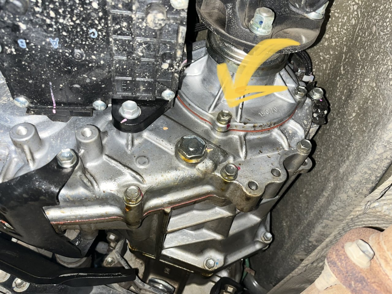

    Hey guys! This is my first time ever posting in here but I want to get your opinion on something here.
    I picked up my new Tacoma from a private personal seller so I don’t have any dealership warranty benefits unfortunately and my transfer case begun to leak about a day or two ago.
    It only has 14k miles on it, I’m really hoping it’s just a gasket seal kind of thing or something because you can see that red lining around it and it’s actually only spilling from that one little bolt I have highlighted there for you.
    i went ahead and tightened that bolt and it actually kind of fixed it but I knew if I went further I would strip it and cause damage.
    Any of you faced and similar problems or do you guys even think it’s the transfer case?0274E084-007B-47AA-8A79-7C4F3BB218DB.jpg

    What year is the truck? If 2021, it's still covered under warranty.

    In that I case I think it does void warranty. My next suggestion would be to clean off the oil and see if it reappears in the same spot. It kind of looks like engine oil to me, but that's a guess.

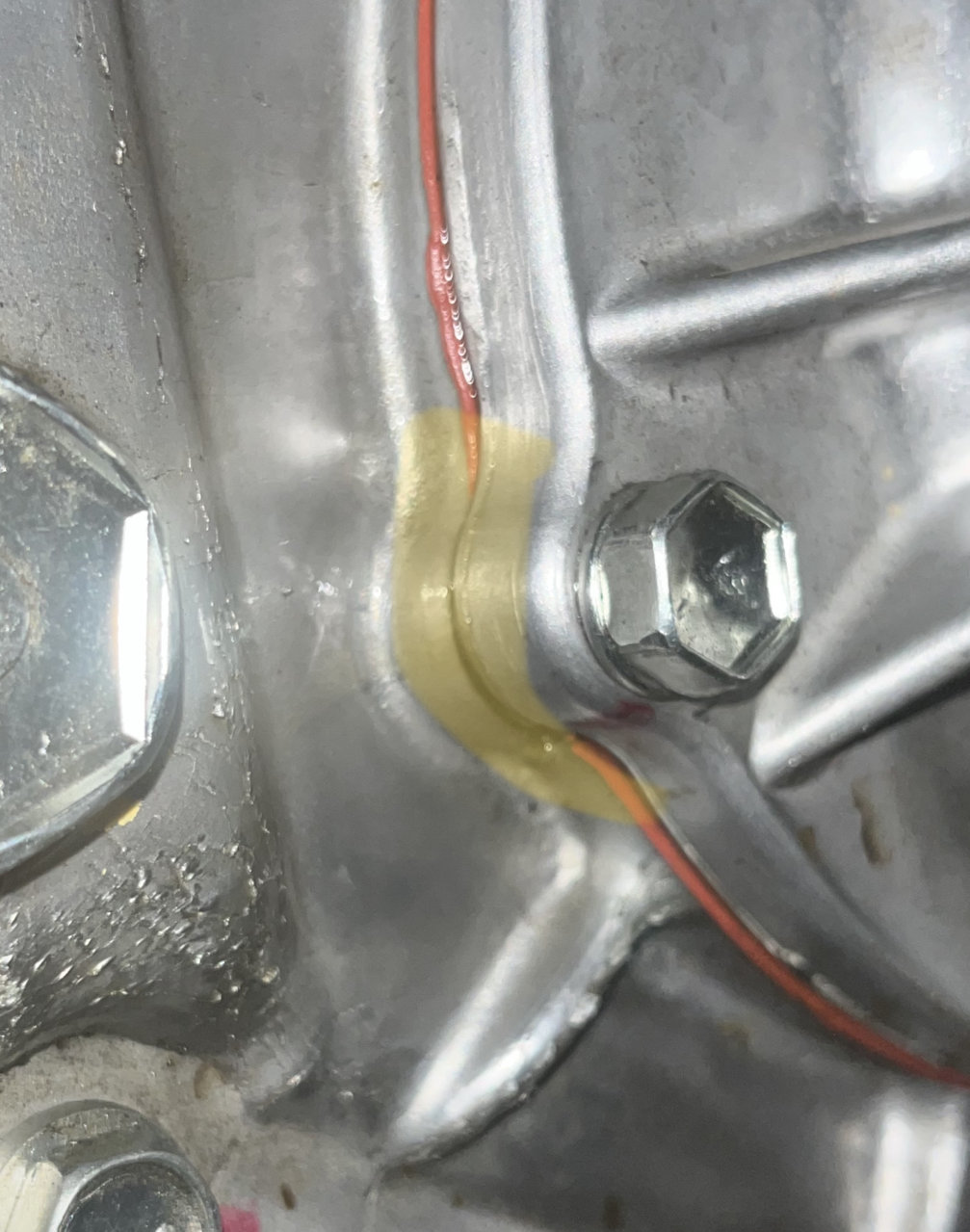

    it actually seeps through on the little slit on the bottom where both the parts connect? Idk it’s hard to explain but here’s a photo that I highlighted that shows where it’s leaking so no thread locker would work for it I think at least A2AB3C75-B4D3-435D-AFF5-C7327AF81178.jpg

    If it is the transfer case you'd be better off draining it, then apply the rtv, letting it dry, then filling the transfer case back up.

    It was coming from under the bolt at one point but when I tightened it it stopped so now it’s seeping through under where that metal to metal connects. I’ll definitely try that stuff out and see if it works, I’m just hoping it dries quick so that like the oil won’t seep through

    Well, the trick with rtv gasket maker is to apply it to a clean and dry surface. If it continues to seep while the rtv is drying there's a good chance it won't seal completely. That's why I recommend draining, applying rtv, letting it dry, then refilling the transfer case.
    You could try to apply it without draining, but I give it a 50/50 chance of working or holding up. The black permatex rtv is really good stuff if applied correctly though.

    Yeah I just saw videos on it and it actually does look like a good shot. However I feel like pulling the whole cap off and then applying it that was would possibly work better?
    also what’s weird is that the fill hole for the fluid is actually below the bolt it’s draining from? The large bolt you see in that photo is the fill hole and further down is a drain hole. So how would the fluid reach back up there?

    You could try that. Likely from oil sloshing around inside the case when driving.

    It could be but like it’s continuously dripping all the time even when sitting

    Take it apart, clean it up, apply the rtv, let the rtv tack up, bolt up the piece, let it dry, then fill it back up with oil. :popcorn:
