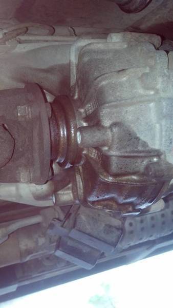

    Just noticed that I've developed a leak here too.
    Been searching the hell out of it and wanted to add this info that I found here:

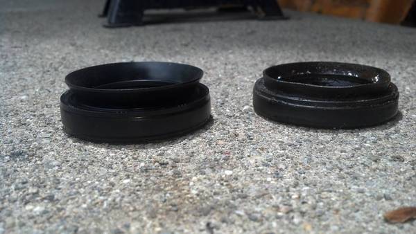

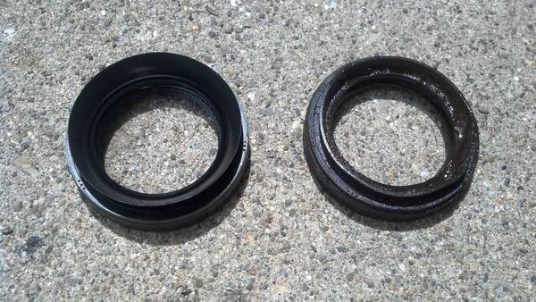

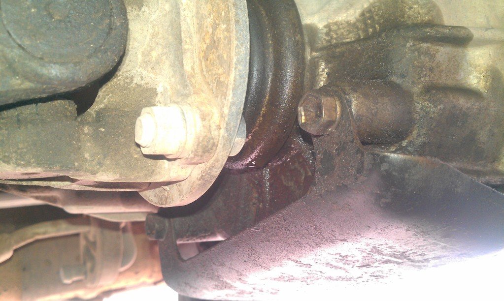

    So I did the install last weekend.
    heres the leak:
    I got both seals for the front output not knowing which one was bad. Turns out it was the "inner" (larger) seal that was fubar.
    P/N for my '01 v6 DC were:
    90311-41012 Larger seal $11.52
    903213-23001 Smaller seal $3.74
    90179-22016 Nut $3.36
    new vs. old
    as you can see the old one was pretty shot w/ lots of debris, there were two noticeable areas of minor damage/tears that were causing the leak.
    I followed the t4r write-up and it went pretty smoothly. Un-staking the nut was not too bad, just used a flat head screwdriver (did break one off though :() I first tried to "seat" the seal w/ a piece of pvc pipe that I had lying around but I accidently pushed the seal in too far and it went into the TC :eek:. I had to pry it back out and almost tore the new seal!! :eek: On my second attempt I found it easier to just press it in with my thumbs.
    Got everything all buttoned up and no more leak!

    Well FUUUUUU!
    Started leaking again, very slow leak. Either I did damage the new inner seal when I had to pull it outta the TC or now the outer/smaller seal (which I didn't replace) is now bad...
