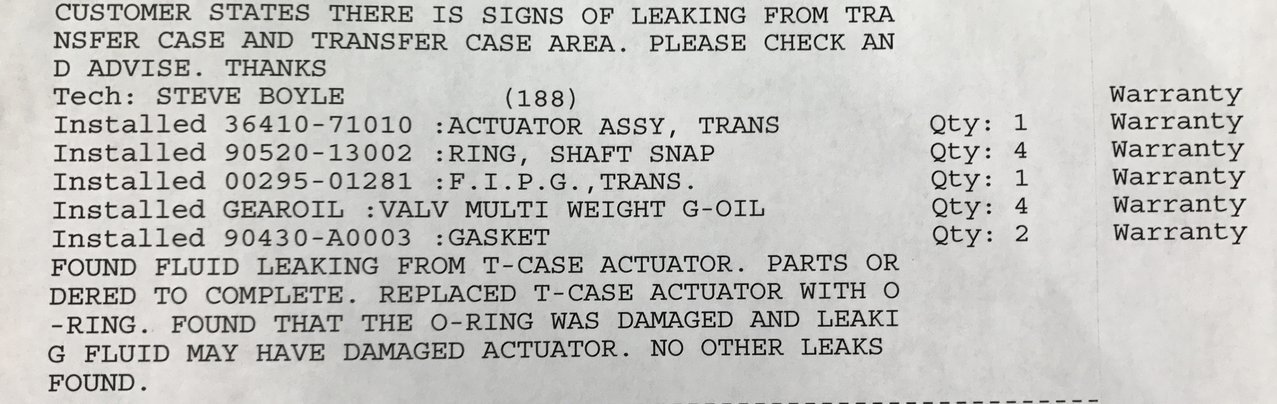

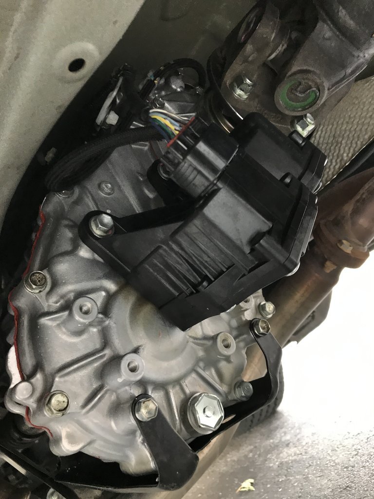

    Just picked up my truck. I asked to speak to the technician that did the work so that he could walk me through what he did (in case it might have been different from the original diagnosis), but he was up to his elbows in another car and couldn't come out. As you can see in the notes on the form, he said the O-Ring was leaking and "may" have damaged the actuator.
    For everyone that was interested in the gear oil issue, he refilled the case with Valvoline gear oil. I'm assuming that by "Multi-weight" he means an oil with a cold/warm viscosity rating (e.g., 75W-90).

    I know my Toyota shop would fill it up with mobil-1 75-90. Looks good now.

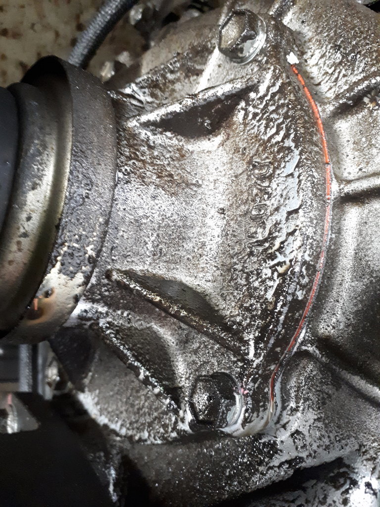

    Found a small amount of fluid outside my transfer case around 9200 miles. It was thin and pink like transmission fluid so I was skeptical it was the transfer case, but when I took it in the pulled the transfer case and replaced two shaft seals, 90311-43013 and 90311-43008. They gave me a rental car, no hassles, and finished in one day. The seals weren’t on hand, or they would have repaired same day. I picked it up off hours so I didn’t get a chance to ask them any questions. It’s strange why new seals would leak.
