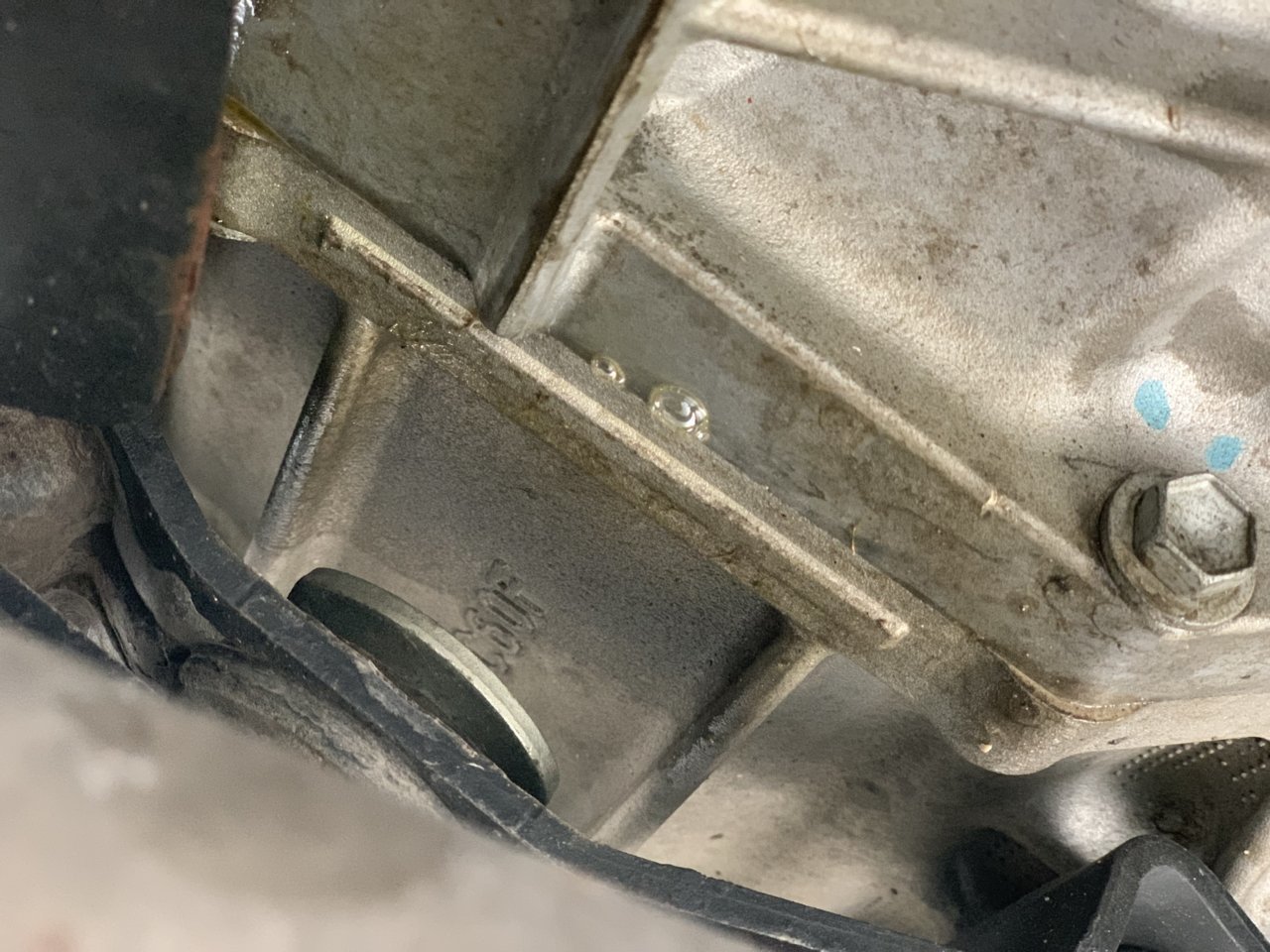

    I ended up having a leak on the transfer case in my 2017 Pro. I'm still under Toyota Care but they looked at the leak and determined it was coming from the seal area where there's that pink fipg sealant. They ended up taking the case apart and noticed that there was about a 2-3" part of the seal that was missing. Looks like factory machines can make mistakes! Anyways, hand laid new fipg sealant and put the case back together and the leak is now gone. Not sure how common this is but it was definitely an issue on my truck that luckily got repaired quick. My truck was in the shop for 8 hours to get the seal replaced. I left it there overnight to let the sealant dry and picked it up the next day.

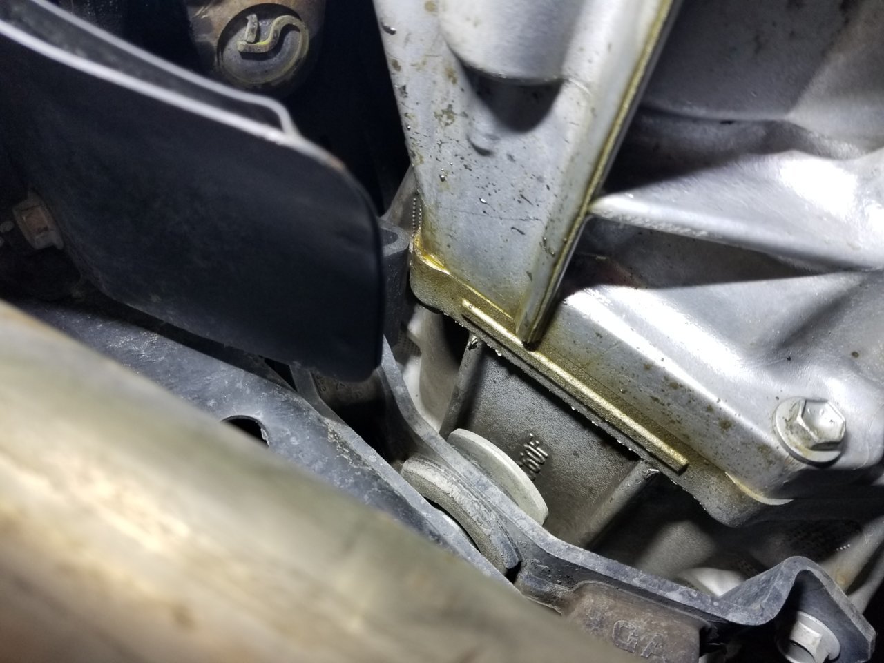

    Peeked under the truck this weekend and noticed what appears to be some oil on the transfer case. Seems that there's a drop or two more near the fill plug. Should I be calling the dealer to have it checked out?

    I would.

    Yeah. Took it in and dealer filed down part of the fill hole and replaced the gasket. All under warranty. Seems fixed after several hundred miles.
