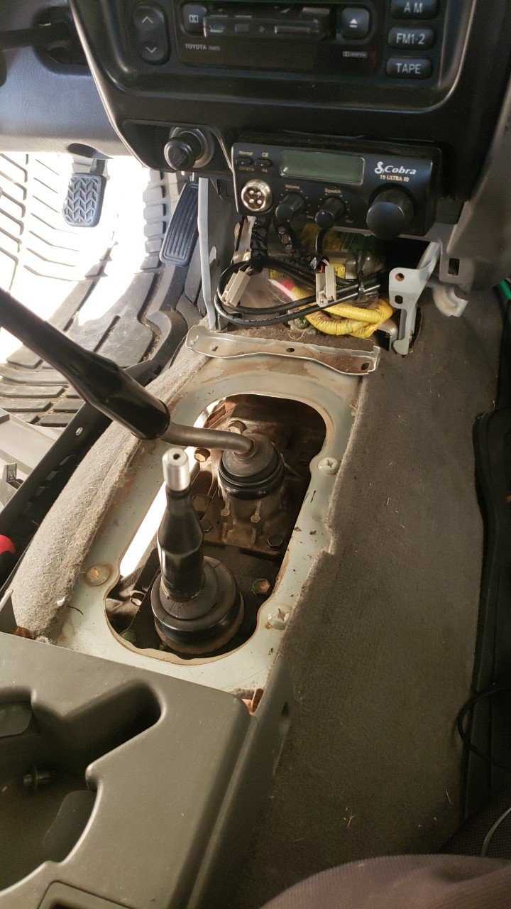

    Sorry to dig up such an old thread, but I've gotta do this fix over the weekend. I'm assuming this is where my leak is coming from. I looked through all the threads I could find, maybe I missed it...but is there any guide for the automatics on what has to be disconnected to get the plate up?
    I can of course jump in there and figure it out, just don't want to miss a spring or something and not be able to get it all back together the same. Any pointers?

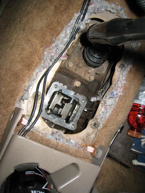

    Nope, basically no difference between the automatics and manual tranmission. Just pull the shifter assembly (have to disconnect it from the shift rod on the drivers side of the tranmission) then access the t-case shifter same as in the photos above.

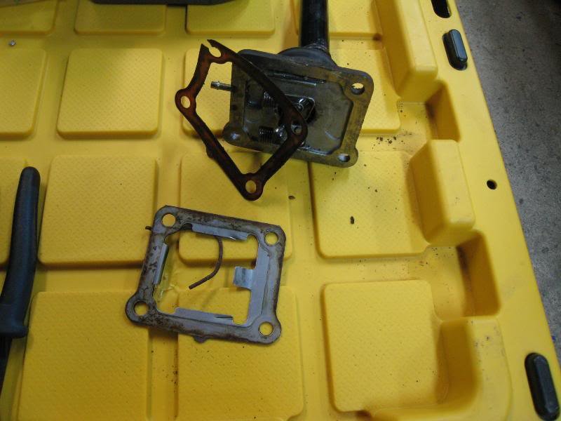

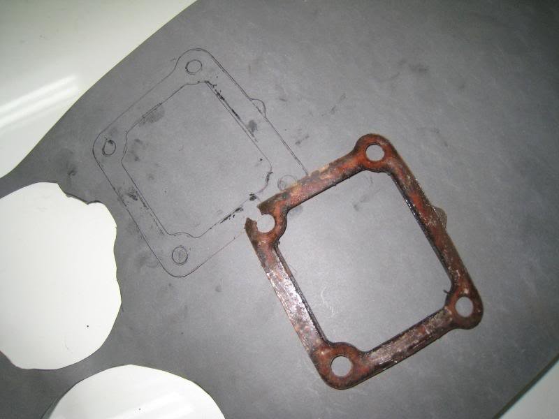

    I did this to my 2004 it was a great help in finding and fixing this leak, I just hand tightened the bolts and didn't lay into them and all was well. pretty easy job if you follow along with the OPs instructions, Toyota doesn't sell that gasket, just trace out the old one on some gasket material,cut out, I applied a super light coat of grey RTV to both sides, and snugged it back together, worked 100% great

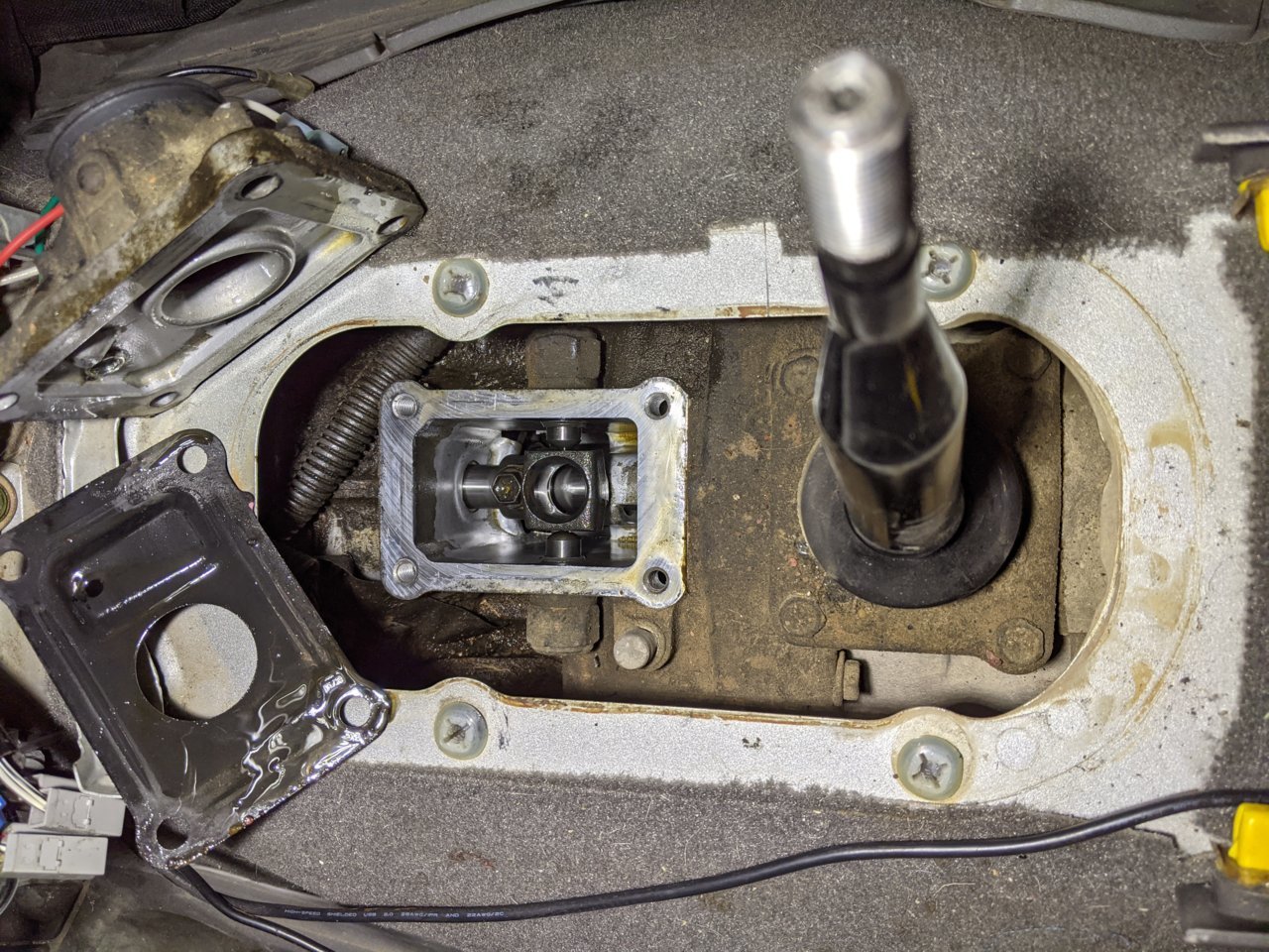

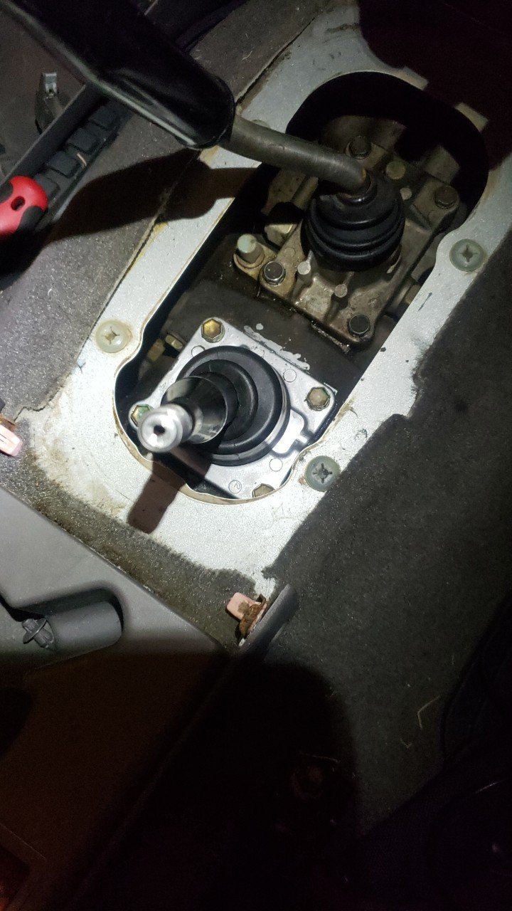

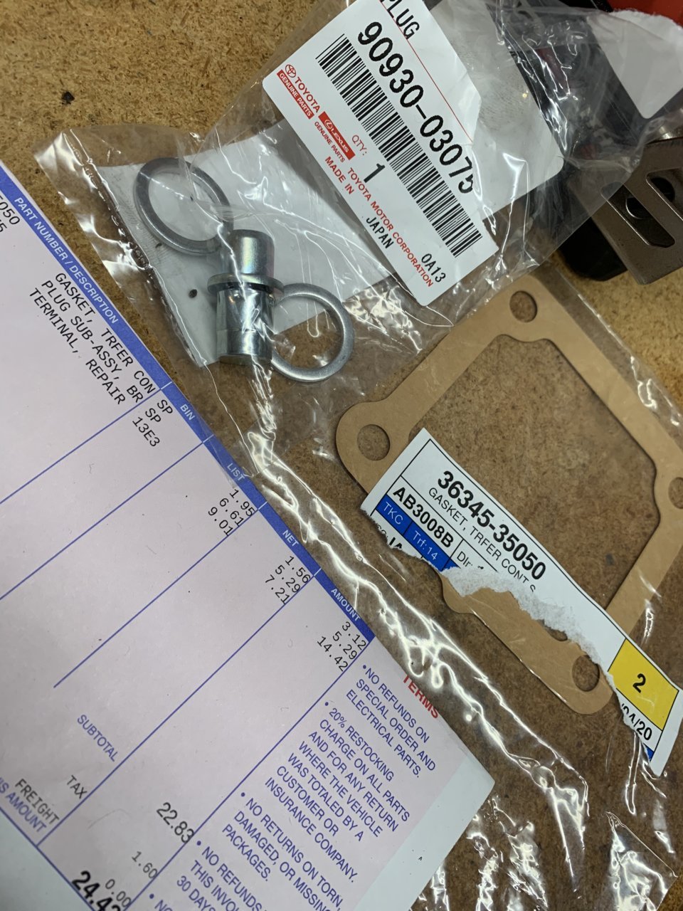

    Did this a few days ago...
    Bought the fel-pro gasket maker and factory gaskets.. Should have used the felpro but factory ones are working just fine so far. Also used black RTV.
    IMG_20201207_163947_01.jpg IMG_20201207_165933_01.jpg IMG_20201207_180215_01.jpg
    TWJLee likes this.

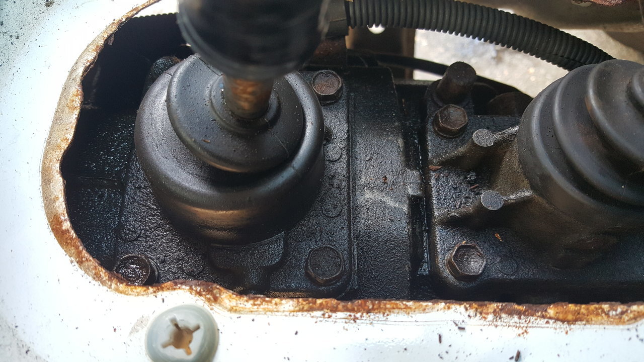

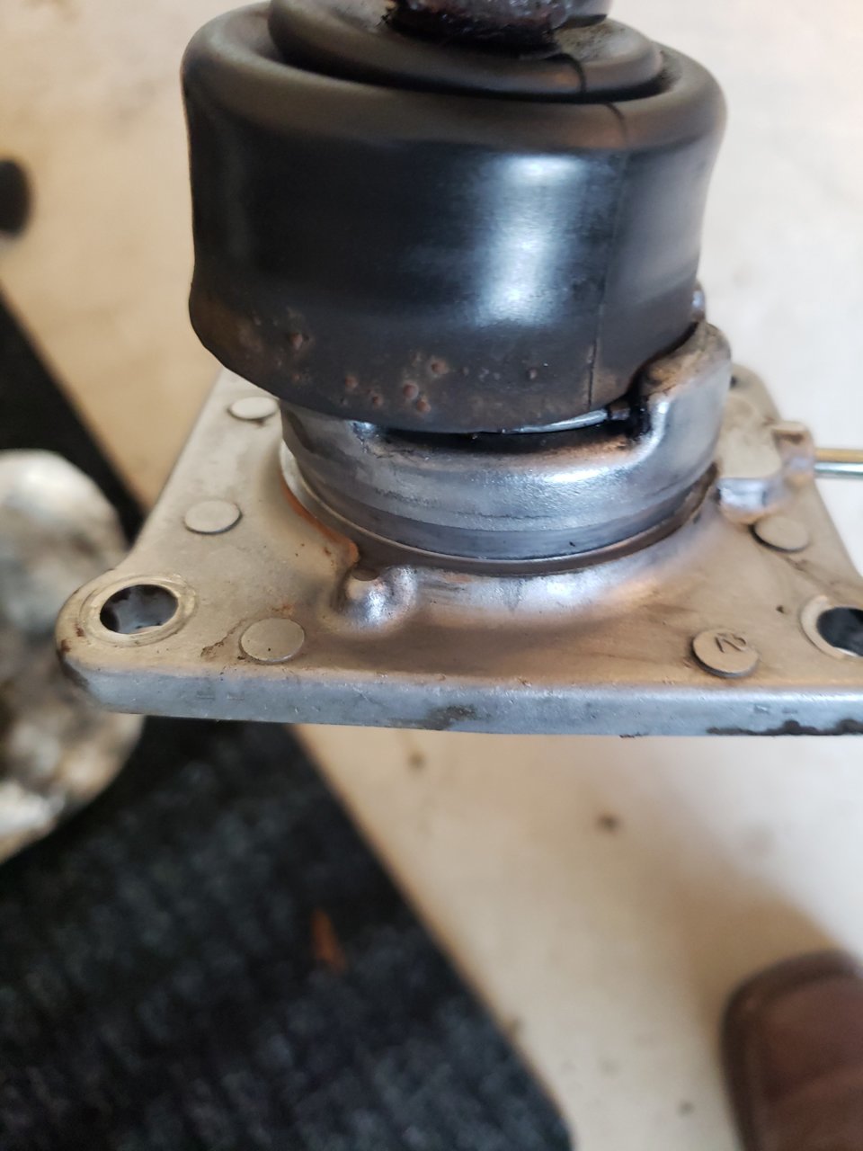

    bumpity... Been meaning to get to this for a bit, finally doing so with all the other crud I swapped out for a 280k maintenance. Question though, the 4wd selector has the paper metal sandwich gasket, is the main shifter supposed to as well or does it only have the metal one? Mine (2002 4wd 5spd) only has the thin metal plate gasket, not even rtv, and is leaking more on the tranny side than the xfer side, which looks almost dry. I'm wondering if I need to craft a couple gaskets for this or just spread some rtv on the metal one when I put it back in, or if its fine without anything and maybe its leaking from somewhere else. Do the spring pins have seals/gaskets that could fail?

    Yep, need to seal, I used black rtv and then changed it for felpro material and I think red rtv as well,
