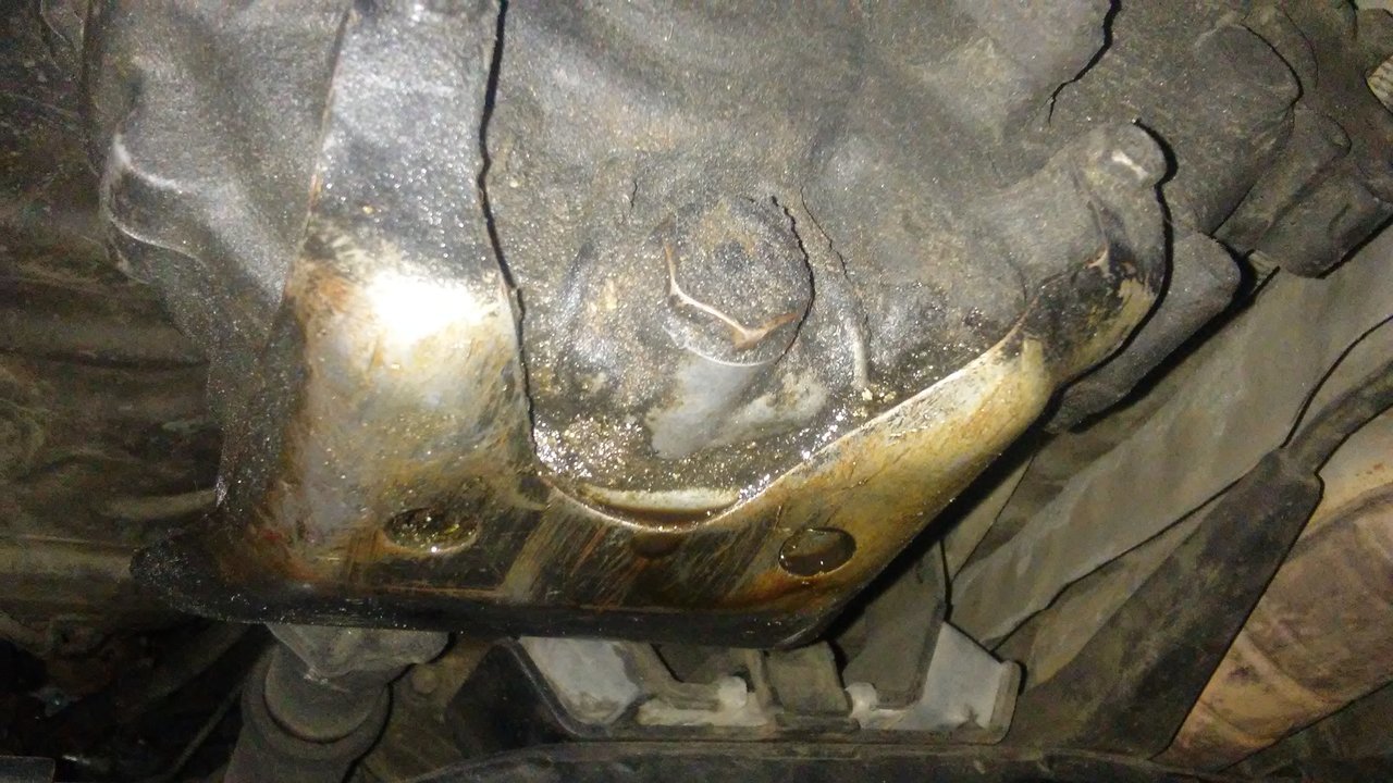

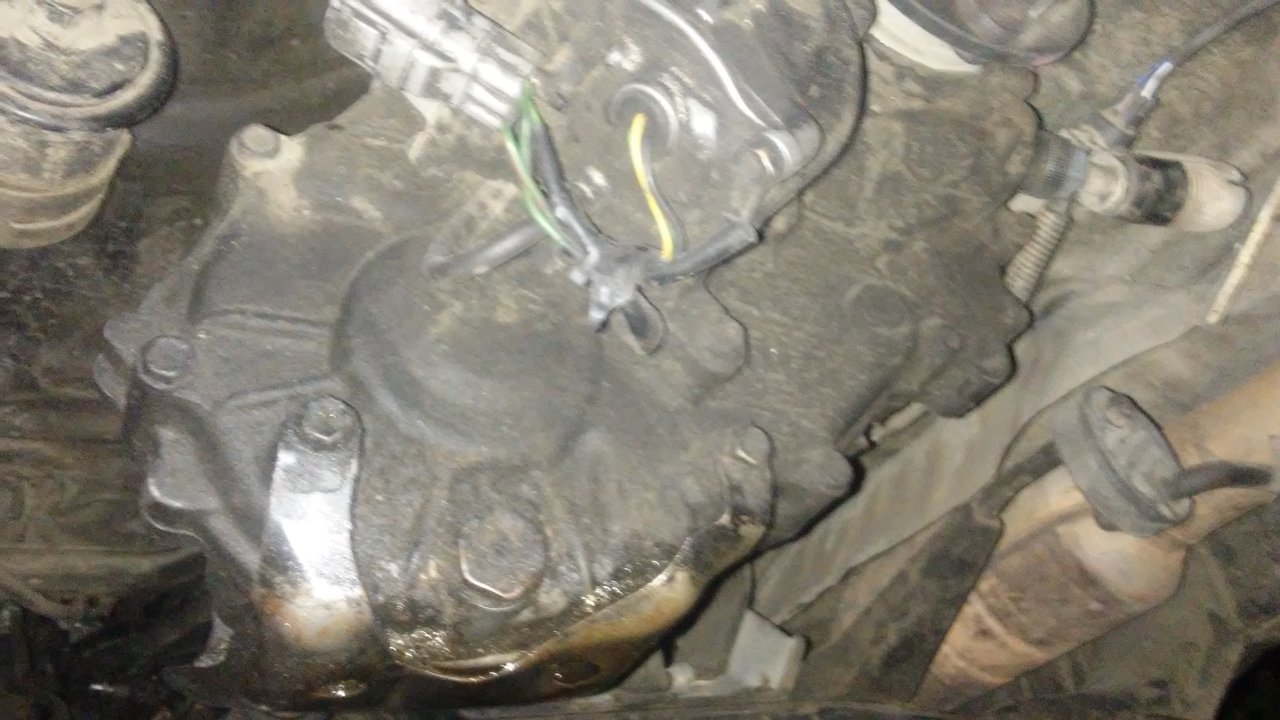

    My transfer case leaking.. anyone know what the problem might be? Seals, gaskets, etc..

    Just replace the seal behind that driveshaft and you’ll be good. It’s late and I can’t quite remember the name of it but I think it’s an output seal. Correct me if I got that wrong TW.

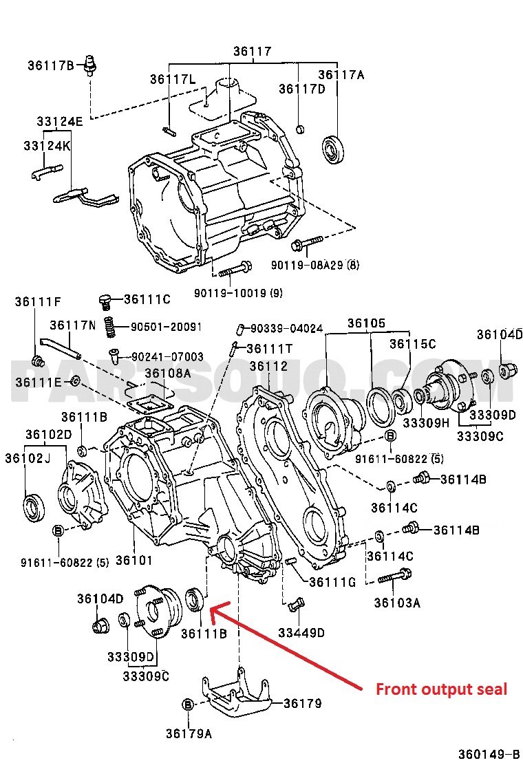

    Part number# 9031141008
    That's what it looks like to me.

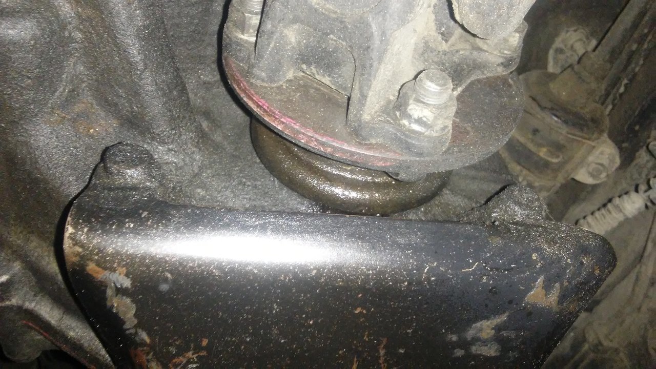

    Dont forget to install a speedy sleeve or that new seal will leak just as bad as the old one
