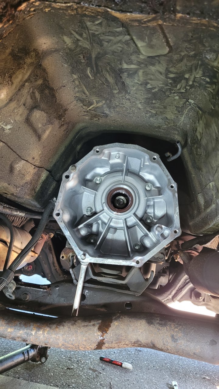

    It's probably water. I'd drain and refill the t-case just to be sure you know what's in there
    There's actually an empty cavity between where the fluid is in the transmission case and the fluid in the t-case. If the transmission output seal was leaking it would fill up the cavity and drip out at the seam where the t-case bolts to the transmission.
    I had a leak at my t-case input seal and that same cavity was full of gear oil

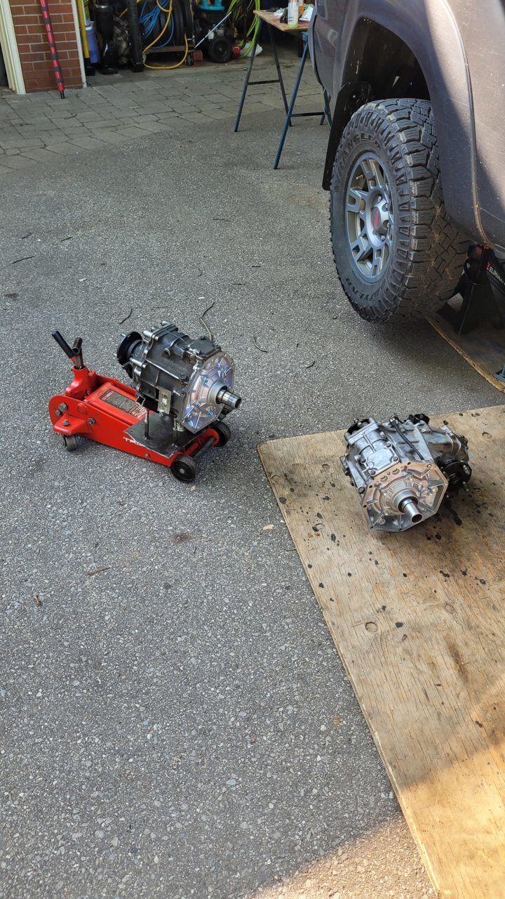

    I replaced my tcase last week. Here are some pics. Helps illustrate what b_r_o above was describing. There is no gasket between the transmission case and tcase case, so any fluid that fills up that space is leaking out of the bottom. 20230707_171902.jpg 20230707_171826.jpg
    Rob MacRuger and 6 gearT444E like this.
