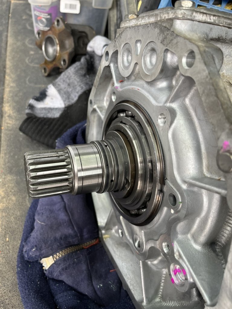

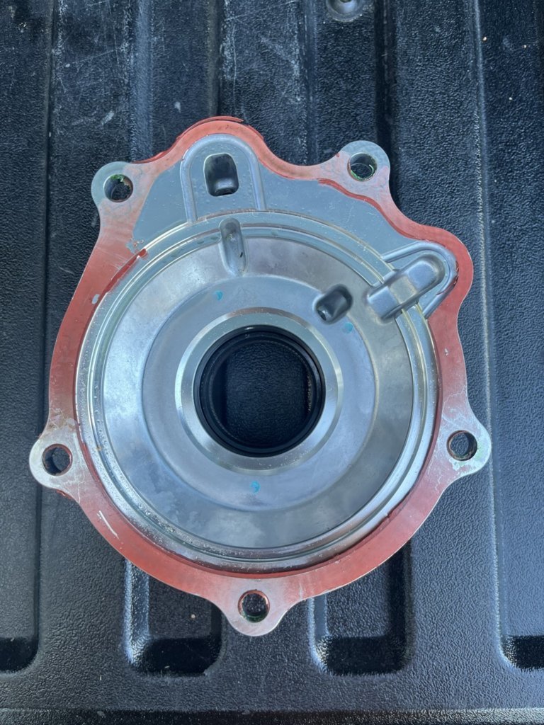

    Yea i'm not too sure. Here is a pic of his removed extension housing it looks like 1 seal. but I do see two seal grooves on the input shaft in this second picture of his maybe he replaced the seal on the transmission end too? i'll circle back with him

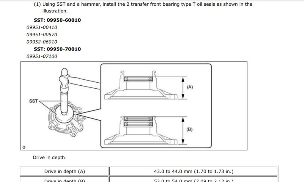

    RC60F Transmission ADD delete with FJ full-time tube FJ Metal Clutch Pedal OEM Mexico-Spec Condenser Fan 265/70R16 Michelin Defender LTX M/S 2 OEM 1-Piece Lug Nuts Custom Built Switch Panel for all Electrical Accessories Rigid Amber Pro D-SS Ditch Lights Rigid 30" SAE High Beam Driving Light Bar Rigid SR-Q Pro Back-Up Light Kit (Recessed) VLEDS Tail Conversion VLEDS Foot Well Light Kit KC HiLites Cyclone V2 Under Hood Lights Operable (Switched) Clutch Safety Bypass
    So...I was wrong. I have never seen this next diagram before... I narrowed it down by manual transmission this time and found a new diagram - there ARE 2 seals in the MT input housing on the transfer case. The AT has 1 seal.
    My guess is that Toyota doubled up the seals to prevent the t-case and transmission from leaking into each other, in case one goes bad. So basically, transmission oil is splashing up against the 1st seal, and transfer case fluid is held in place behind the rear seal.
    Regardless, you just need the one transfer case seal for an AT, plus you need to seal the seal housing with RTV.

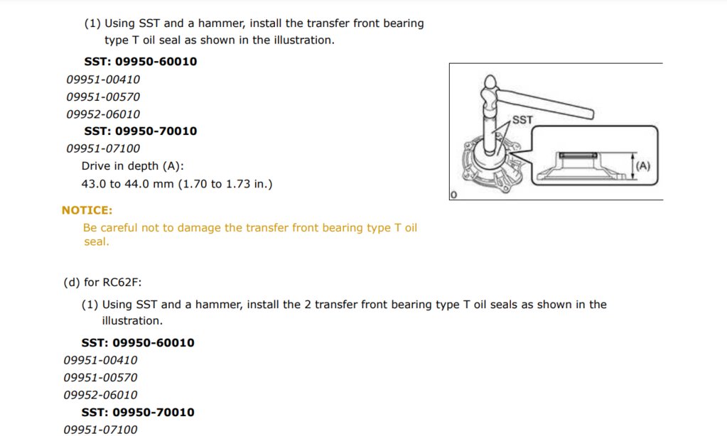

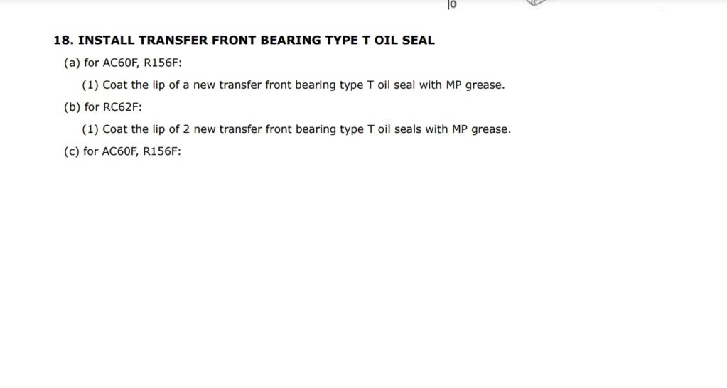

    Yep it is two seals for MT and one for AT found this in the FSM as well shows the two vs the 1 for AT ty for the help BLtheP

  12. Feb 20, 2025 at 2:20 PM
    #32
    blitzkrieg3002
    blitzkrieg3002 [OP] Well-Known Member
    May 30, 2016
    #188296
    1,217
    Rick
    California
    2019 Tacoma SR5 4x4
  13. Feb 20, 2025 at 2:22 PM
    #33
    blitzkrieg3002
    May 30, 2016
    #188296
    1,217
    Rick
    California
    2019 Tacoma SR5 4x4
    Posting this info incase anyone else stumbles upon this and needs help.
