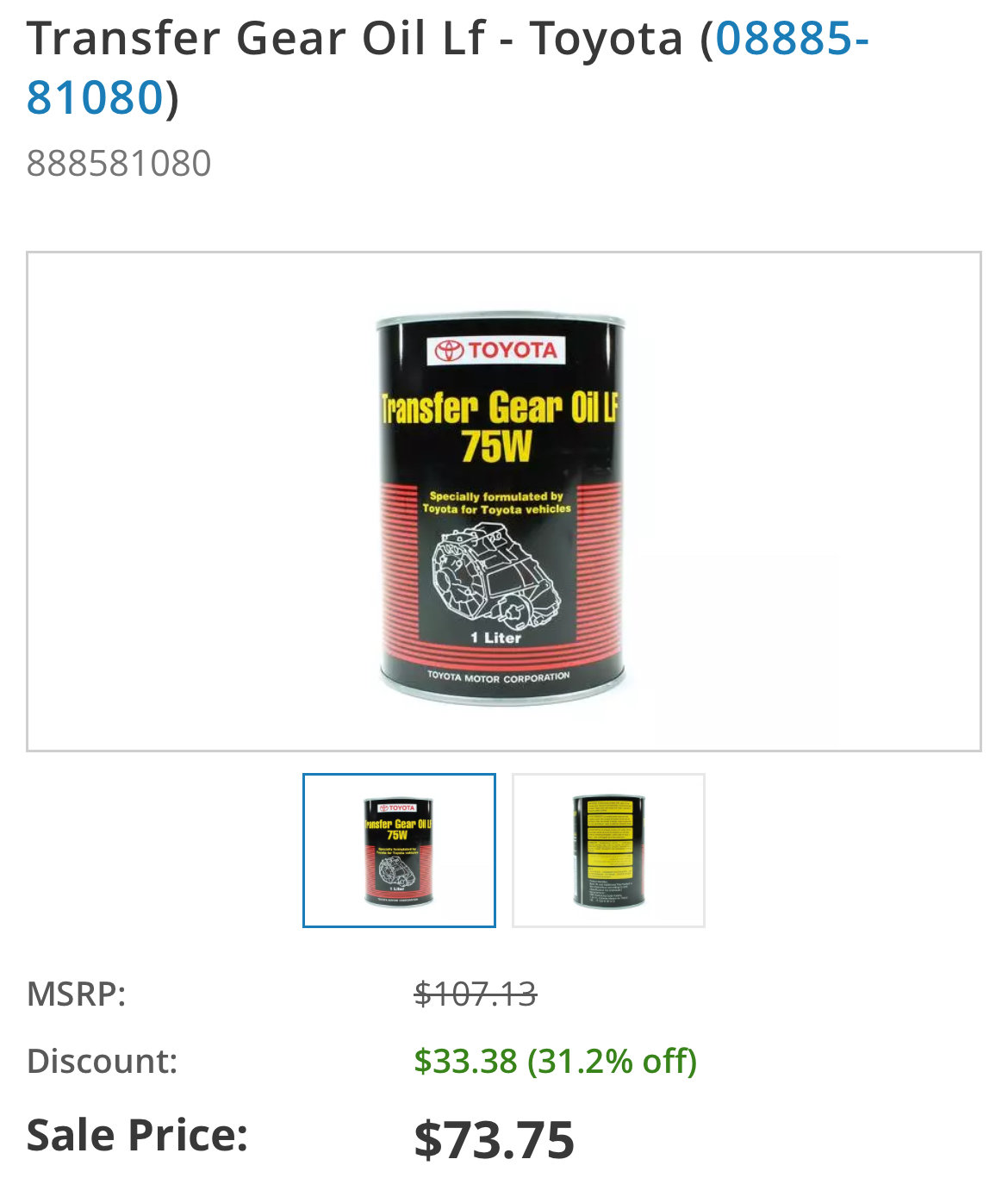

  16. Jan 13, 2024 at 12:59 PM
    #36
    TacoTuesday1
    TacoTuesday1 Well-Known Member
    Jun 19, 2019
    #296781
    7,751
    FL
    this makes sense. My regular DOT4 doesn’t feel as good cold.
    and on a snowy morning I’d be in 4x4. If I know it’s gonna snow the next morning and is already snowing then I leave/put it in 4x4 first overnight so it’s already engaged.
    I wonder what the 75w costs from the dealer and if anyone else makes a good and well priced equivalent that’s also 75w, not higher
    $75 and a peanut can, yikes
    3JOH22A[QUOTED] likes this.
