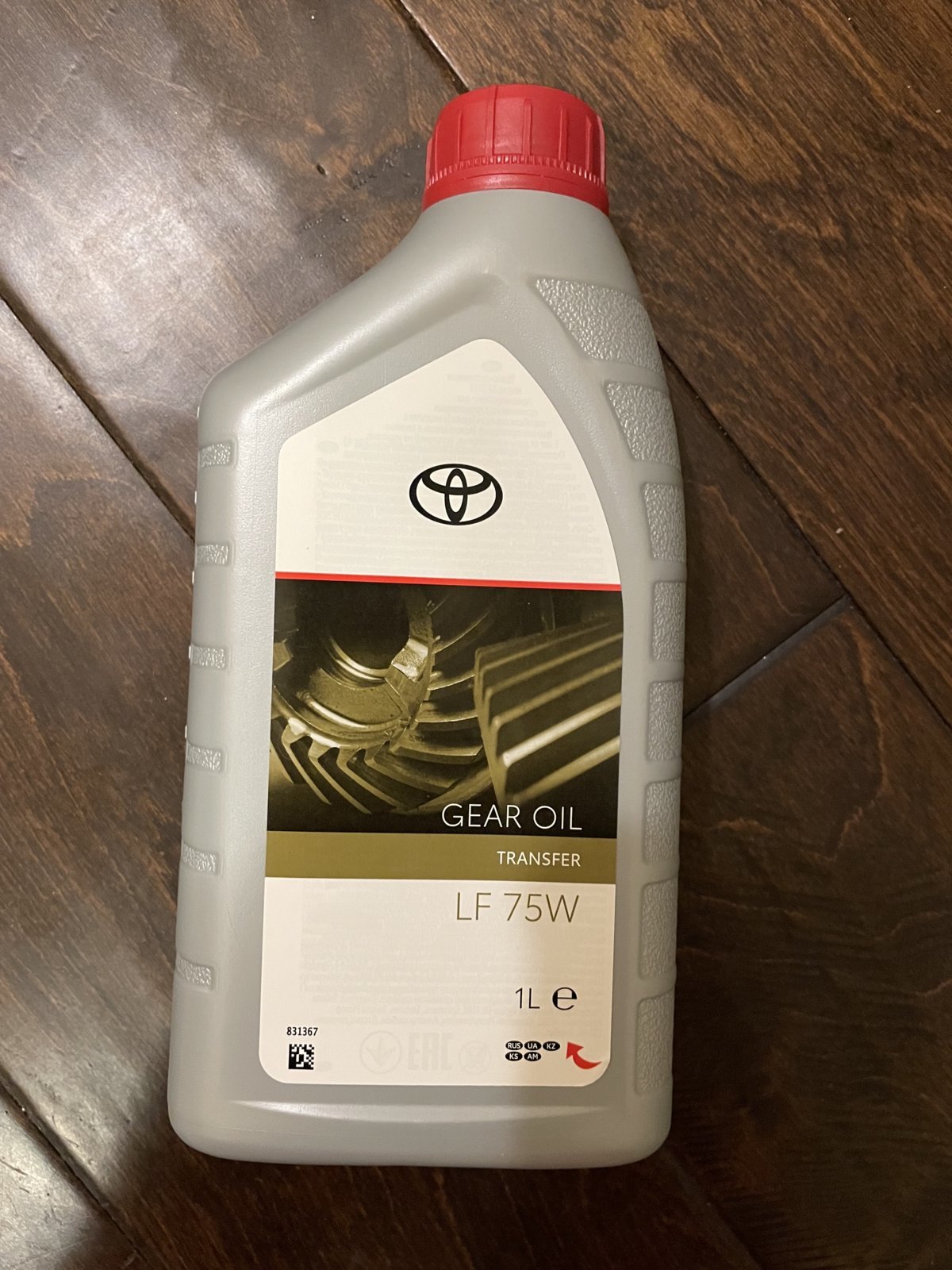

    Interesting. I have not performed the fluid change yet. Let me look into this and I will probably return it. Yes, it was from Amazon. I tried to just pick up a can at the dealership and they did not have them in stock. Plus, they quoted me $137. I'll check out the other local dealership. I know I have seen them for $99-102 for eBay listings from official Toyota dealerships as well.

    This came up exactly two months ago: https://www.tacomaworld.com/threads/transfer-case-oil.817223/
    Looks like European packaging, Toyota P/N 08885-81081 (instead of 08885-81080 normally sold in North America).
    German site selling it: https://ato24.de/en/toyota-transfer-gear-oil-75w-lf-1-l.html
    UK site selling it: https://www.roughtrax4x4.com/1-litre-genuine-toyota-transfer-case-gear-oil-lf-75w.html
    Note the much lower retail markup Toyota puts on the oil in Europe.
    I'd run it, just to tell people you're running imported T-case oil from Germany. :D

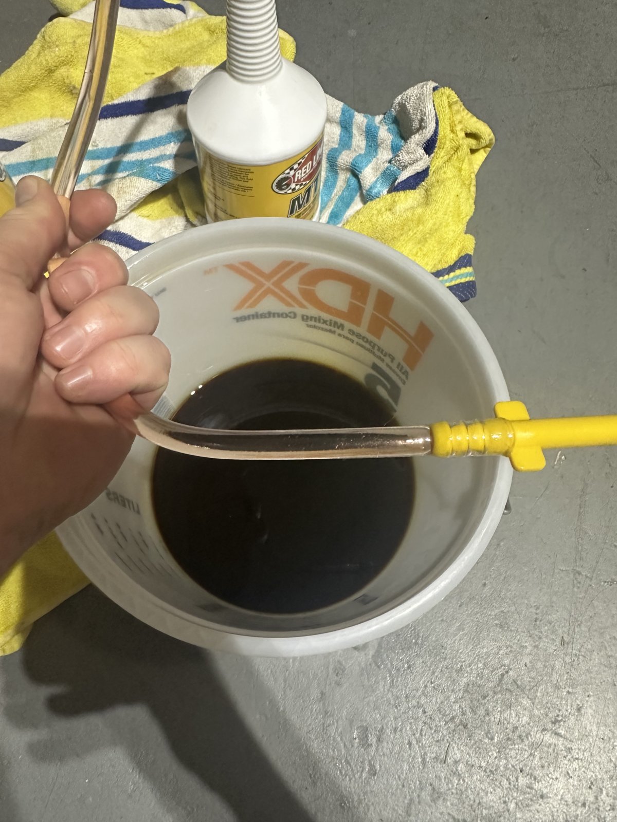

    Old Toyota fluid and new fluid. Redline MT-LV at 30,000 miles.
