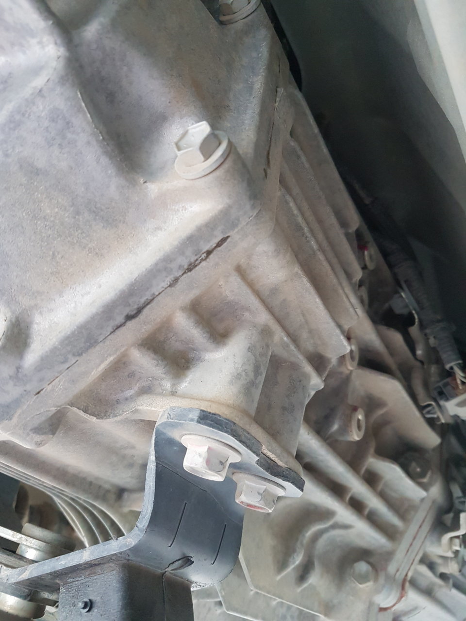

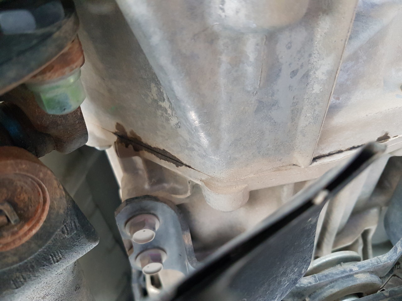

    Seems like i found some seepage on my transfer case where it meets the transmission while under my truck today. 2018 with 9000kms on the clock. Appointment with Toyota set for Tuesday afternoon, any one else have a similar issue?

    Also, the truck just had it's 8000km (5000miles) check up and oil change done at the dealer on April 16, no mention of any leaks or issues.

    Thanks, from the photos and info in that thread it seems like most of those leaks are at the rear of the transfer case and not up front where it meets the transmission.

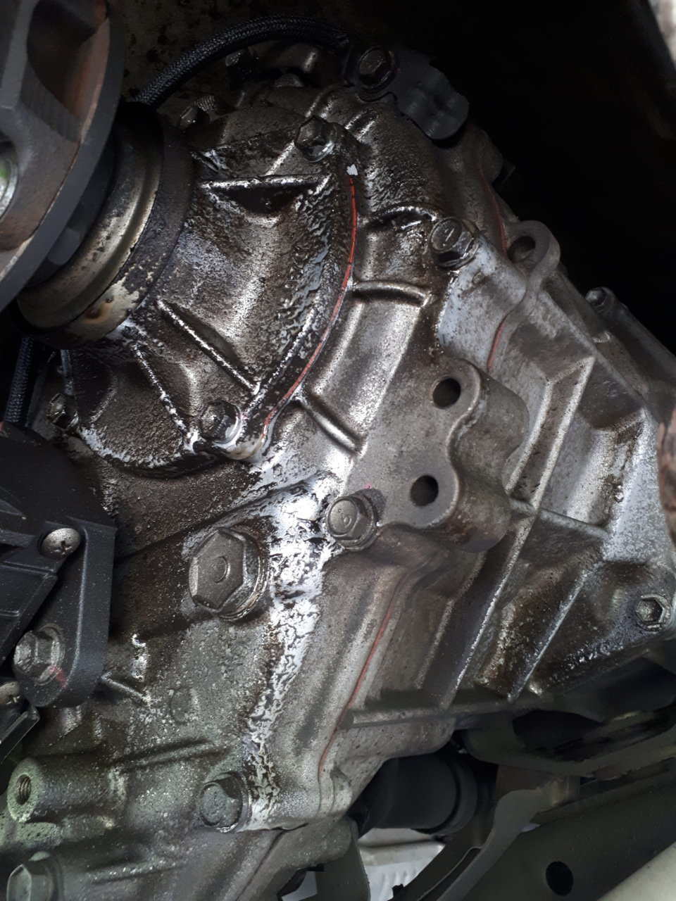

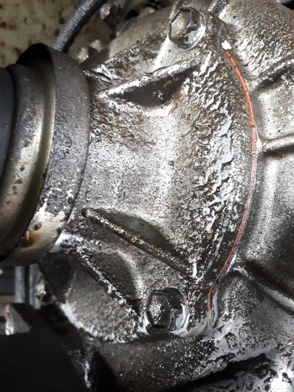

    Yep. They replaced the transfer case 20170511_165126.jpg 20170511_165142.jpg seals under warranty

    Probably had about 45,000km when I went to fluid film it. The leak wasnt there the season before. And no more leak after about another 15,000 km

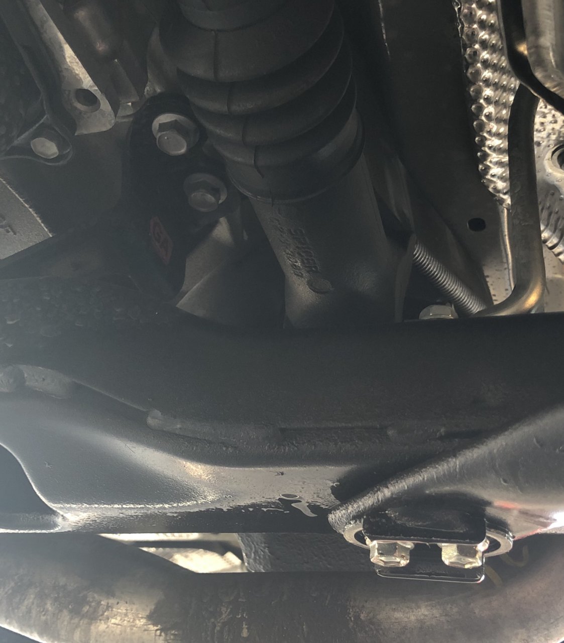

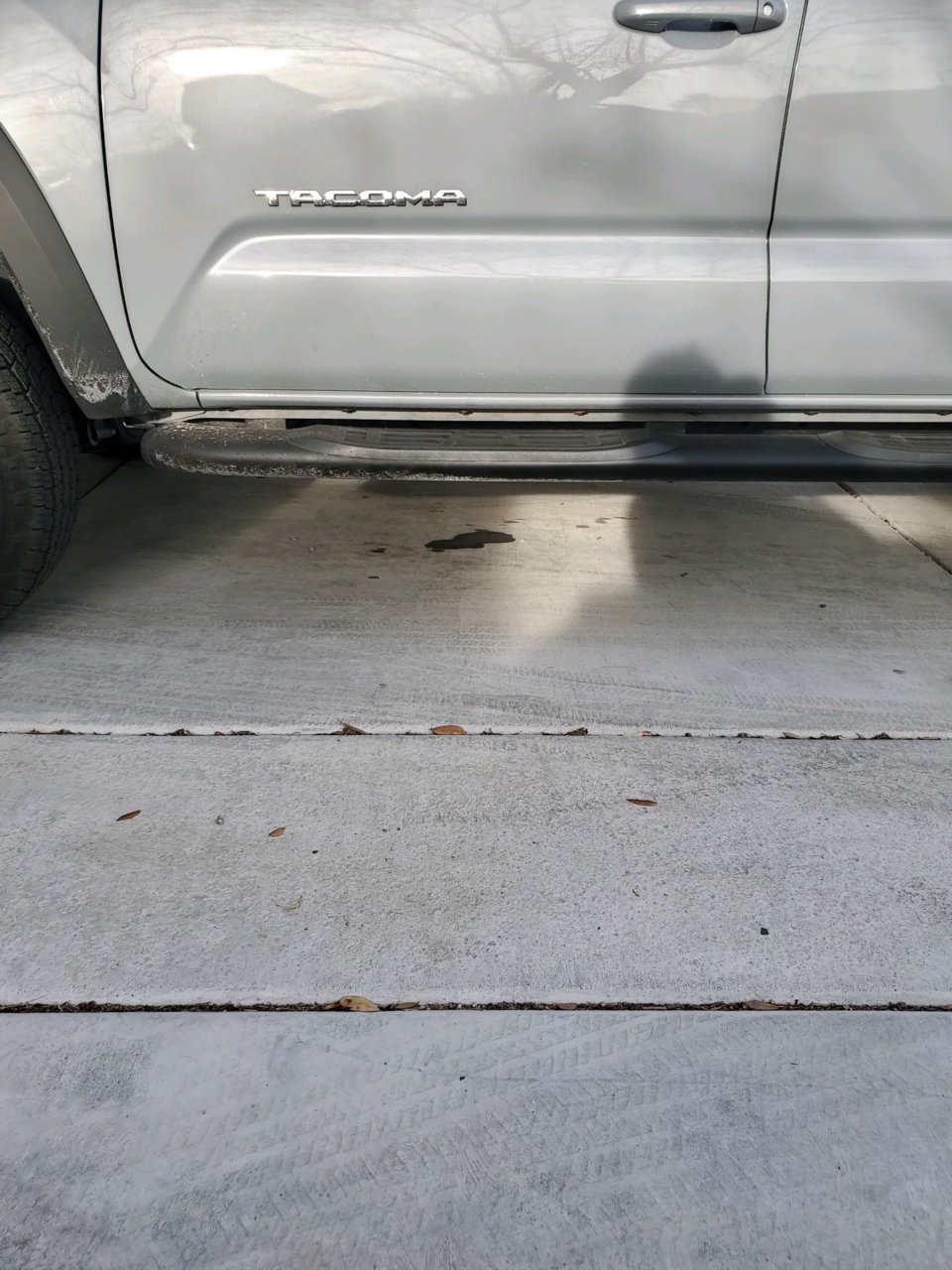

    My 2019 was leaking from the seal between transfer case and tranny. Seal was replaced by deale. Leak persisted and now a new transmission is getting installed. I’ve got 5600 miles on it.
