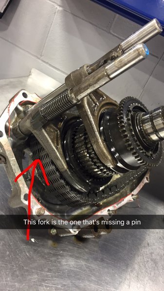

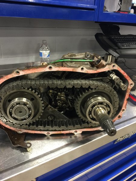

    Yep, got it apart and fixed. When I drained the oil from it a roll pin dropped out into my drain pan, at that point I knew exactly what the problem was. Just as I expected, once I got it apart I could see the 4 high shift fork not pinned to the shaft anymore. Just sliding back and forth on it. Spread that roll pin apart, the. Punched it back into its spot and I have 4wd again. Now I have another question though, as this transfer case did this before the whole 4wd problem. When shifting from 2h to 4h while moving it doesn't go, just grinds violently. When I had the auto I. This truck I could shift into 4wd at any speed but it seems with his one I can't even tho my little sun visor label says with a manual trans you can shift into 4h while moving
