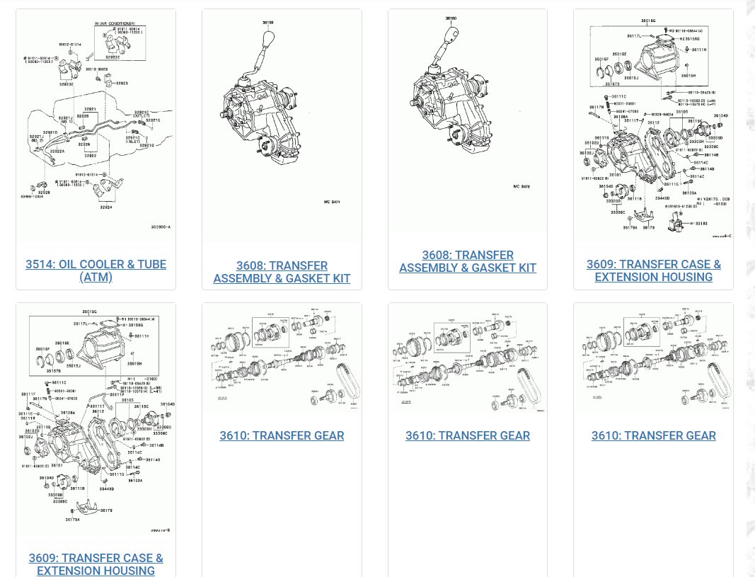

    Yep, A/T. I will absolutely include a list of parts. I have found that partsouq.com has been resource to bookmark when drilling down to components. Start off with the VIN from the vehicle and it's cake from there. I've also used them to order parts as well. Shipped from Dubai so transit time has to be taken into account. Still, I have to give them a thumbs up for making it happen. First order I placed took about 10 days (which is about the same as McGeorge for me). Placed another order on 5/30 and it arrived today. One of the bearings was showing as a 7-10 lead time so I was prepared to wait. Amazing it showed up today.
    Just plug in your VIN and head over to the powertrain section. You'll want the transfer case and then transfer gear assemblies. If you mouse over them and pause it'll throw a tooltip with info on 2-4 selector, ADD, etc. Why there are multiple choices of the same sections.

    Not sure but I know if I ever have to replace the one I installed, I'm going to do a hard look at the late model FJ Cruiser / 4Runner cases. They had/have manual J-shift cases and from everything I have looked at, it certainly seems like the exact same design. This is based on ripping into the part diagrams on partsouq and the part numbers are the same.
