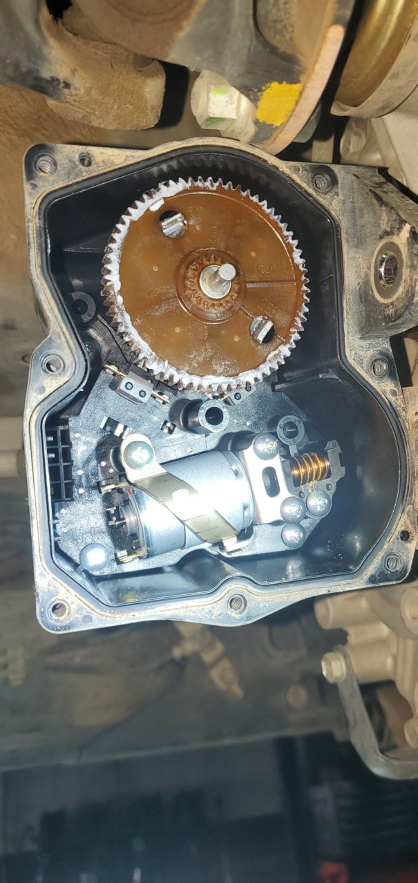

    E0101849-BF22-4239-9093-B626E0D5087A.jpg I believe this is the timing for large gear on parts out of the box which should be installed in 2WD.
