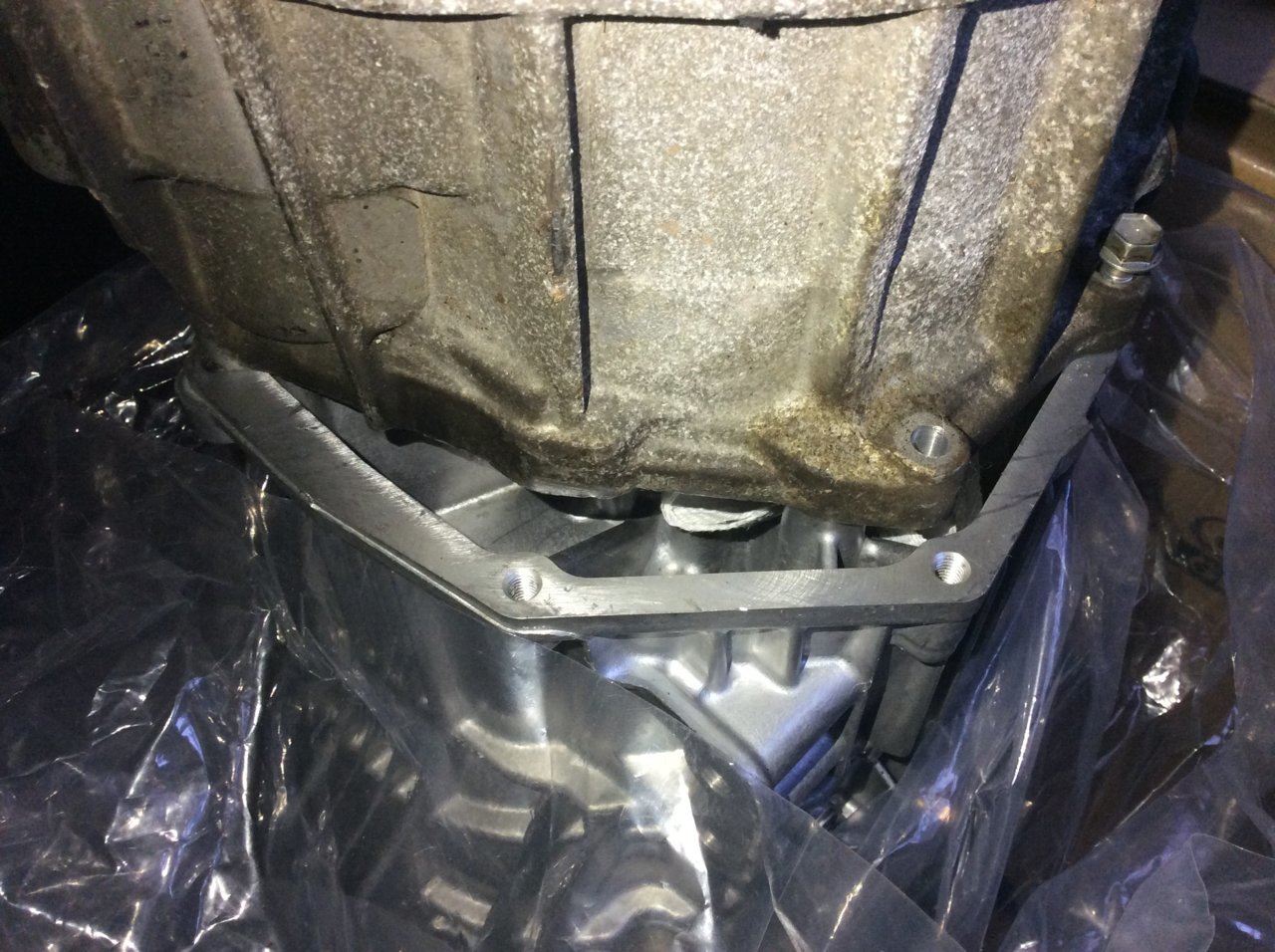

    Moving along here. Now that I have an RC60F transmission in the barn https://www.tacomaworld.com/threads/hilux-rc60f-transmission-swap.629019/ it was simple to inspect how close the older VF3 transfer case is to bolting up to it. Turns out that it will fit right up, including both aligning dowels... unfortunately, three of the bolts are not even close to aligning, as the case is a completely different shape in this area of the mounting flange. IMO, this is not a large hurdle to overcome... more on this later.

    Nice to see the in-process pictures of trial and error. Too many times you see one of a kind swaps that weren't documented well (if at all) and it makes people believe stuff like this is trivial when it definitely is not.

    Edited above. FJ Cruiser input shaft is the wrong piece.

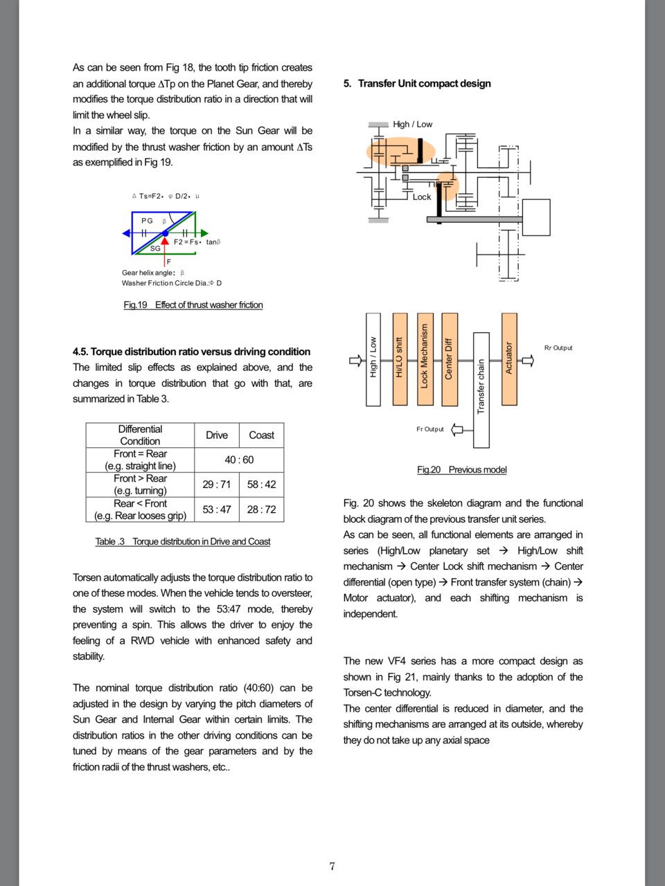

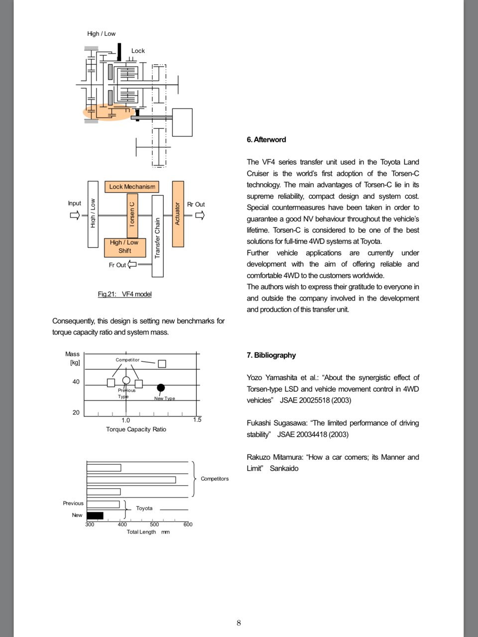

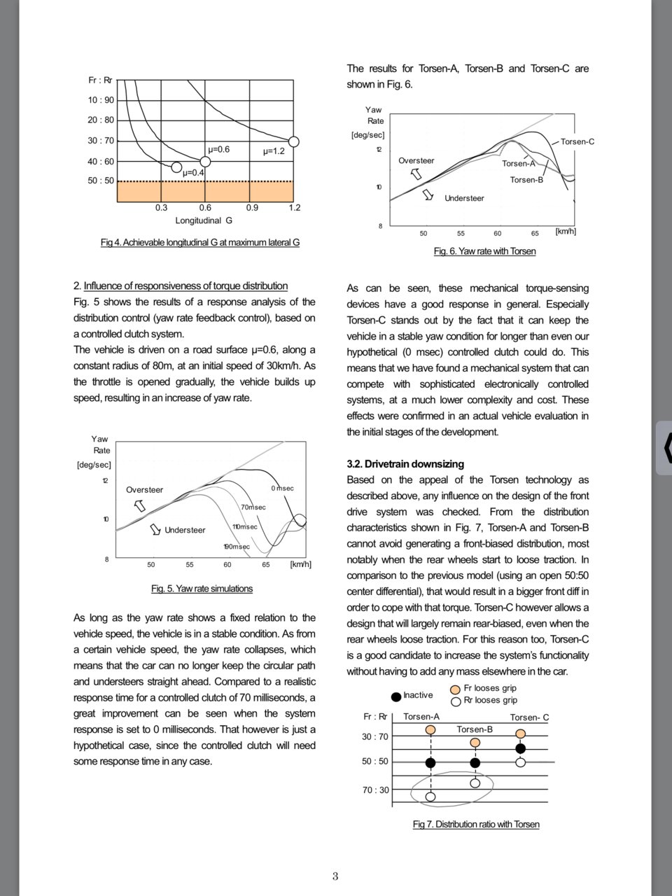

    With the Hilux transmission swap progressing, it's time to get moving on the transfer case again. The 2005 - 2007 Sequoia VM4xx transfer case looks to be the best way forward. The Torsen T3 center differential is the way to go when compared to the planetary center of the older case shown above. It should also have the same mounting pattern, not 2/3rds like the older unit. It comes as a completely electric shift only case... but I suspect various pieces of the VM series can be mixed and matched to produce anything from partial to full shift lever control via twin sticks. The input shaft should also be sorted out shortly.

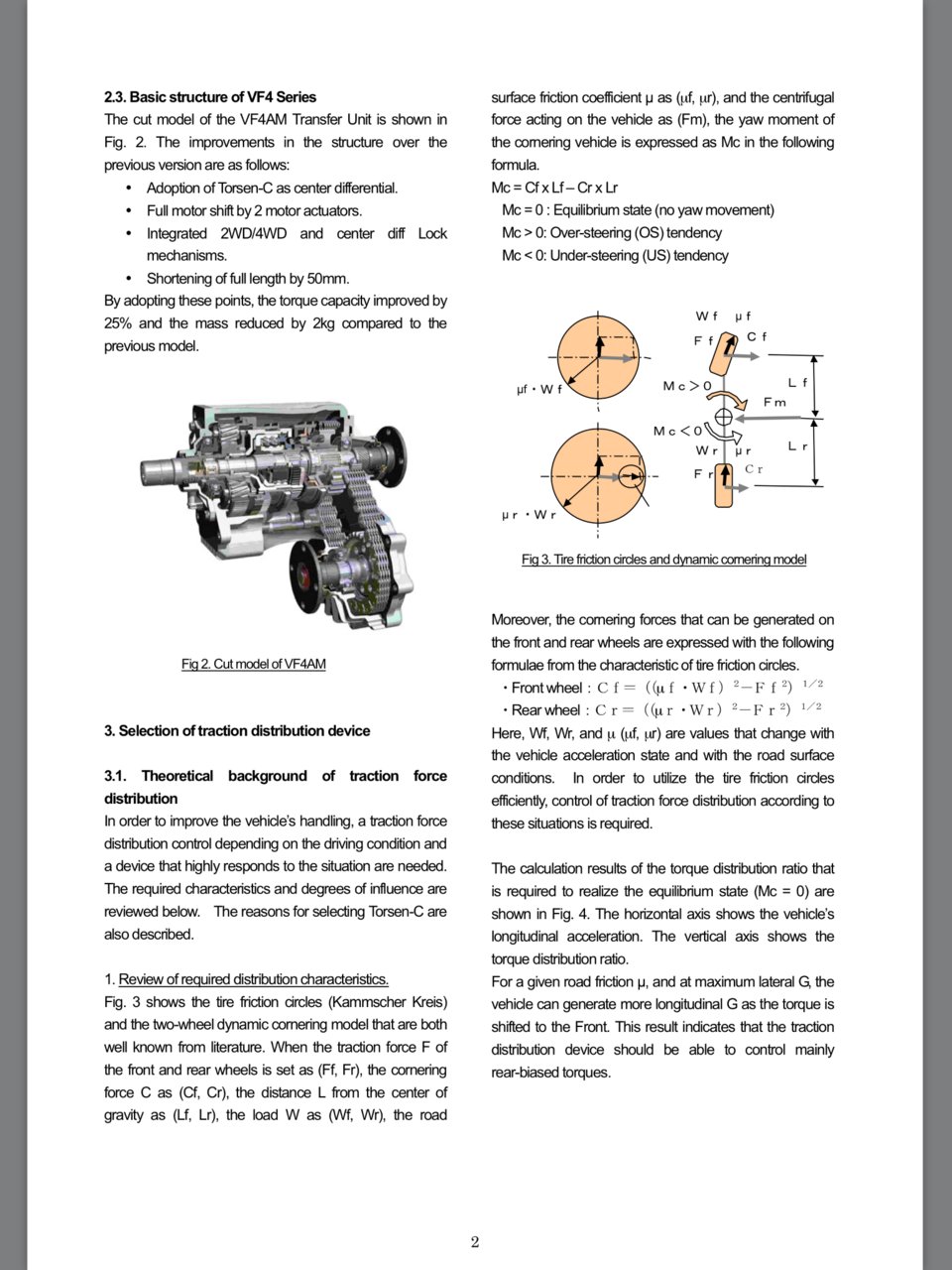

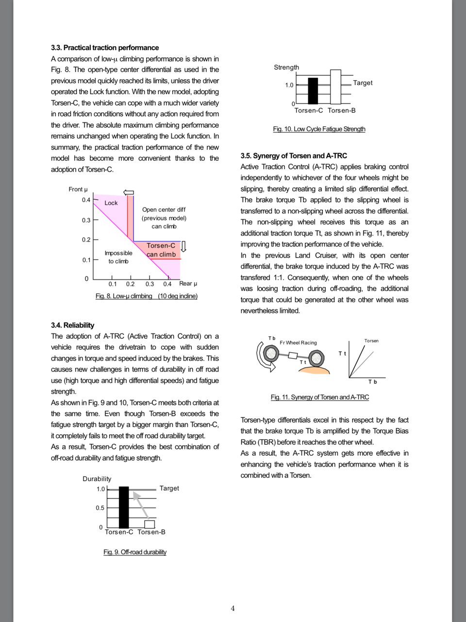

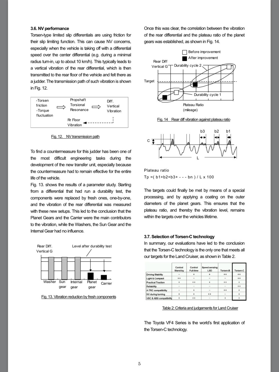

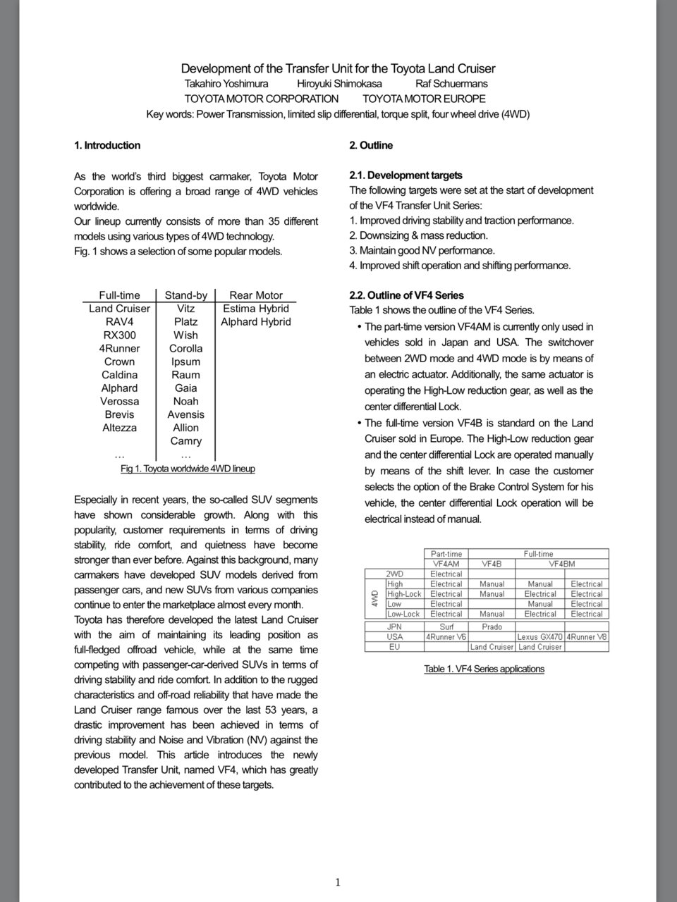

    Here's the Toyota tech paper on the development of the full time VM4....

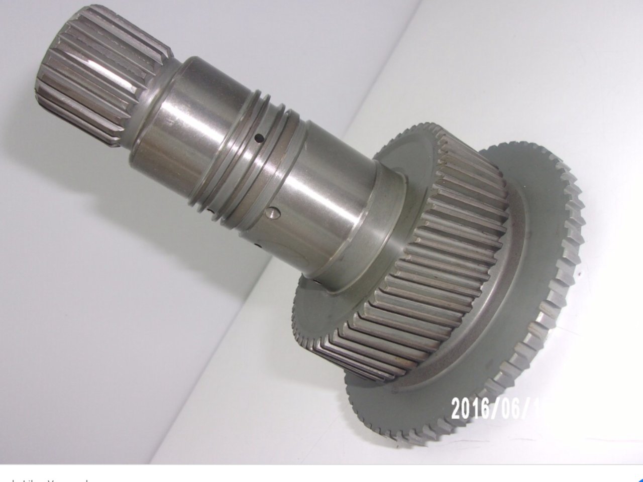

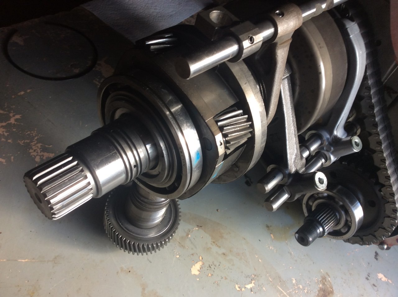

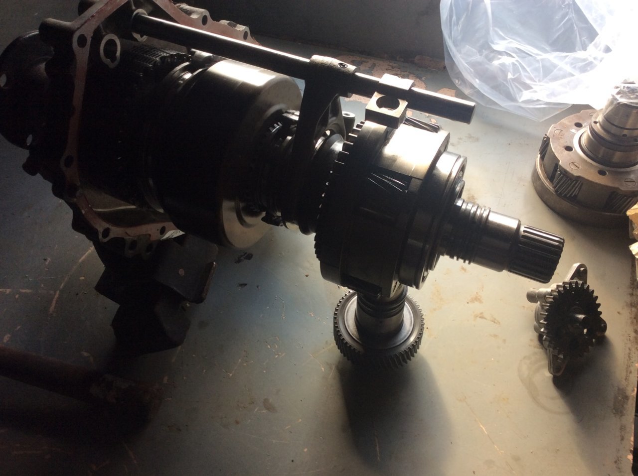

    The 22 spline Tacoma transfer case input shaft from the RA60F manual transmission vehicle swaps into the VF3AM Multimode Case (again, this is the earlier case with planetary center diff). There is a small difference with the back of the input shaft, but at this point I don't see any major consequence of using it. It could be addressed, but given the difference in bolt pattern shown in post #32, and the fact that the VF4AM looks like a much better swap, it is probably best to leave any further development of swapping the VF3AM for future projects. Here is the input swapped into the VF3AM... a real shame not be using this unit, the thing is pretty close to immaculate inside.
    Moving on, I have what is believed to be the proper input shaft for the VF4AM that will allow it to be utilized behind the RA manual transmission series. As soon as it arrives, I'll verify and hopefully update with good news.
