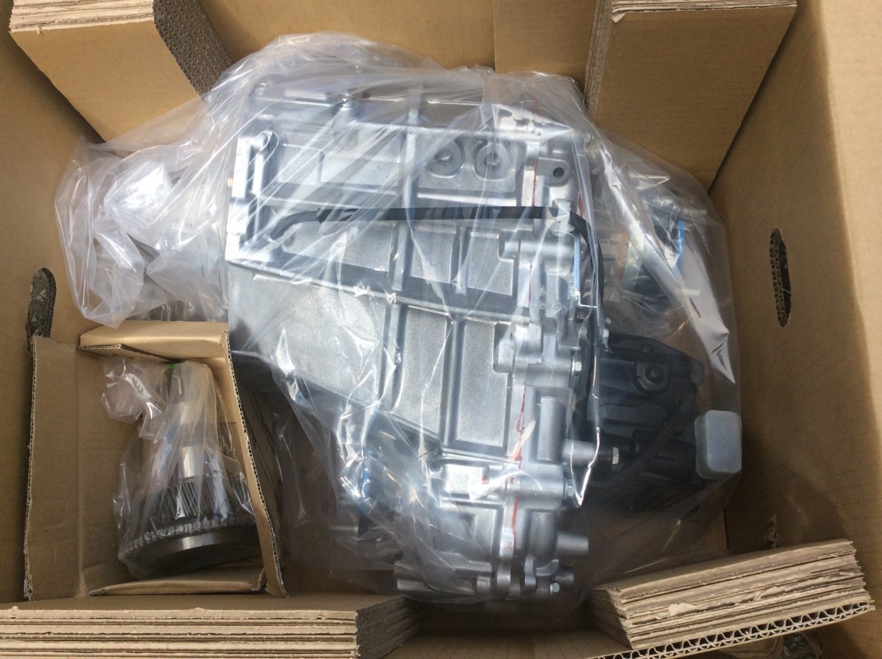

    Here is the transfer case and new transfer input shaft part # 36201-60050. I may scrap the electronic shift for the 2WD/AWD/4WD and go for full manual shift and locking hubs up front. I already have 99% of the manual hubs and CV joints figured out, and they are not the smaller weaker units from a gen 1... 30 spline all the way.

    Maybe I missed it, but what vehicle is the transfer case out of? 4Runner?
    Also, I would think that manual hubs would defeat the purpose of having AWD mode, since you'd have to stop and lock them to use AWD. Unless you just leave them locked all the time, and then what's the point.

    This unit is from the 03 - 09 V6 4-Runner.
    The vehicle will run in AWD most of the time with hubs locked. Occasionally they will be unlocked.... The hubs will allow true 2WD with the ability to completely eliminate rotation of all or part of the front drive. The benefits are many... running in 2WD has slight efficiency gains, and eliminates wear on front end components. If I smoke an axle, pulling the axle is not only easier, but being able to continue on with having to reinstall, while not super probable, is a possibility. Smoke the front diff? 2WD in the t-case and unlock hubs, continue on. Planning for the worst makes dealing with it far easier. Locking hubs look great.
