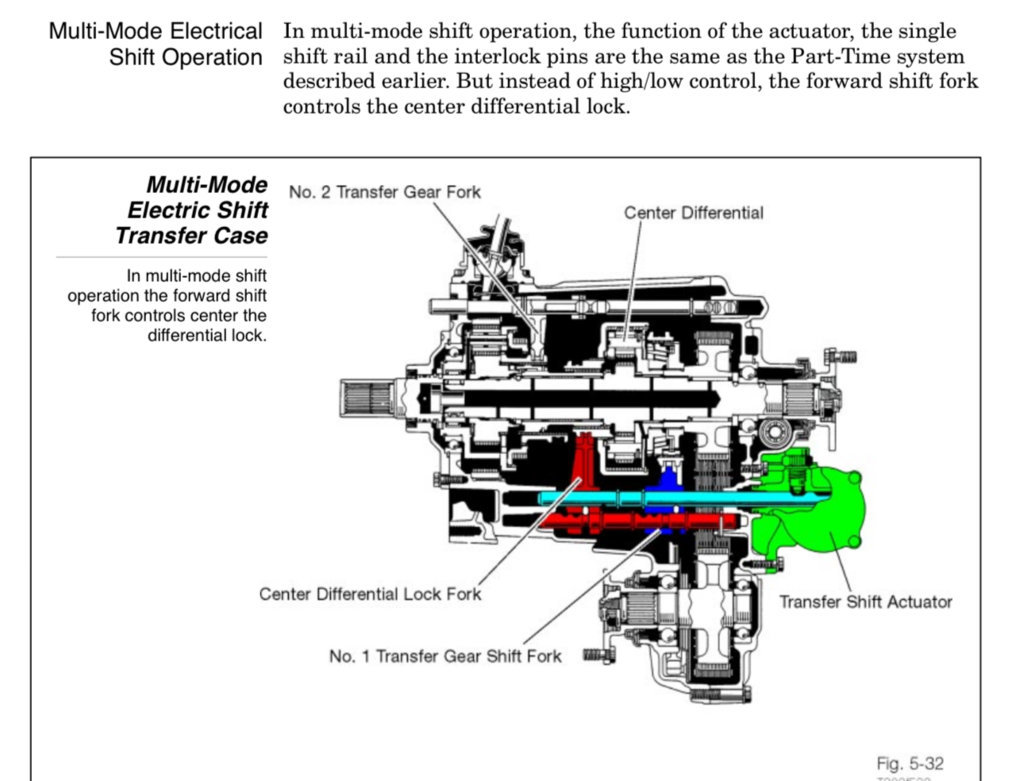

    From what I read in the FSM there are only two shift rails in the VF4AM so the locking isn’t a separate motor to control. There are limit switches for the diff lock but it’s for controlling one of the shift rails through three positions
    I forget which rail has three positions, but one of them does. So it’s either the 2/4 shift rail that has three positions for 2locked, 4 locked, 4 unlocked, or it’s the H/L shift rail that that has three positions for Hi unlocked, Hi locked, and Low locked.
    Either way, the center diff locking is integrated with the shifting so I think you’ll need to use one of the 4wd ecus that can control that shift logic. I think that would need to be either the Sequoia or v6 4R 4wd ecus and then feed them the appropriate control button signals. Sequoia uses three push buttons (diff lock, 2/4, H/L) where the 4Runner uses a rotary knob for 2H/4H/4L and a button for diff lock.

    the hi/lo rail of the full time case controls the center differential lock
