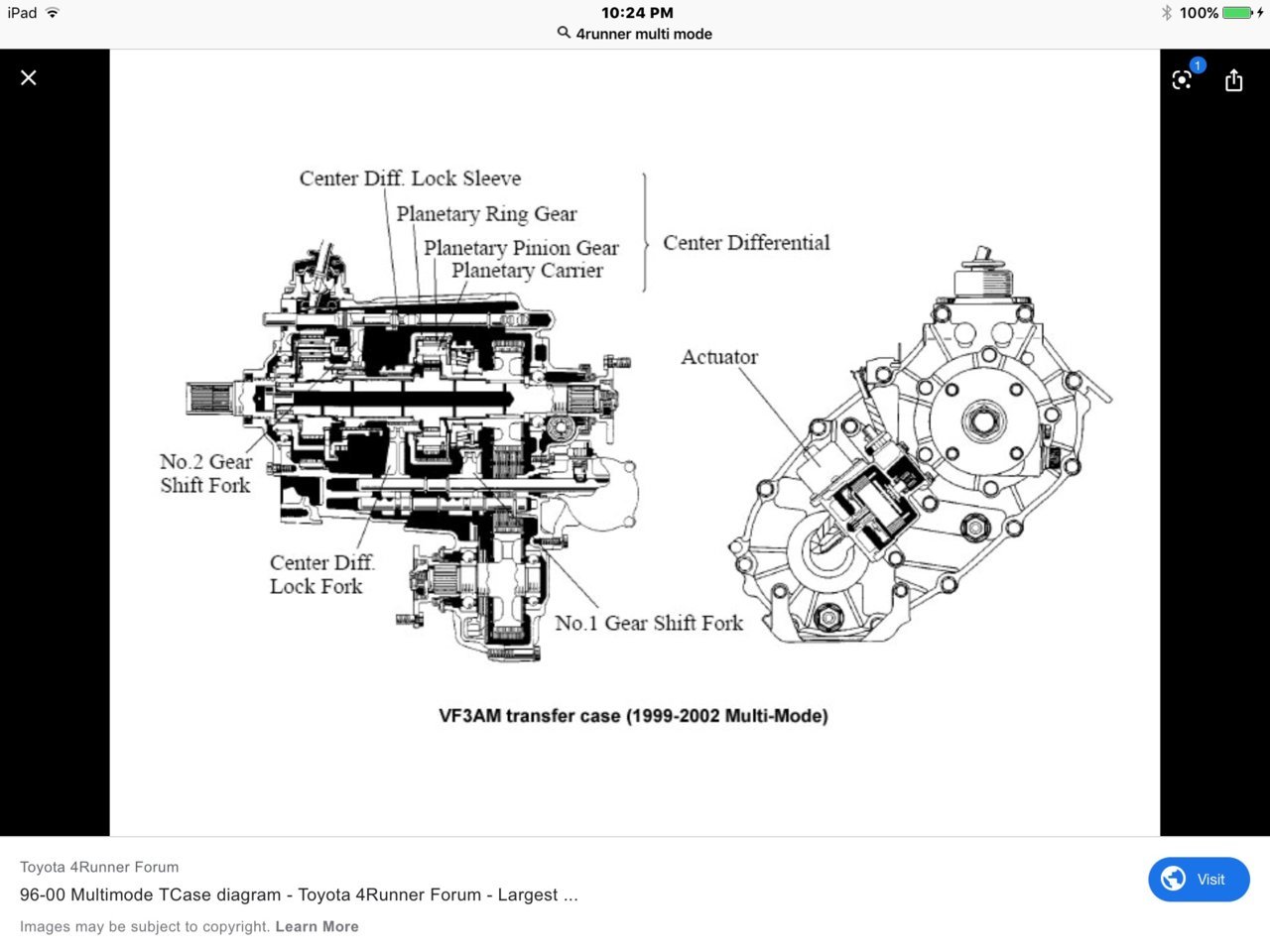

    My research into swapping an AWD transfer case has been ongoing for a couple of weeks now. Lots of thank yous to those that have done various swaps over the years, and supplied the information! So... The choice has been made, and unless someone introduces some info that will outright show/prevent the swap as being unviable, the Multi-mode VF3AM version is the one. It has 2WD, AWD, 4WD, neutral, and low range. Given that the unit has both an electronic actuator and manual shift stick for the various operations, it should integrate and play very nicely with the stock electronics in the Tacoma... Still interested? Read on....
    The stock transfer case is a good ole' VF2A that has complete electronic control over the shifting. The VF3AM, as mentioned above, uses electronic and manual actuation, and the split of these functions into their respective actions couldn't be more perfect for swapping into the Taco. The VF2A uses the electronicactuator to shift from 2WD to 4WD on the first phase, and the second obviously switches down into the low range. The VF3AM uses the same actuator to shift from 2WD to AWD, and the second phase locks the center diff for true 4x4. Both the actuators operate here in the same manner, on the same shaft, and supply the same signals to the ECU. So with the VF3AM installed into the Tacoma, the transfer case control dial will be shifting to AWD instead 4WD. The 4WD center diff lock shift will happen on the second dial turn, this would be low range on the VF2A. Pretty simple. The H-N-L shift is on the manual shift stick.
    The resulting available combos will make the truck much more useful and FUN. AWD low range for backing trailers up and around into precarious places, perfect! 2WD for mileage or fire road drifting? Easy. You get the idea.
    There are several relatively significant mechanicals mods that need to happen... those include swapping the input shaft for the manual transmission, possible driveshaft length changes, and some other odd things.... the results will be more than worth it.

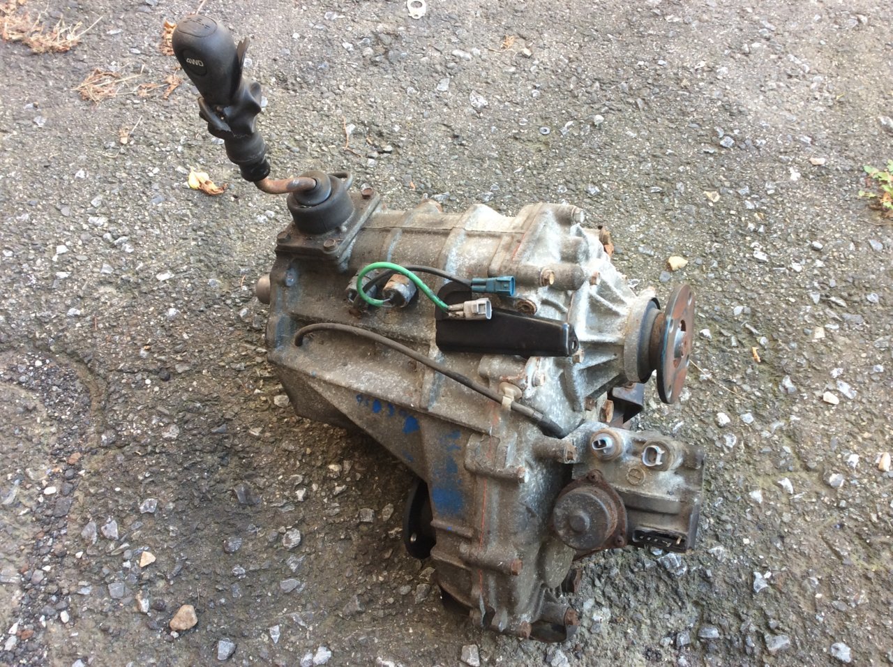

    Nice, any idea how much cutting may be required to fit the shifter yet?

    The t-case shifter will sit directly behind the the transmission shifter on the RC62F. That should make for a fairly simple rearward removal of the sheet metal in the tunnel. I suspect a double boot with surrounding plate from a 5 speed 95 - 04 generation truck or 4-Runner will work well here.

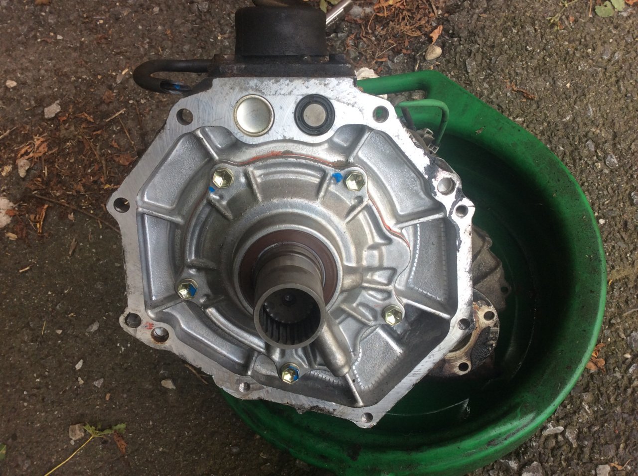

    Well that is not going to bolt up.... first hurdle encountered. Looks as though maybe 2/3rds of the bolt pattern would line up, maybe none? Toyota likey changed the case right after this model. Hmmmm, more research to do!

    Would the thickness of an adapter plate cause issues with input/output shaft length?

    Well, first I need to see if any of the case aligns, or check for a case in the next generation that can can be modified to accept manual control over H N L. An adapter plate will likely cause shaft length issues, so it will be last on the list.
