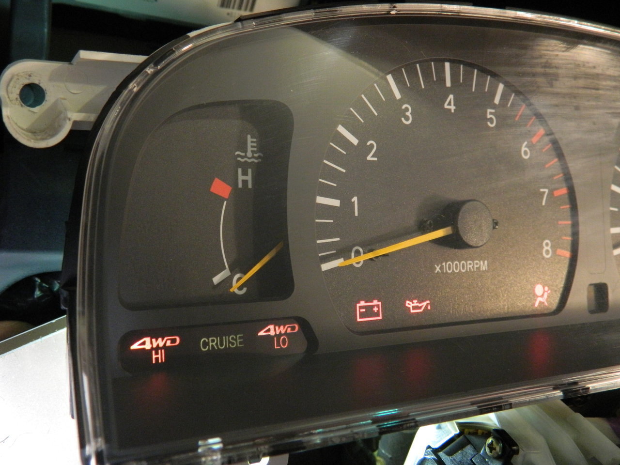

    Yep. People who usually do the 4x4 swaps don't even bother hooking up the transfer case sensors since it's completely unnecessary - there is no wiring harness or 4WD computer for them to hook up to on PreRunners. I actually used my transfer case sensors to light up custom 4HI, 4LO, and N lights I put in the instrument cluster. All they do is complete a ground, really.

    BartMaster1234, you grabbed an instrument cluster as well, then?
  16. May 30, 2018 at 2:40 PM
    #16
    BartMaster1234
    BartMaster1234 American Auto Horns
    Aug 21, 2016
    #195197
    45,641
    Tyler
    San Francisco, California
    Flux Capacitor
    No I used my original one. I custom made a lens in Photoshop and printed it out on several layers of plastic transparencies to replace the unused cluster lights. Tacomas have never had the ability to indicate on the cluster what mode of 4WD you're in, I did some custom wiring and fabrication to get this to work.
