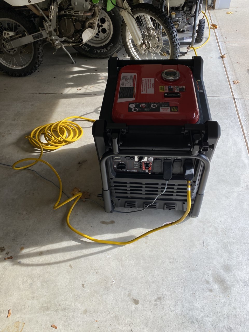

    I bought the 9500w predator generator and rewired into my main panel using an old welding outlet, total cost with the generator was around $1800. the complexity of the transfer switch isn’t needed especially if it sounds like you only want to run a few things.
    the benefit of it is that you won’t have to get out of bed in the middle of the night and fire up and connect your generator. Other than that I’d just shoot for the manual circuit. You can get a kit for your infeed panel that locks out the main breaker when the generator is connected so you it makes sure you aren’t back feeding once offsite power is restored.

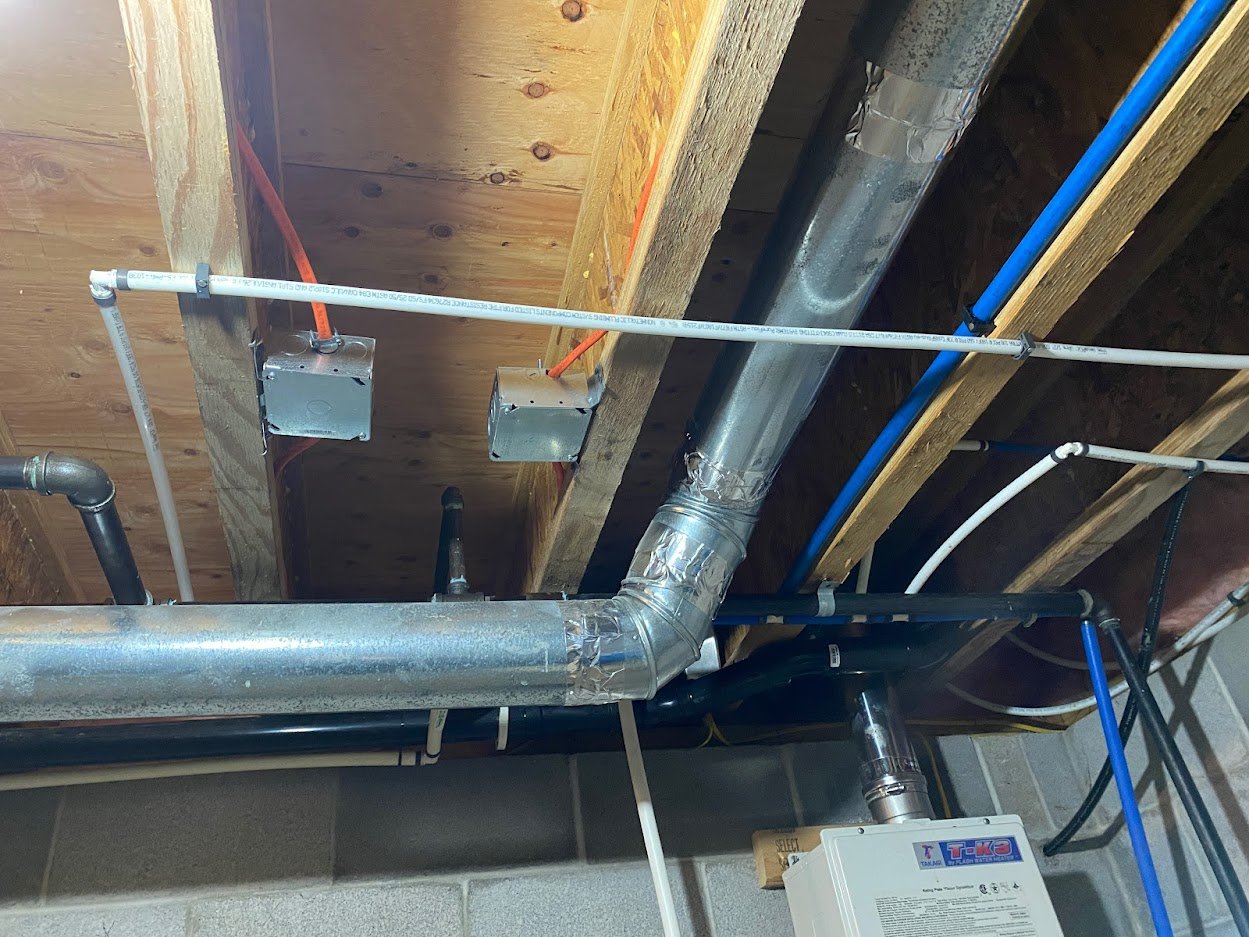

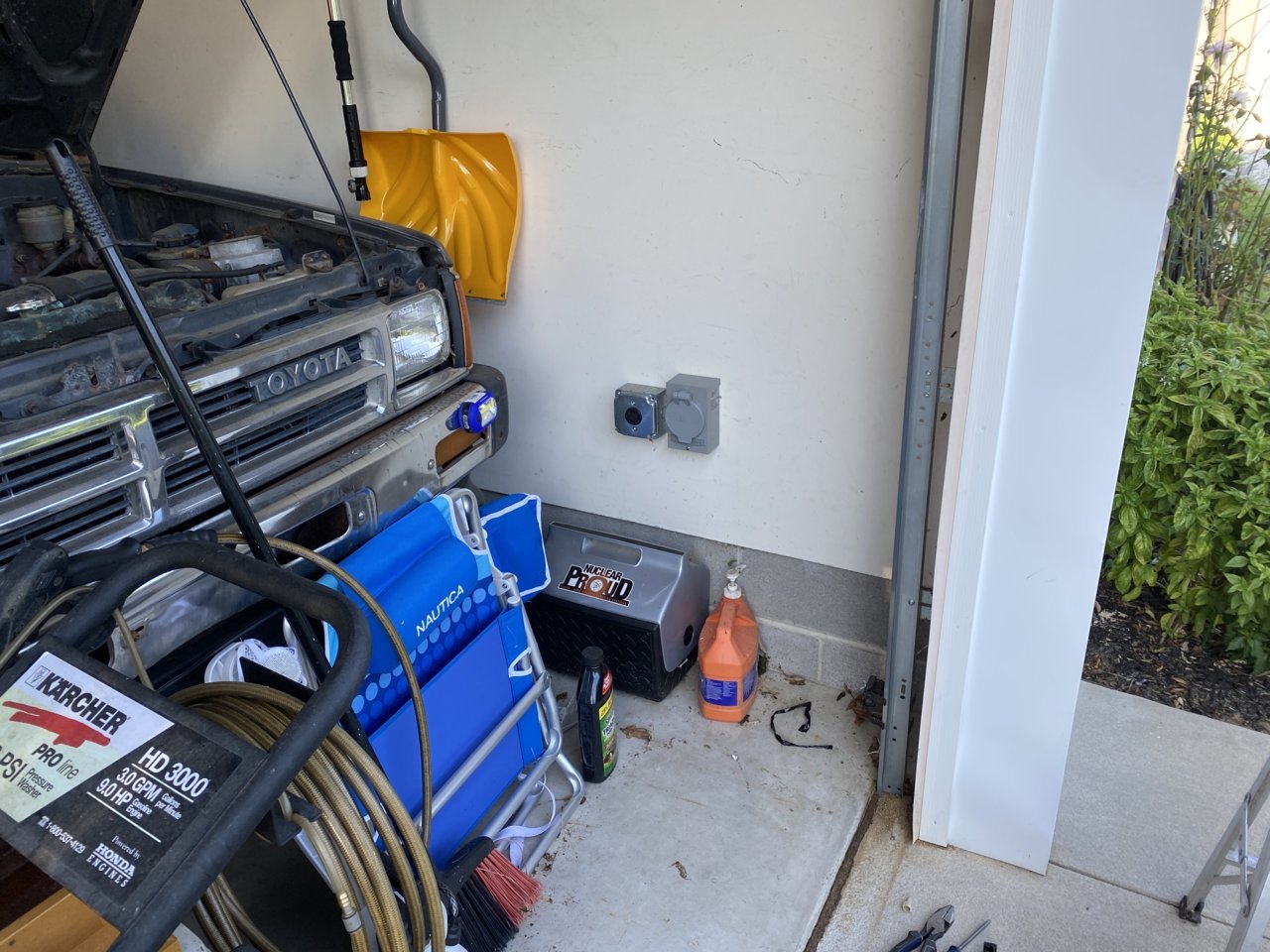

    FWIW here’s my setup. The welding outlet I rewired for a 30 amp generator inlet box
    I have a 50’ cord so I leave the generator in the garage and roll it out if/when needed

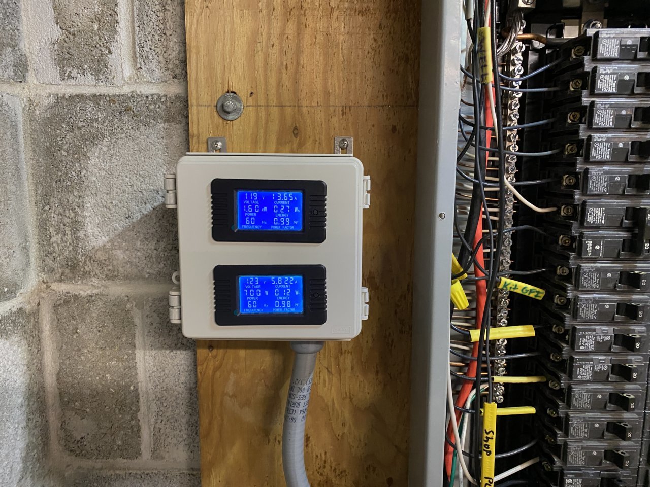

    I also made a box and wired up each 110 leg to monitor as I load up the panel. This generator will run the well pump and the rest of the house as normal with the fridge. It will do the AC as well. I put a hard start cap in the condenser last year. Just have to be careful no other 220V loads are starting simultaneously.

    That's exactly what I did. When I moved in my house about 6 years ago, I had an electric drier that I had since run a gas line to and put a new NG drier in. I repurposed that outlet to be a welding outlet in my garage (only about 10' away from the garage), so I cut the wire out from behind the wall upstairs, put in a junction box and ran some 10/2 wire to a welding outlet. The second outlet you saw in my pic was for an original 220V water heater which I had put in an on demand natural gas water heater (much more efficient) and had used for a 220V air compressor at one time (put in a L6-30R) as well, and kept that as a 220V "supply" in the garage. Since then I put up a dedicated building for a shop so I no longer needed either of these outlets and made the drier feed the generator inlet by installing a L14-30 generator inlet box.
    You can get all the supplies from
    https://www.geninterlock.com/
    Now in theory mine isn't "up to code" :anonymous: because I never relocated my feed breaker to the generator inlet to put in an interlock kit. To do so would have required shuffling around of some breakers in my panel which I felt wasn't necessary and I am "smart enough" to remember to open my main feed to my panel prior to closing the generator inlet breaker. This is any easy fix down the road if I ever want to sell the place and some inspector wants to bust my chops.

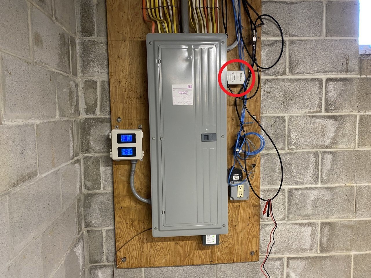

    I also put in a "powerback" in my panel (you can see the white box in the one picture, circled here in red), that monitors the inlet power prior to the breaker which you arm once the power goes out manually, it emits an audible sound to let you know the distrubution power is restored and you can shut your generator off.
    http://www.reliancecontrols.com/ProductDetail.aspx?THP108
    So yes, the process would be:
    Step 1: Crap my TV and lights went out
    Step 2: Go set up generator and cord, fire it all up
    Step 3: Go downstairs and strip the panel feed breakers
    Step 4: Open the main panel infeed
    Step 5: Arm the "powerback" device
    Step 6: Close the generator "inlet" to the panel
    Step 7: Close in indivdual panel feed breakers (in my case, I close them all in as my generator is large enough to handle all the loads)
    Step 8: "powerback" device screeches to tell you the distrubution power is restored
    Step 9: Turn off "powerback" device
    Step 10: Strip panel feed breakers
    Step 11: Open Generator inlet breaker
    Step 12: Close main panel infeed
    Step 13: Restore panel feed breakers
    I realize this may be more work than some people like to do, but it isn't really that hard if you know what you're doing. Of course, I've spent the last 15 years in the power industry producing and distributing power so this kind of stuff comes second nature to me. A panel and an ATS will do all this for you automatically, and there are plenty of types of equipment in between that is "semi automated", but you'll still need to worry of course about what kind of generator you want to use (propane, NG, gas, dual fuel, diesel, etc.). For me, the gas generator was a no brainer, I always have at least 10 gallons of gas on hand for my lawn equipment and the tank holds another 6 gallons or so. My other option was a NG generator such as a generac but the price tag for one of them added another decimal point to the cost so the choice was simple for me. Plus the HF generator can be transported and used anywhere if say a neighbor or family member needs it.
    If you aren't comfortable with the wiring, I'm sure an electrician can do what I did here for a fraction of the cost of one of the dedicated panels. The cost of wiring these days has since gone up exponentially when I did my panel, so I can't imagine what they charge if you need alot of new wiring. Again there are many options, cost ranges from cheap to uber expensive and the convenience factor of total "hands off" power restoration to total manual restoration, depending on what you're comfortable with.
    It sounds like alot of work but in reality only takes about 5 minutes, here's a video of me restoring my whole house as a demonstration I did when I put in the watthour meters to monitor the generator loading.
