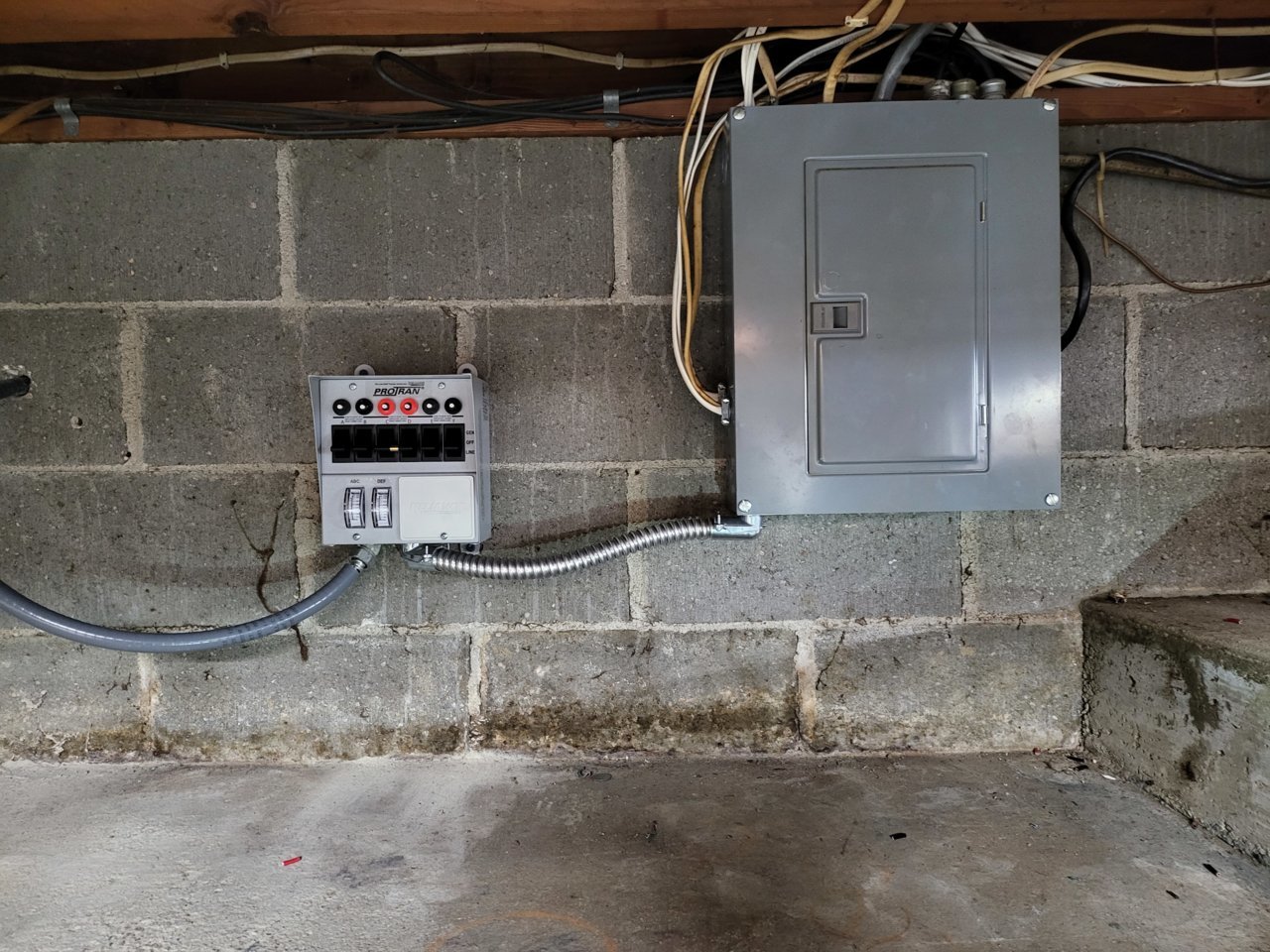

    As FYI, menards sells a transfer switch kit that works good for 300. Just need to buy some wire and conduit to run from outside switch to the transfer switch. I installed mine a month ago and happy so far. I've cleaned up my install since this Pic, but you get the idea. Two load meters so you know what you're pulling.

    This is very similar to what I used to have. Never really liked it.
    2 years ago I had an electrician install a new circuit box for the whole house. It has a built in transfer switch. I can now run whatever I want just by flipping a circuit.

    I agree a whole home switch is better. For the money though it's a good option. Plus it allowed me to install instead of paying someone.

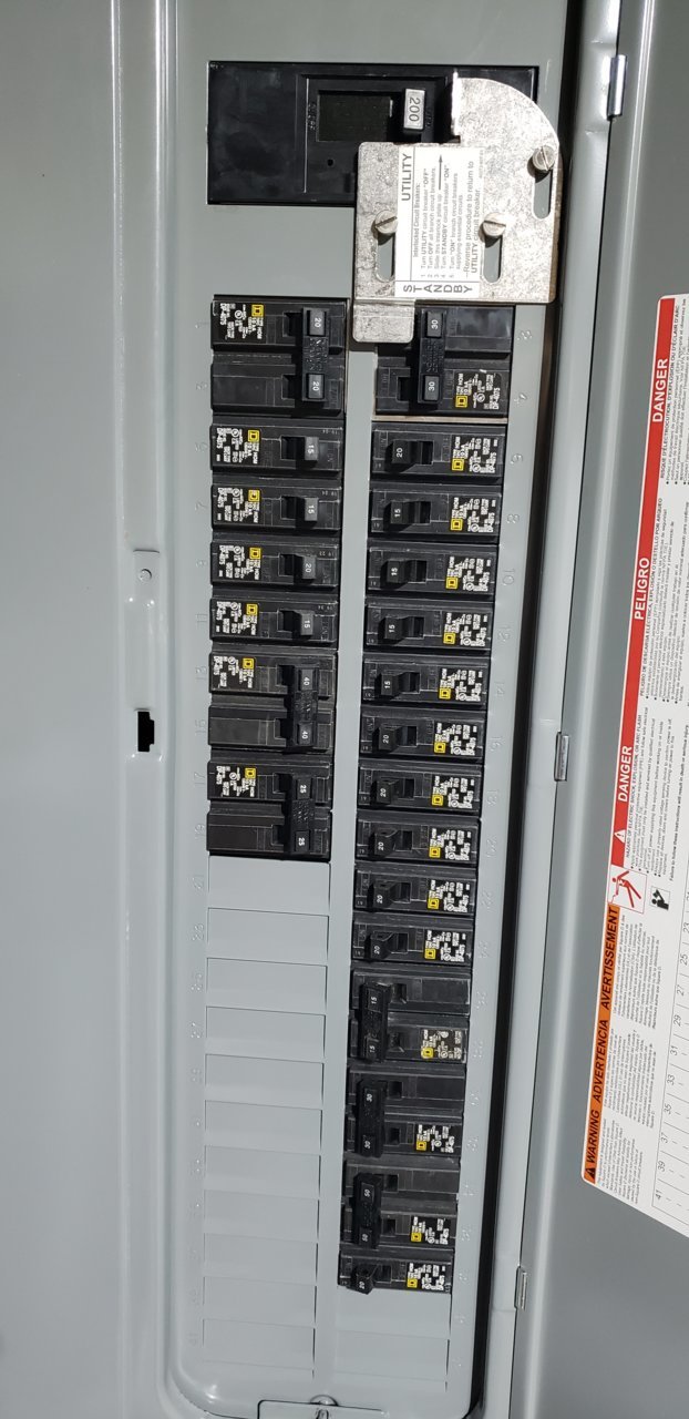

    I'm fascinated. Didn't know this was a thing. Thank you!! Going to research Square D panels now. 200 amp service I take it right?

    I have the same switch. Was going to get a Reliance Controls switch box but my electrician referred me this switch instead. Have not had a chance to use it yet tho.
    Generator Interlock Kit Compatible with Square D QO or Homeline 150 or 200 amp panels. 1 3/8 inches Spacing between main and generator breaker, Professional and Interlock Kit https://www.amazon.com/dp/B0917KYWPJ?_encoding=UTF8
