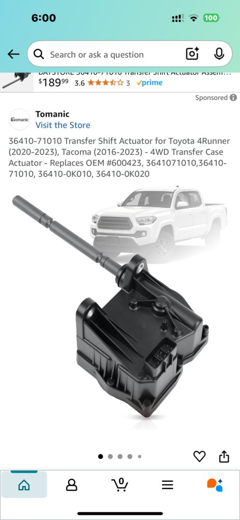

    Would yall trust an Amazon part like
    This?
    Thanks

    I personally wouldn't use any of these cheap products sold on Amazon. Id prefer OEM parts purchased from a reliable source. You're already reducing costs by not paying labor so might as well buy OEM components.

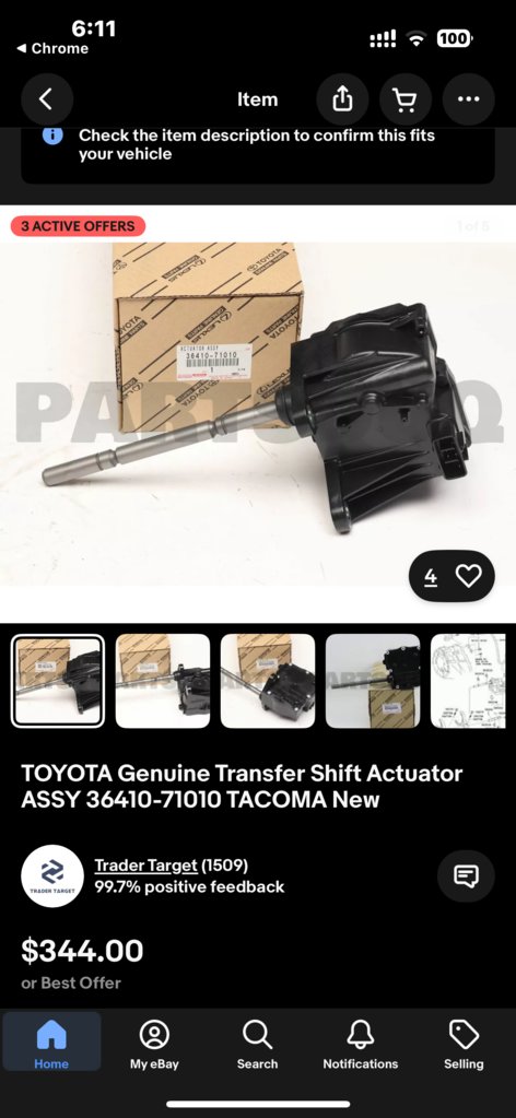

    fair point.
    this is a good price. Think it’s really OEM ?

    For all you know that cheaper Amazon actuator could be the exact same unit the Toyota parts counter is selling. The risk to find out is all on you!

    Msrp is like 1100 , I’m finding it for 750 and up from the Toyota dealer .

    Dude I buy parts on Amazon all the time. My rule of thumb is: Is the part massively cheaper? Red alert, do not want.
    I also will click on the other sellers tab sometimes and order stuff that is coming from a dealership parts dept that sell on amazon.

    They're under $500 from Japan and UAE distributors. Goes to show you Toyota USA's profit margins.

    This is how I do it normally. I think swapping this is a labor intensive ordeal so I would stick with oem or aisin aftermarket on this part. Would suck to be stuck or stranded because 4x4 wouldn't work due to a junky Amazon part

    I got a transfer case out of a salvage pickup shipped to my house for 375. Comes with the actuator.
