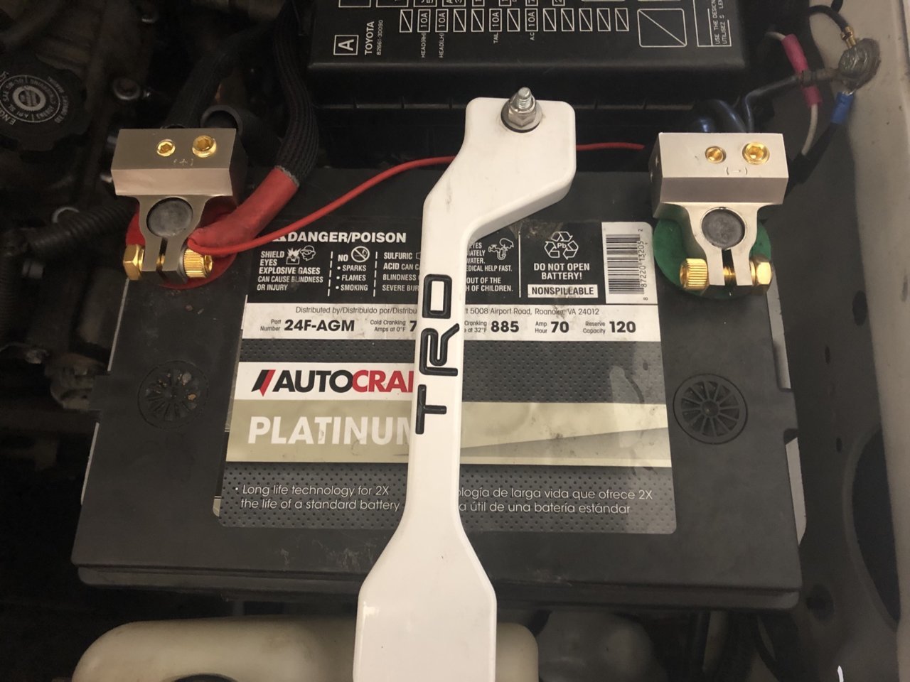

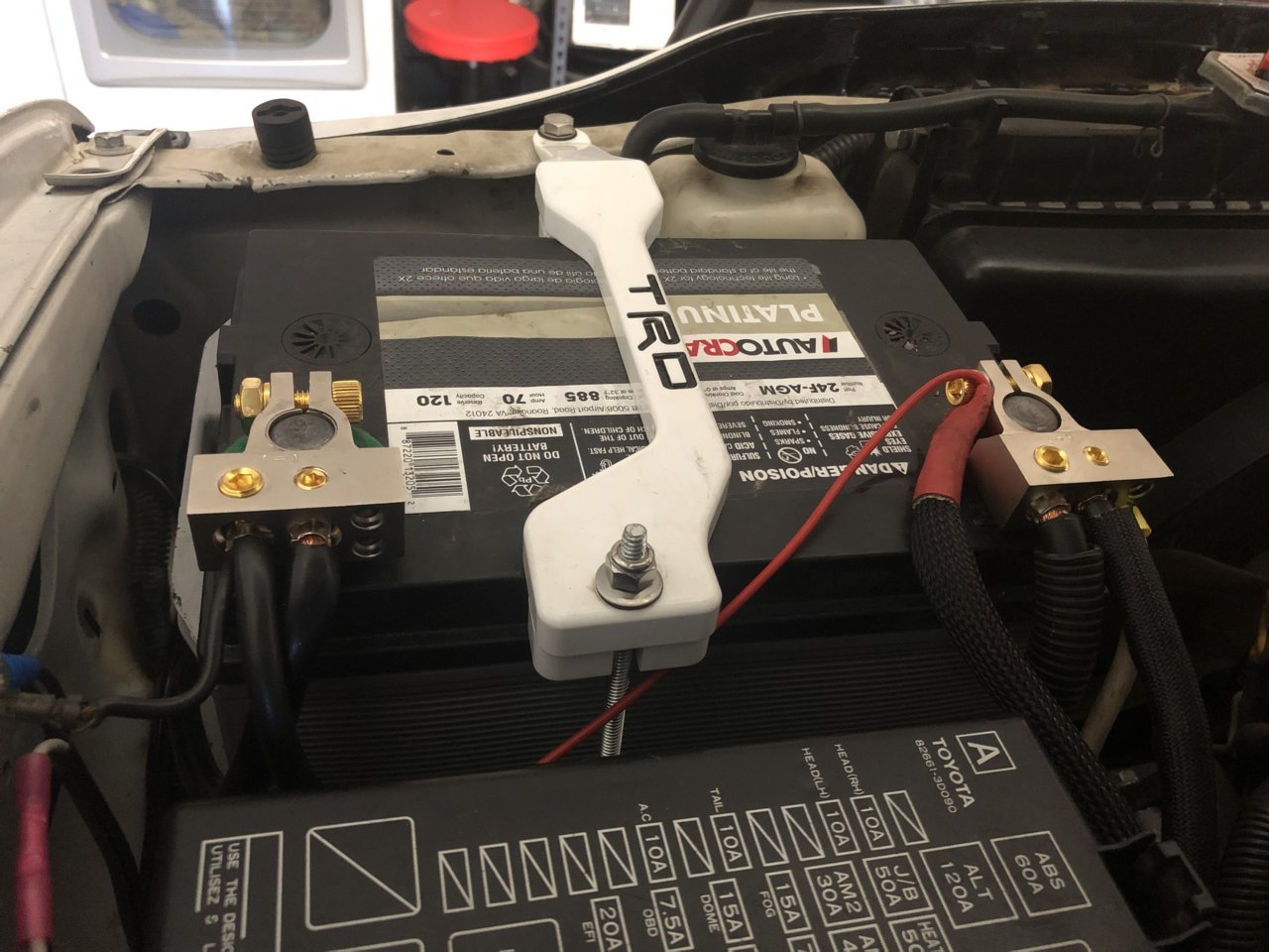

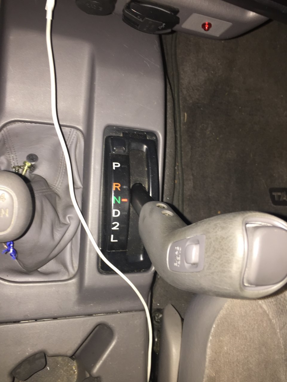

    To get the truck in neutral the truck must be started , move the position to neutral turn off the engine , Make sure to set the parking break and unplug the negative battery terminal. Having the truck in neutral will make it easier to reinstall the valve body later .

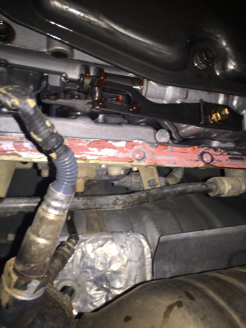

    Shift linkage picture of shift in neutral

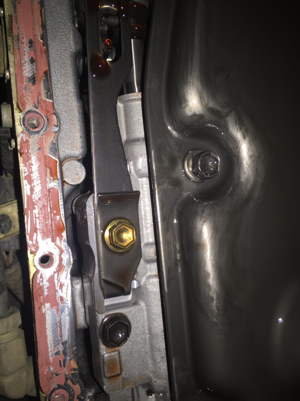

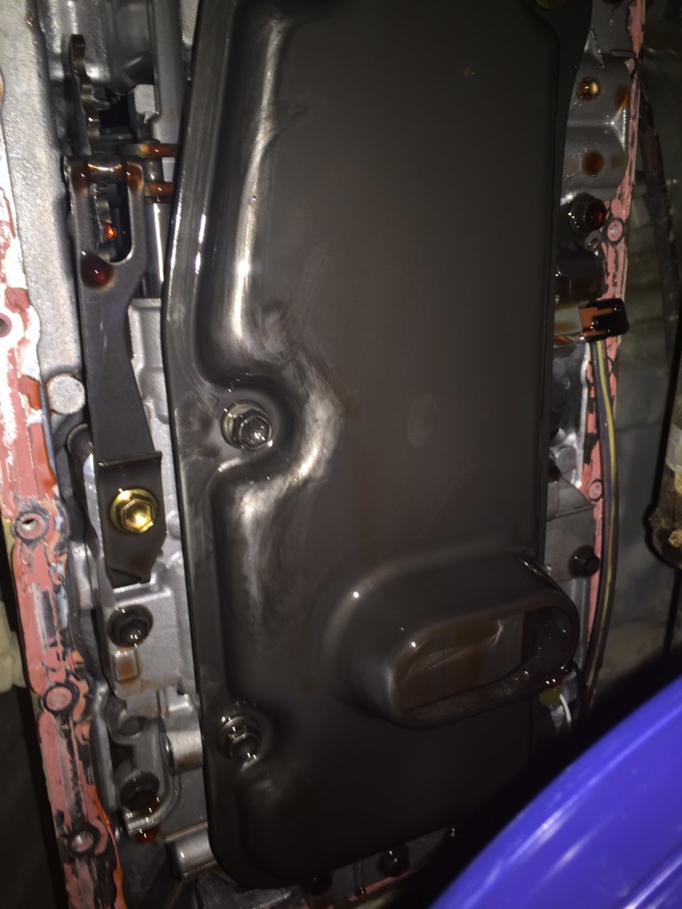

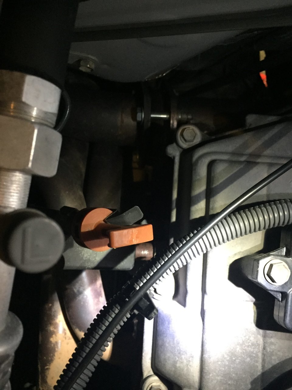

    Remove Transmission filter
    Next

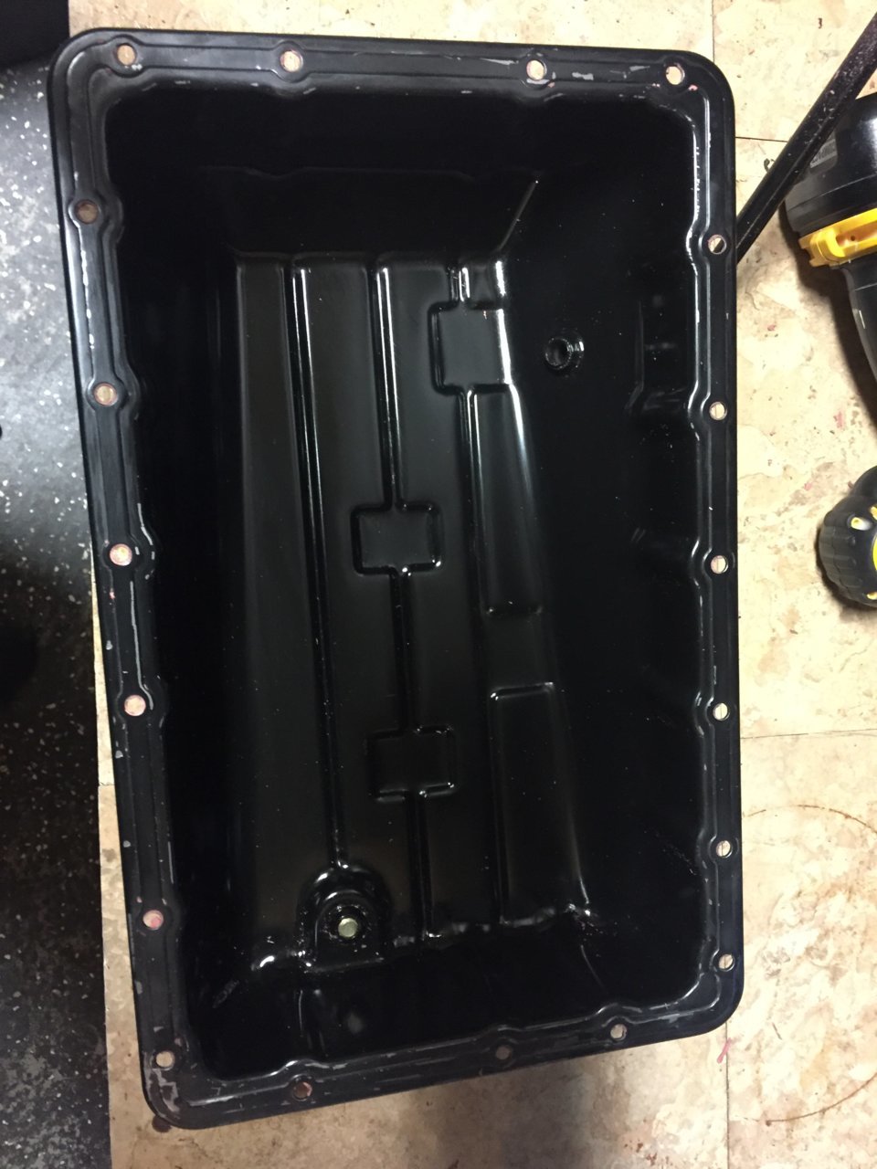

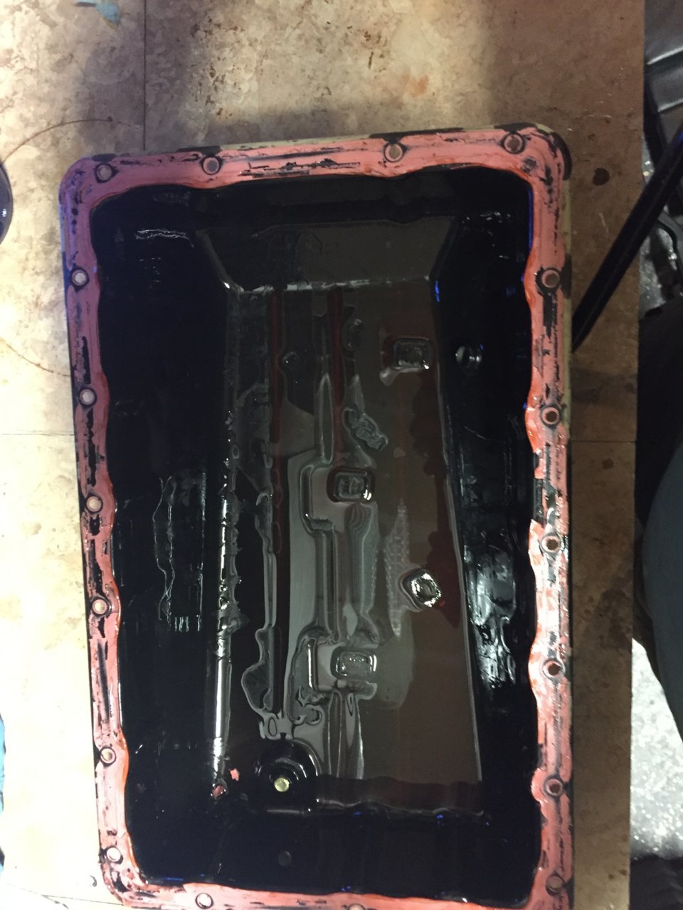

    Clean off transmission pan

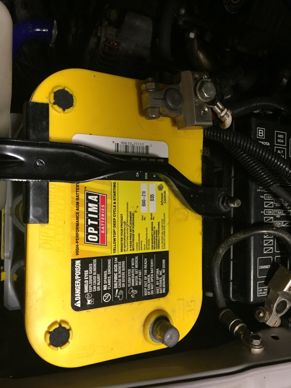

    looks like the same ones I have.
    InstallGear 2/4/8/10 Gauge AWG Positive & Negative Battery Terminal Clamp and Shims (Pair) https://www.amazon.com/dp/B00NQ7U982/ref=cm_sw_r_cp_api_i_d23IDbKN7EXQN
