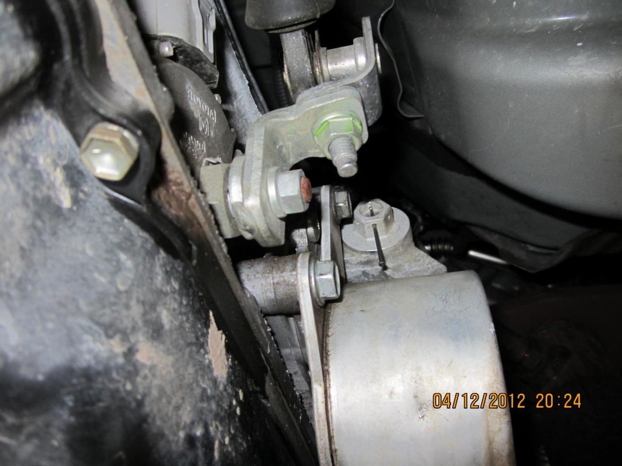

    CanyonRunner
    CanyonRunner 100% PENETRATION
    Dec 3, 2015
    #171316
    215
    Pacific Northwest
    2016 TRD 4X4 DCSB
    $$$ Money Pit $$$
    Just for visual reference in this thread since it has been asked many times.
    Here is a pic of it on the tundra which should be about the same on tacoma (shown pinned) Press in then insert a pin to hold

    Heepspo
    Heepspo I wouldn't say I'm missin' it, Bob...
    Feb 27, 2010
    #32195
    968
    Jason
    Washington State
    2016 TRD OR DCSB, Prem & Tech w/JBL, Towing
    Fuel Vector D600 17" Wheels, Toyo 285/70-17 AT2 Tires, Tuff Country 52907 3" Leveling Lift, Full Katzkin Leather (Black with Platinum Stitching), SOS Concepts Streamline Front Bumper, 3M Scotchgard PPF, "no vtec 4me" BHLM, Husky X-act Contour Floor Liners, Cali Raised Faux Pro Grille, Predator Sliders, WeatherTech Mudflaps, UnderCover Ultra Flex Tonneau Cover, OEM Bed Mat, Headlight Revolution Supernova V.4 Headlights/High Beams & Carbide Canbus 2.0 Amber LED Front Turn Signal Bulbs, Salex Console Organizer, Rhino Seat Belt Extenders (removes annoying dinging), 15% Window Tint, JDM ASTAR 800 Reverse Lights, LED Interior Lighting Package, Stant Locking Gas Cap, Redline Tuning QuickLIFT PLUS Hood Struts, Gentex Compass Mirror w/Homelink, mesojdm Ultimate Turn Signals, Hondo Garage Un-Holey Dash Mount and AR15 Bolt Radio Knobs, CBoy808 Custom Bedside Decals and Flags, De-Badged Doors, Tailgate and Interior Visor Stickers.
    So there's a button you depress, then you slide a nail/pin whatever to keep the cooler open as you check the ATF?
