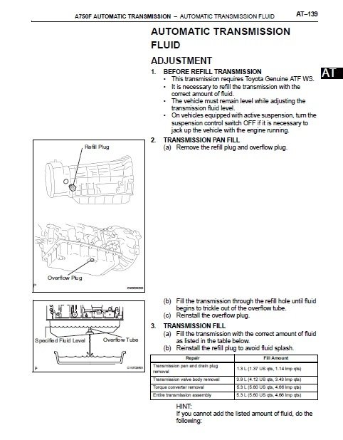

    Could someone tell me (better yet a picture) of where my trans fill plug is? I have 2009 V6, 4x4 access cab. I have just over 30k miles & would like to check mine. Thanks

    It's up on the pass. side of the tranny....it says "WS" on it...!! I think it's a 24mm socket required..

    splitbolt, Thanks, I have read all the posts I can find on this topic and still cannot find the refill, the photo in the second link is of an "06" 2wheel drive, mine is an "09" 4x4 and the fill plug is not in that position, I do appreciate you taking the time! Thanks!

    Splitbolt, Thanks again, your drawing lead me right to it, I really appreciate you taking the time to do this!!!

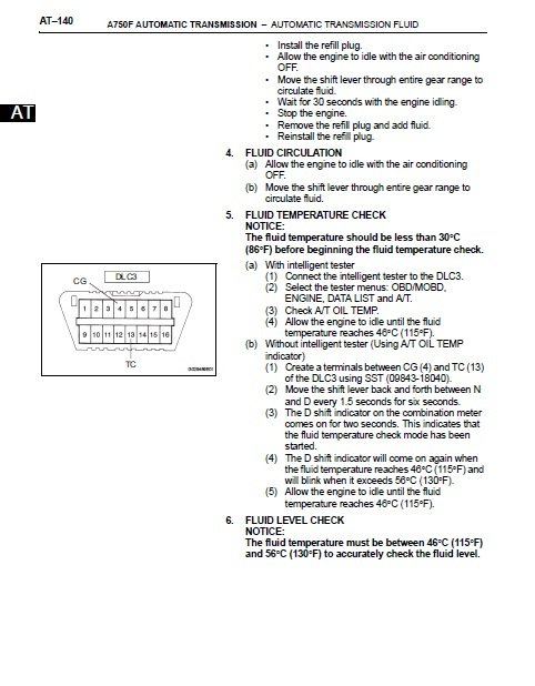

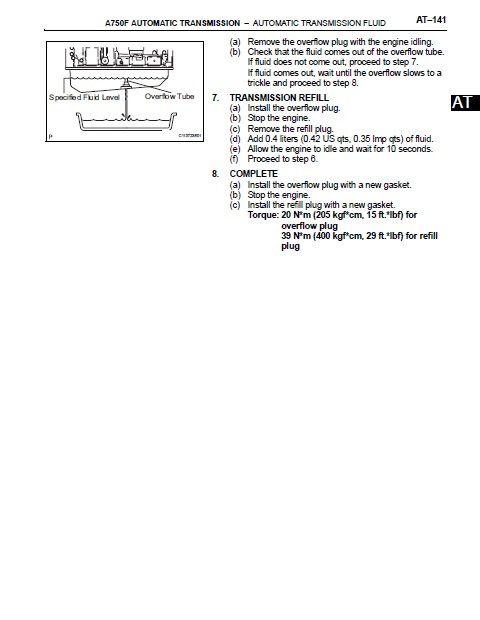

    Hi Mike .
    From what I gather and other members on TW have done , All you need to do is push the thermostat in once while the engine is running .
    Doing this will fill the air cooler with oil and eliminate any possibility of an air lock . Your air cooler doesnt hold much fluid at all , maybe 1/4 quart .
    The only reason you need to do this is because we believe the complete transmission cooling system was " NOT " filled at the factory .
    If you have 5k in mileage , there is a darn good chance your transmission thermostat has opened within those miles
    Regardless , you can push the thermostat in anytime and check the fluid at a later date .
    I dont beleive the air cooler will drain on its own . Once the air cooler is filled , it will remain filled unless you are doing a complete transmission overhaul and need to flush out the complete transmission cooling system
    Check your fluid level with the engine running and make sure you have good flow coming out of the overflow tube . You need some flow . If you see a dribble of fluid coming out , its not enough fluid , you want some flow
    Some members are making a nasty mistake by not leaving the engine running when checking the fluid level
