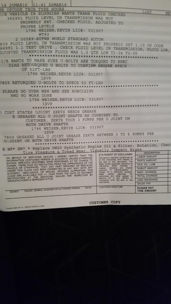

  20. Mar 26, 2016 at 5:02 PM
    #300
    sxe4533
    sxe4533 Well-Known Member
    Sep 12, 2015
    #164074
    594
    Edmond, OK
    2016 TRDORDCSBAT
    2015 TRD PRO suspension
    Got my transmission fluid, ubolts, ujoints checked level was low u bolts wherent torqued to specs and u joints where dry!
    Trd offroad dc sb 4x4 w/tow Vin starting with 5
    gearcruncher[OP] likes this.
