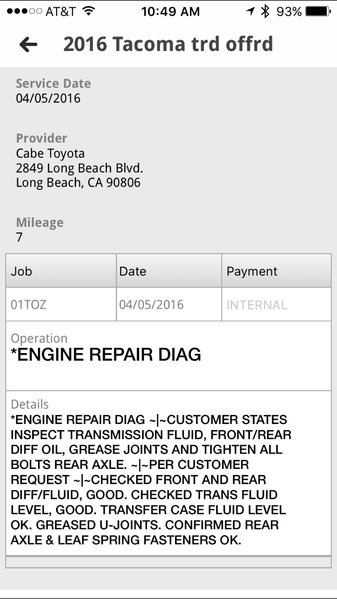

    Somehow. I don't trust them....they were doing the work while I was doing the paperwork on the car. The truck came with 1 mile, test drove it for about 2-3 miles. When I got it back after finishing the paperwork and the service, there were 7 miles on it. Took them about an hour to do the work I think. Time kinda flew by in the 4 hours I was at the dealership. Should I go get it checked somewhere else?
